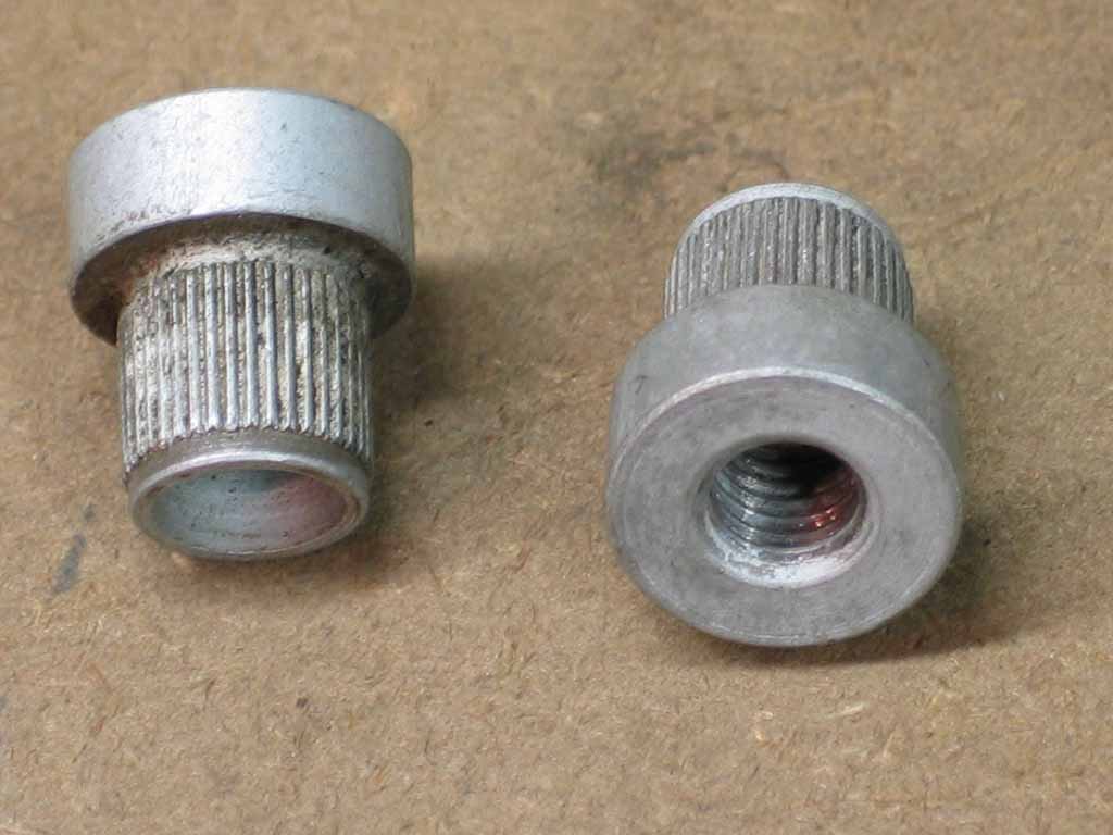

If you have a small port case then use the "green" seals.
The captive nut can be purchased and easily pressed in.

Can one discuss this operation or share a link about the smart way to install w/o making a mess?

stevo wrote:
To remove a captive nut:
Thread a bolt into it until the threads are flush. Use a drift to tap it out.
Installation, quick 'n' dirty:
Tap it back into the case with a hammer.
Or,
Installation, modest finesse:
Tap it back into the case with a hammer and a block of wood.
Or,
Thread a bolt into it until the threads are flush. Use a drift to tap it in.
Or,
Installation, less finesse:
Thread a bolt into it. Tap on the bolt instead of the insert. You'll mar the bolt while the insert stays pristine.
You could actually press the insert into the case using a bolt and washer if you're worried about breaking your case by hammering on it. You'll have to go seriously Neanderthal on it to break it but anything is possible.

Engine Case Nut Insert Captive Nut press-in nut
https://wolfgangint.com/case-components/2883-engine-case-nut-insert-111199102.html

stevo wrote:
The insert isn’t just simple press fit into the older pre 71 case. Need a reamer or step drill up to size and account for interference fit. I’ve done but can’t remember the sizes. Engine needs to be out of the car

As far as that insert goes, an easier to install option for an older case may be a Keensert. They use standard or metric drills and taps and can be installed without any special tools.

https://www.thesamba.com/vw/forum/viewtopic.php/viewtopic.php?t=454369
I ran a 14mm drill through the engine mounting hole and, with two washers flat-edged on the grinder to accommodate the lip on the gearbox side and an oversize nut as a spacer, the insert pulled into the case nice and smooth.
