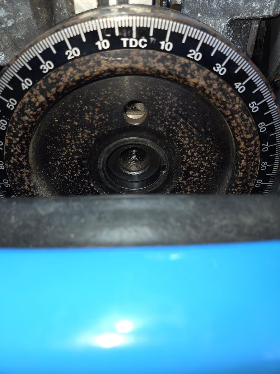

Trying to find top dead Center of my 1979 super beetle between these 2 marks (photo attached) and how’s the best way to time it?

check this out . i think the dimple is your TDC but you need to/should remove a valve cover n confirm it or you could be 180 off .

Dimple is TDC. 009 needs all in advance 3500 rpm or so at 30 degrees advance. So you need a degree wheel or elementary math skills or a timing light with advance capability's.

Dimple on the pulley rim at rear of VW is TDC. The notch is 5 degrees after TDC (5 ATDC) which is used ONLY if one has stock fuel injection (or stock carburetor on those equipped, from 1971 on) AND the original correct distributor.

Since you are using a uh oh 9 distributor neither of those marks will be useful. The TDC dimple is still useful for checking valve lash though. As above you time by verifying no more than 32 degrees of advance at full throttle. You will need to locate 32 degrees BTDC on your pulley and mark it with some bright paint and then use a timing light to verify.
Only if you're using a timing light from 1970.
Almost all modern timing light have a feature where you can "dial in" the advance. Meaning you set the timing light to 32* and it adjusts the light so you only use the TDC mark. The TDC mark is the dimple.

Perhaps, but still a good idea to have 32 degrees designated on your pulley. I’ve oft wondered why Wolfsburg didn’t place a notch at 32.
Because they specified 7.5* and put a notch there.
One can use this
https://www.thesamba.com/vw/archives/manuals/degree_wheel.php

Again, not needed, just set it at the timing light and use the TDC mark.
BTW, not all degree pulleys are correct.

And for those of you that don't understand. The key way at TDC should be at 9:00 not 3:00. Someone had a Monday moment.
Original factory distributors' centrifugal advance weights and springs were calibrated such that if the idle timing was set correctly, the total advance would also automatically fall within the specified 28° - 32° BTDC range at 3,800+ rpm -- no additional timing marks were needed.
But 50+ years later, w/ all the various non-stock/custom "mix-and-match" carburetor and distributor combos, putting timing marks on the pulley (appropriate for your own specific setup) is a good idea IMO.

Correction here... the TDC mark on the crank pulley indicates that the #1 cylinder is at the top of it stroke... it does NOT indicate when the the #1 cylinder is at the end of the compression stroke. This is a common misunderstanding and misleading.
    It is very similar to stating...
    "A traditional analog clock (above) will tell you when it is Noon or midnight." This is incorrect, it tells you neither. Twice a day an analog clock will tell you when it is 12-o'clock. The clock and its hands cannot tell you if it is Noon or midnight. You need additional information like whether the Sun is in the sky or the stars are out.
The TDC mark will line up with the case split when the #1 piston is at the end of the compression stroke AND at the end of the exhaust stroke. It does the same for the #3 piston which is at the top of its stroke at the same time as piston #1. You cannot tell which stroke it is at the end of from the crank pulley markings alone. You need additional information like whether the #1 valves are closed or in motion to determine if the cylinder is at the end of the compression stroke (valves closed) or at the end of the exhaust stroke (exhaust valve closing, intake valve opening).
The crank pulley cannot be "180 off" (except in the rare case of Glenn's pic where it appears someone applied a stick on degree ring onto the crank pulley in the wrong orientation! Shocked ). It is the distributor/rotor which is often 180 off from where it would normally be because someone incorrectly installed the distributor drive gear or the distributor drive cog.
To the OP, just to avoid confusion, would you post the part# stamped into the side of your distributor. There were two different VW Beetle distributors with "009" at the end of the part# Please post the whole number here.
Also, confirm if you have a modern inductive strobe timing light w/ "advance" function that can be adjusted in degree increments. If you don't have one but are planning on buying a timing light to maintain your Beetle, consider getting one that comes with a Dwell feature as well. You really want to use a dwell meter when setting the point gap and most folks new to the hobby will not have one.
Do you also have a 12v incandescent test lamp? These are handy for static timing your distributor just to get the engine running.

i duno , i may not be the best explainer ..... but it works for me when i adjust my valves to remove the valve cover n confirm #1 is loose on the intake and exhaust valve adjustment . thats how i know its not noon or midnight but tdc ???
you cant just trust the line in the distributor .

my 180 comment was just trying to say when looking at the distributor it points at number 1 twice before a spark is emitted there . you need to confirm if it indeed is on 1 .
You are correct, you are not the "explainer" The pulley indicates TDC 2 times compared to the distributor pointing to #1 once.

your right , my bad - pulley vs rotor point but either way you need to confirm it before adjusting anything . ill step down .
you were so fast i couldnt correct myself fast enough but i know how it works .

The stock pulley with the dimple is either TDC on #1 or #3. You can use the mark on the distributor to confirm or....
Remove the driver's side valve cover. Put a 30mm wrench on the crank pulley, rotate the engine so the TDC mark is at the case seam. Now have someone rock the wrench back and forth as you loose at the rockers on #3. IF they are moving then you are at TDC on #1. If they are not, rotate the engine 360* and do it again.
100% fool proof.
