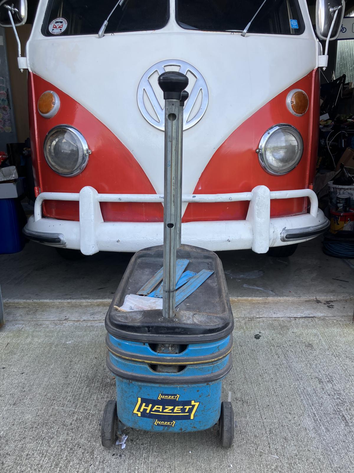

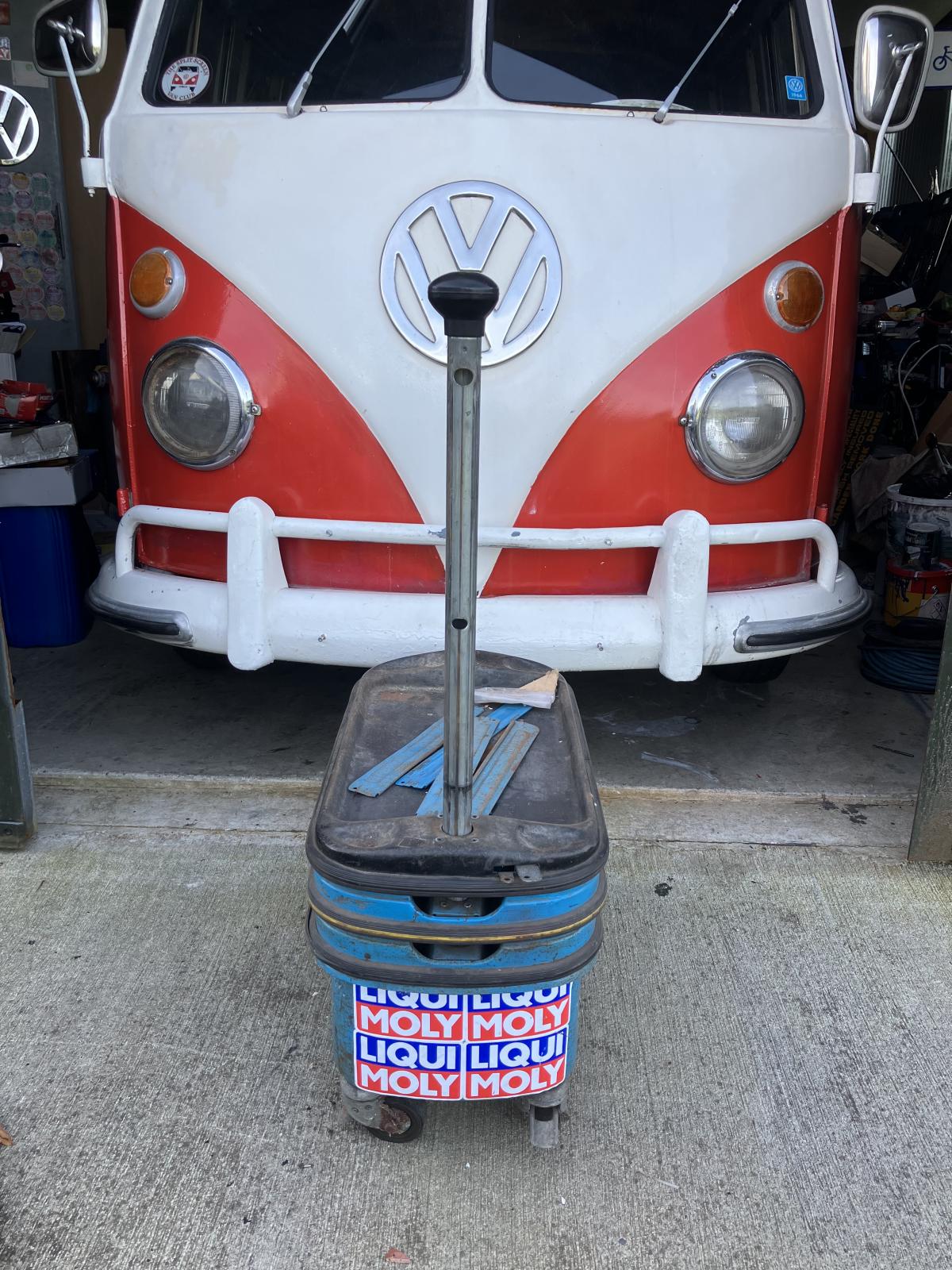

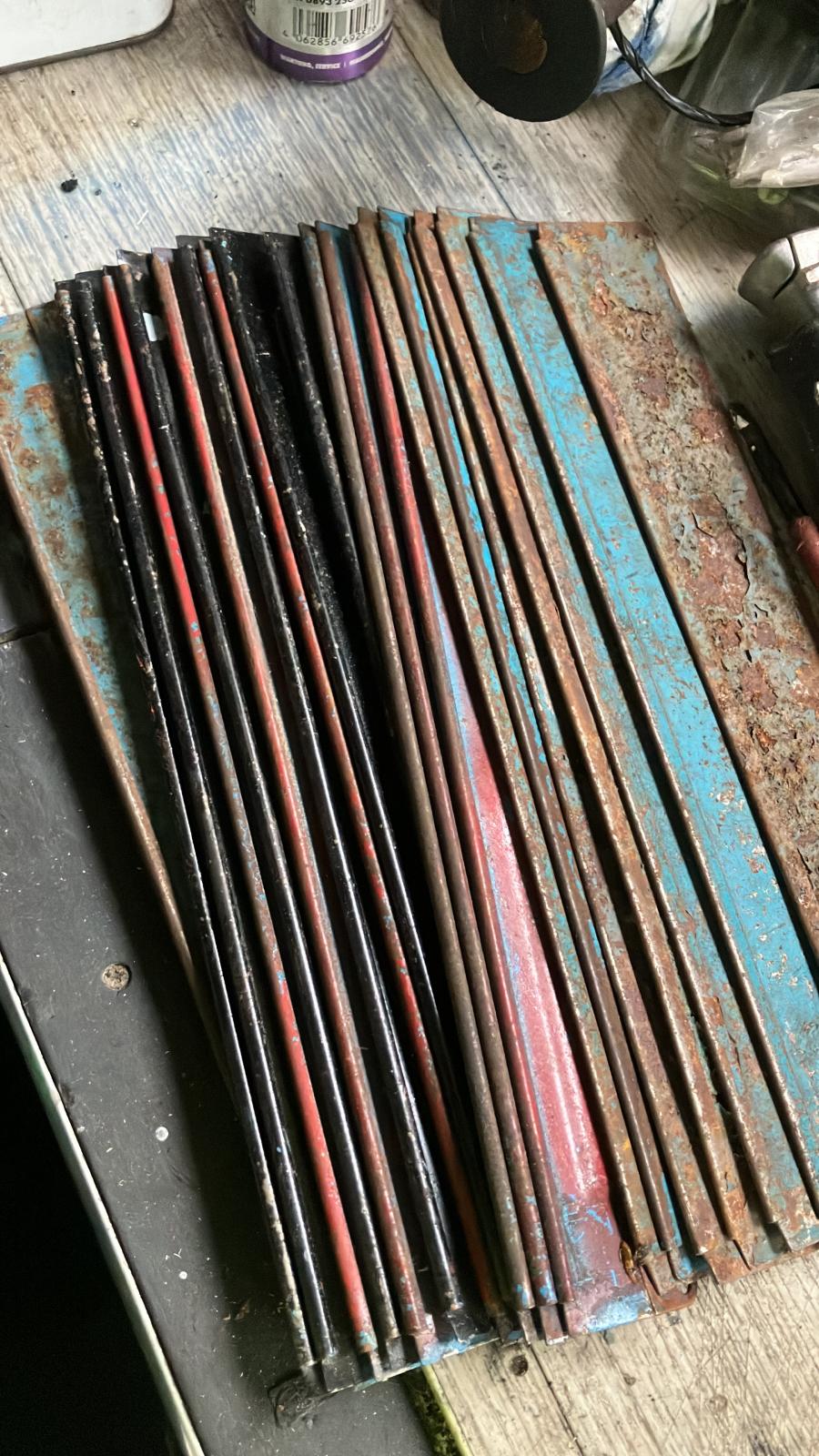

Are there two types of tray dividers ? Or is the one on the right a DIY job
(I know. The one on ledt should be blue) ?
I found a selection of dividers in my stash of Assistent parts.
20 in all. Strangely

Hello,
in my 1967-1976 166 TS are already the embossed versions.
Also a Porsche brochure with 162 photos from 1968 shows embossed versions.
In my early 160 from 1954 the panels are fixed and flat.
I think also these flat dividers are original from the 1950s and early 1960s,
because I have seen them in the early 161/162 version with flat top and
in a DKW brochure with 161 and 162 photos from 1955 and
such flat dividers as none standard length dividers as
- 1605 (half length for the long 1602 slot divider across the long side) and
- 1607 (full length across the long side).
Not sure in which year they switched to the embossed versions...

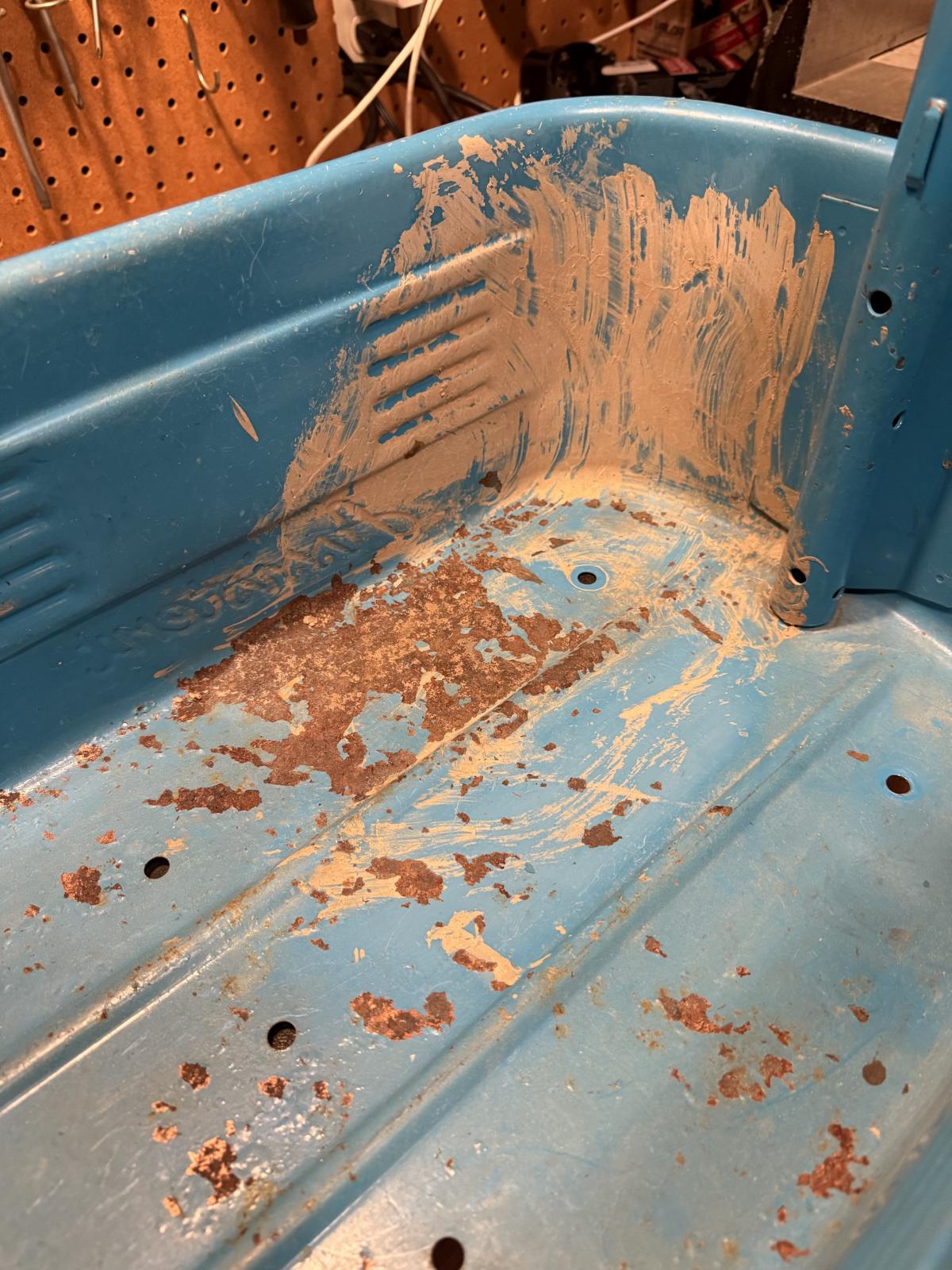

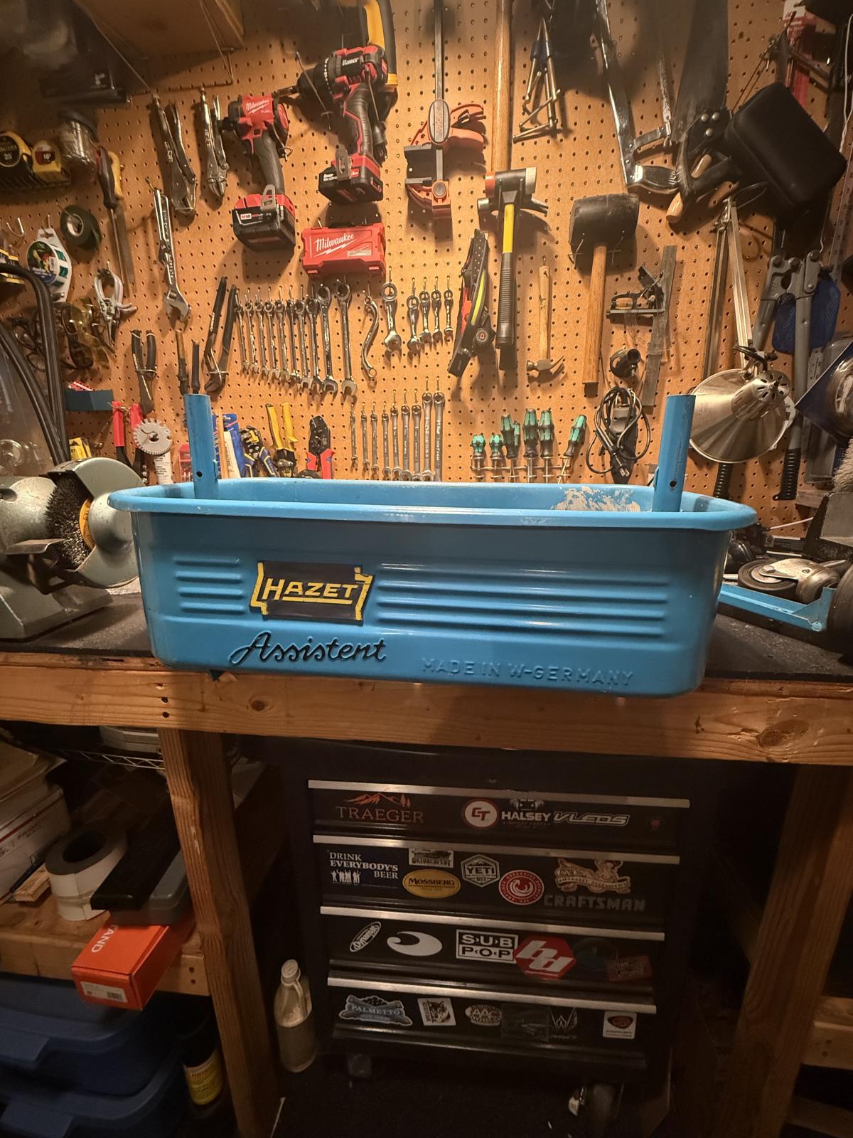

I have been re-reading this thread for a few years, with a growing interest in getting an Assistent. Finally decided to just do it, and started browsing here, eBay, and Craigslist.
It seems like the market just dried up, and the only ones that showed up were brand new, or older models that were way high. I found a 160 on eBay, pretty rough shape and altered from original for 750 obo (Plus $$$ shipping). I obo'd and never got a response. In the meantime I ran into the one I finally bit on- a 162N from early to mid 1980's.
It came in two shipments, and I came home from vacation to find the first box, which contains the bottom of the trolley, the tubular uprights, all the casters and rear axle, and the black knobs.
My plan is to more preserve than restore, but a few areas will need intervention. There is what looks like body filler dried on the inside of the bottom 'bucket', and also some broken areas of paint with nasty looking rust (no rust-through yet).
A couple of questions I have:
1. The steel tube uprights- are they just stainless, or were they given any protective finish originally?
2. Has anyone found a close match to the blue paint?

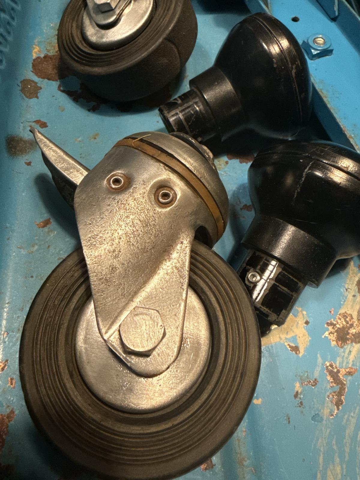

3. The locking casters on my trolley have some pitting and show evidence of being wire wheeled. Was the original finish for these just plain stainless? I am considering disassembling them and electroplating with zinc.
Thanks in advance.

Hello,
panicman wrote:
...In the meantime I ran into the one I finally bit on- a 162N from early to mid 1980's.
Nice find - with the lettering "Made in West Germany" used around 1979 to 1990 by HAZET.
(after a general legal dispute with the Russian sector East Germany in 1970s and till reunion of Germany in 1990)
I'd put a rubber mat in the tub anyway to prevent rattling when moving it.
The rust should still be removed and stopped.
I don't know details about the later models past the 1970s.
In early models like my 160 from 1954, it was more likely nickel-plated – in my luxury version, the 166 TS, it's bright chrome-plated.
In very modern models, it's more likely to have been made of stainless steel.
No magnet will stick to some types of stainless steel - have you test it?
It is documented by HAZET in the corporate identity rules, see https://www.hazet.de/en/downloads-applications/corporate-design.
In Germany/Europe we have for a lot of colors (not all!) a specification called RAL with numbering scheme - so the light blue is "RAL 660-2 Effect" or "RAL E2 EFFECT 660-2 BLUE" or something like that.
So with this you could buy it in Europe in shops (e.g. https://spraymyday.com/produkt/acryllack-in-ral-e2-effect-660-2-blue/) or you can take it to the nearest paint supplier and have it mixed by RAL color tables. Or go with your parts to a paint supplier with color scanner to find the mixture (but first find a clean and unadulterated place, e.g. below, where UV light never changed the color over the years).
Without having done a chemical analysis myself, I assume that they were/are zinc galvanized since 1950s and only current ones could be stainless steel.
In the pictures shown they still look relatively good. I've also seen some that are quite rusty.

That looks excellent. If I were you I’d find some paint close to your cart’s blue and rust treat and prime and paint only that area that’s affected. If it’s off in colour a little. It won’t be as noticeable as it’s on the inner of the tub. If it’s a thing that the remaining trays of your cart are as good as the tub outer, it would a shame to paint. The pitting on the wheel parts is weird, but I wouldn’t do anything to those either. New wheels are available if you were inclined to build a show cart.
Congratulations on joining the Hazet Assistent club.
All the best.

The postman came today with a box.
The most perfect fitting box you ever seen.
Some light surface rust. I’ll treat and paint.
Plan is to give it a light resto. I’m gonna retain the stickers. They’re cool.
Another older Assistent, (as in mid fifties) coming soon. Stay tuned.
