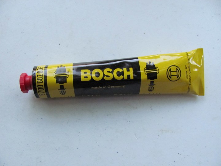

I still have a tube of this stuff, maybe I need to bring it because I might need to lube up the coil packs or crank sensor.

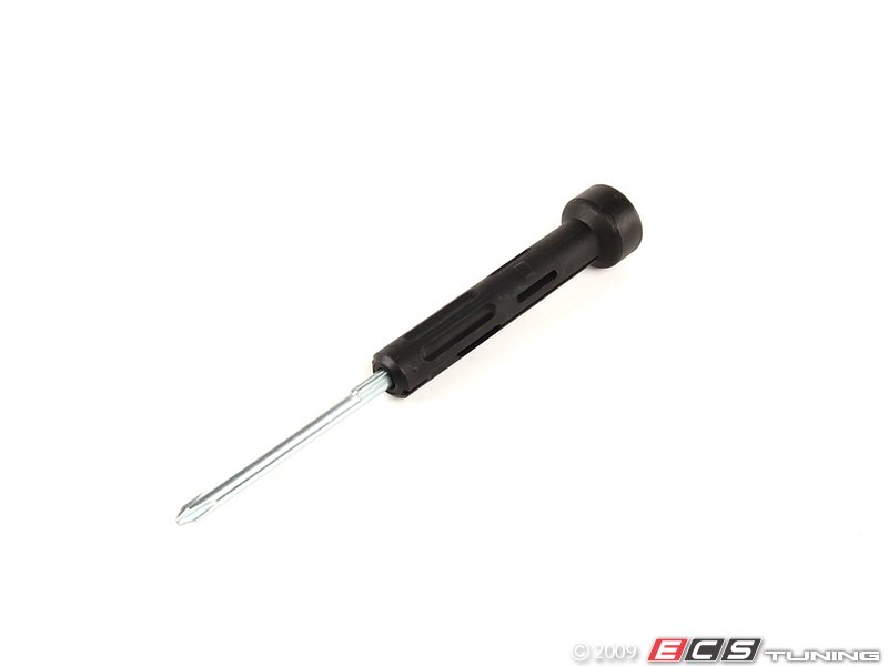

I also bring a bunch of tip ties (they are great for camping) and a roll of 3M 3903 Vinyl Duct Tape. The tape is like wide electrical tape but the surface is embossed, thus really easy to tear. McMaster Carr has it #7769A1 (also great for camping). I use that stuff for lots of things.
