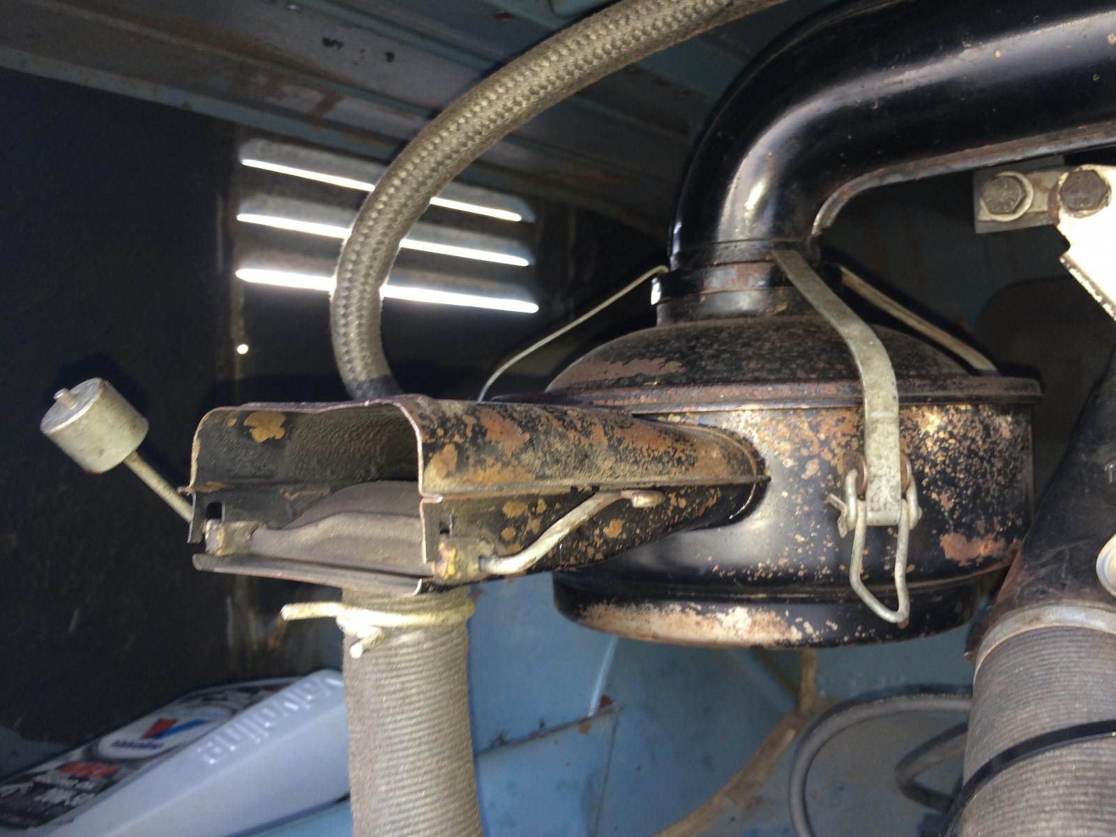

From an earlier post by Clara: 3) what is the outside temp? is it 50F? 90F? If it is 70F or higher did you put the pre-heat in summer position?
Trying to piece this tip together re summer position from a position of complete ignorance. Based on other threads I think the pre-heat goes from the heater box to the oil bath air cleaner. I have Webber ICT carbs now, so no oil bath. Is this irrelevant for me? Is there anything I can or should do related to my preheat outlet to prevent overheating in Summer? If I had an oil bath, how would I put the pre-heat in Summer position?

mostly the pre-heat comes from under the engine, not from the heater box.
on stock late 67s it comes from the heater box.
To put the pre-heat in summer position, put the not weighted side of the pivot arm under the ledge on the air cleaner, as so:
This keeps the flap open.
Do this when it gets above about 70F during the day.
Summer Position:
In winter the arm should move freely, so at idle it sucks pre-heated air in, and the flap should move when you step on the gas.
Getting pre-heated air means the engine warms up better, and helps eliminate carb icing which is a problem in damp climates, even up to into the 60s.
When it gets below ~70F during the day, I put it in winter position.
Winter Position:
If you have no oil bath and this no pre-heat flap, you probably not having any pre-heat, and you can't turn it on in winter or off in summer.

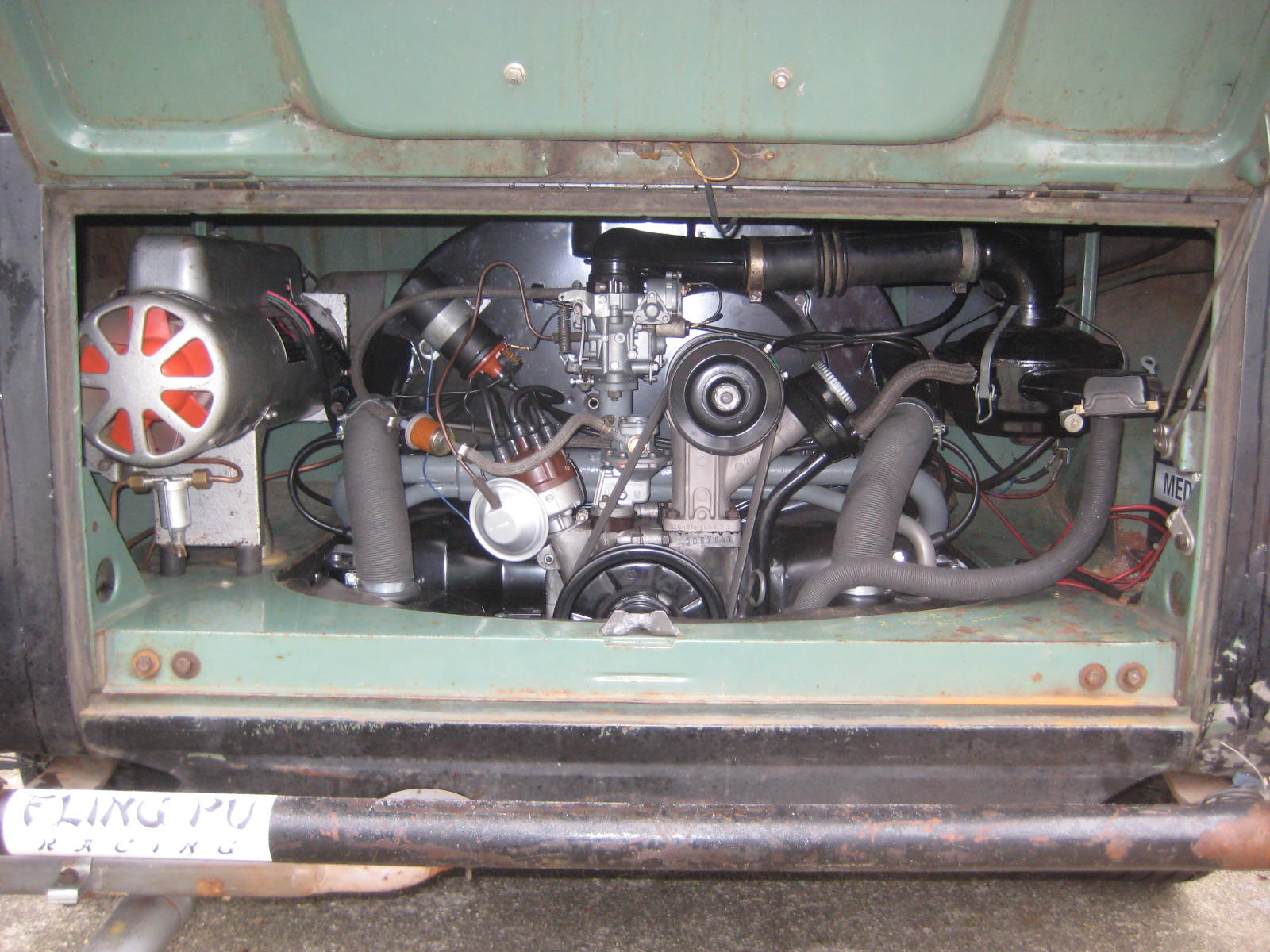

I do tend to install all the tin VW put on there, and also use the doghouse oil cooler, and thermostat set up, like VW designed.
We got 80K miles on this motor that was newly rebuildt in 2011. (It needs a re-rebuild now, but this was when newly done):
here's a set of tin:
