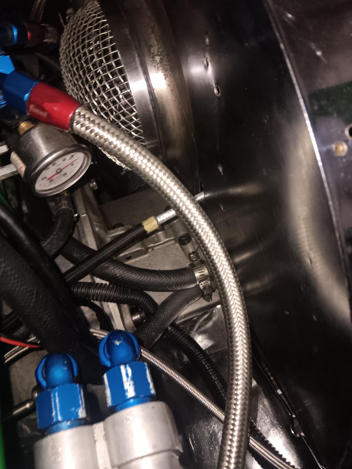

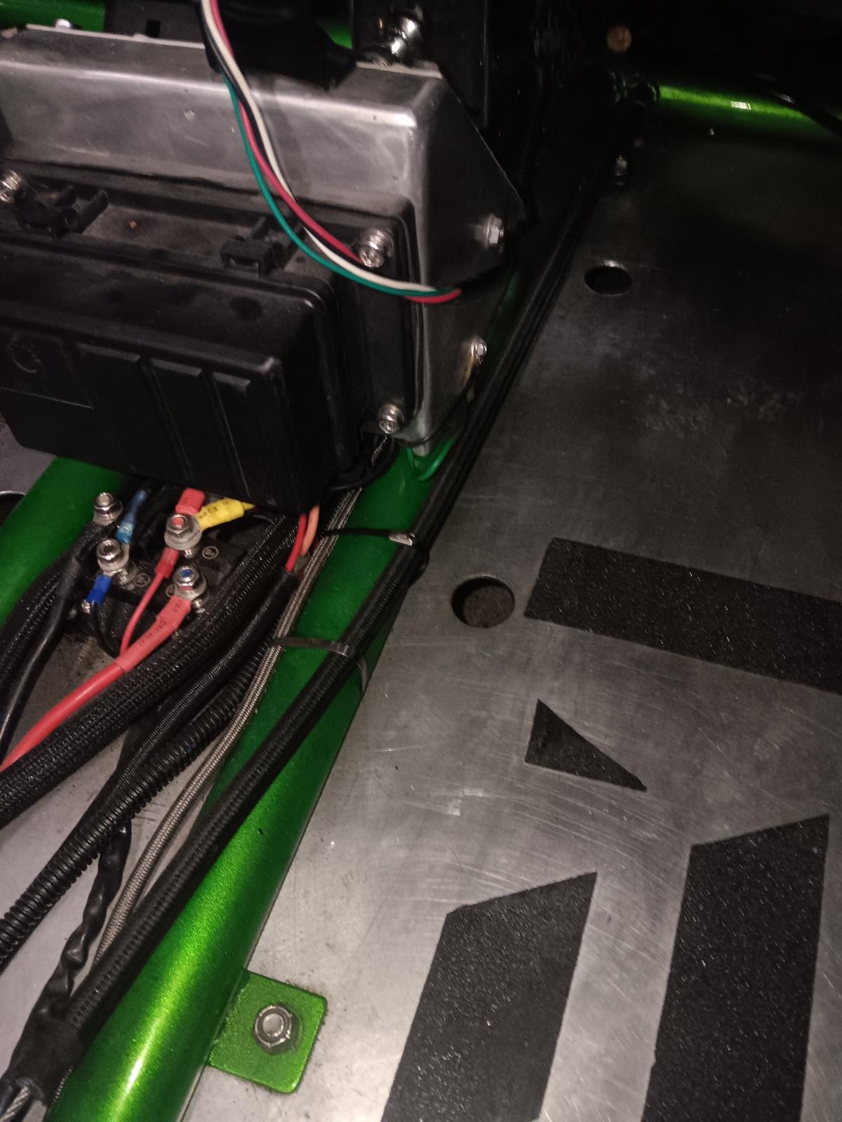

PostPosted: Sun Jul 13, 2025 6:17 pm    Post subject: Re: Bowden tube mounting Reply with quote
I had some left over evil energy braided fuel/oil tubing. It's got a Teflon tube running down the inside so the cable slides through it easy. I run it from the pedal to the fan shroud where I've got an aluminum tube with a little pulley wheel on it. Works good. Still need to trim it yet.

WaterBuggy_24
Joined: January 19, 2024
Posts: 63
Location: KCMO
WaterBuggy_24 is offline
PostPosted: Sun Jul 13, 2025 6:22 pm    Post subject: Re: Bowden tube mounting Reply with quote
Here are photos to my previous reply.
