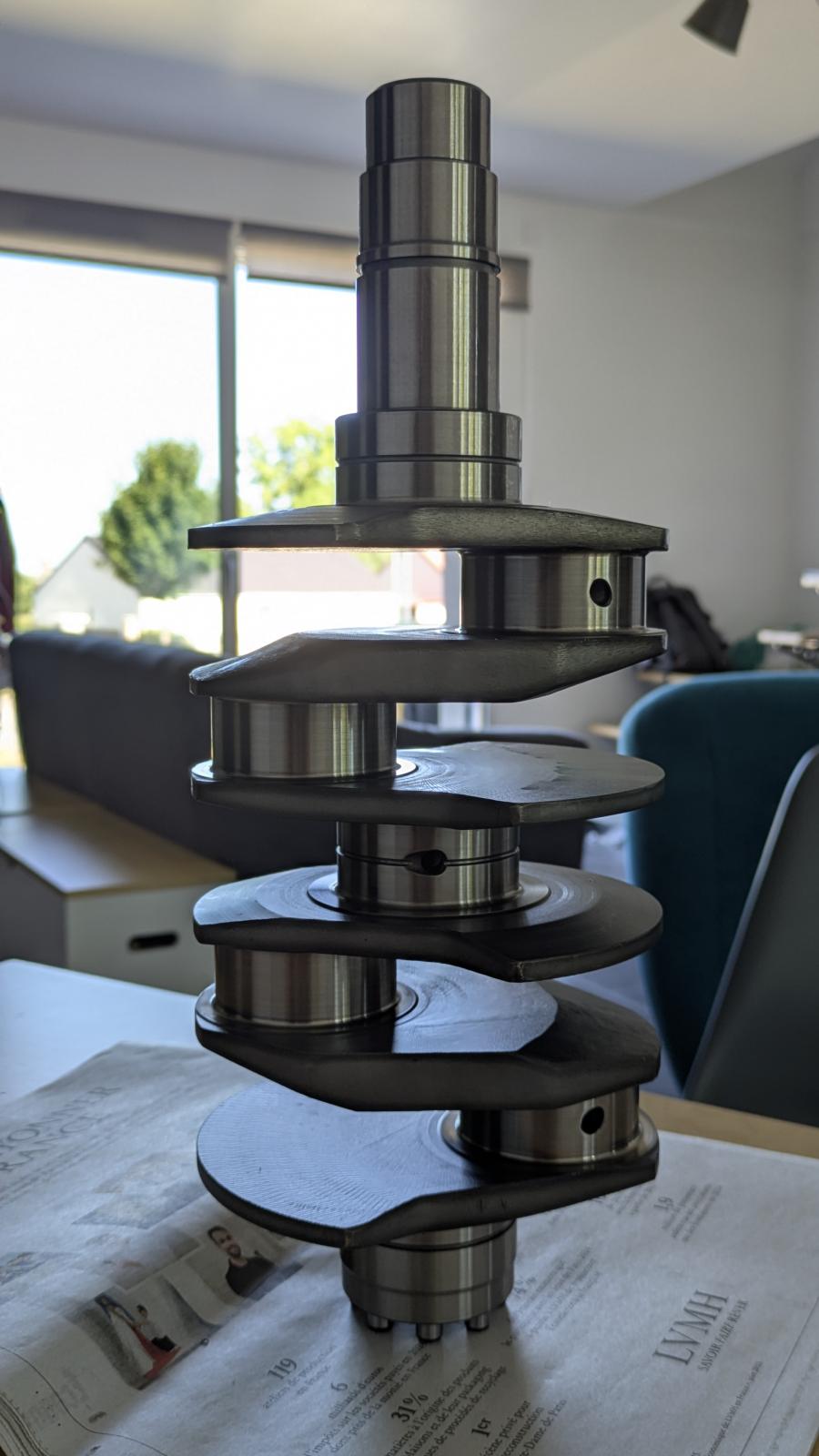

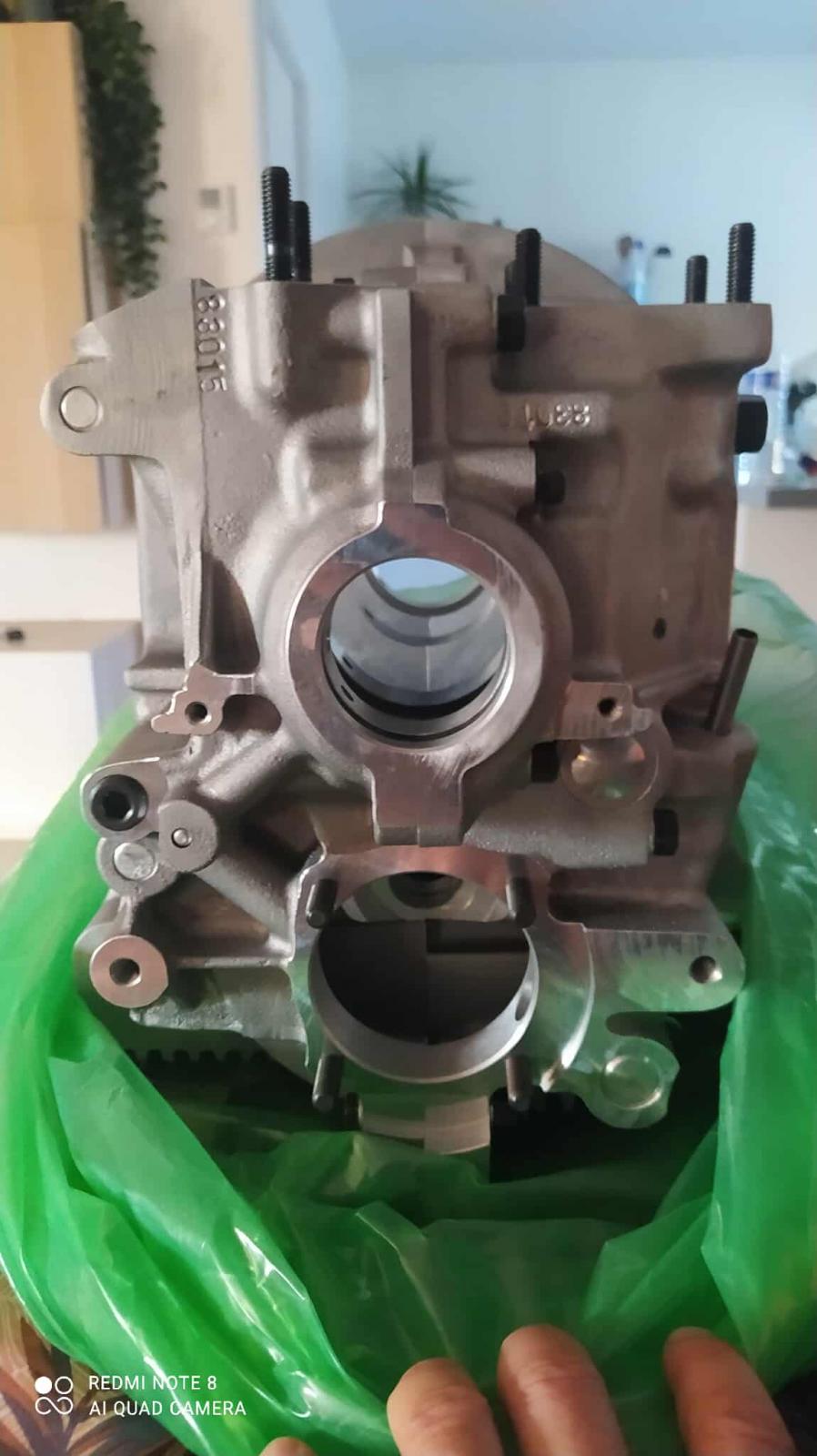

The engine is still in plans, and plans have slightly changed. Since the stock case and crank were out of tolerance, we went to an new aluminum case and a 74 mm crank as they were at a very good price and the crank match with the "A" pistons my friend already has.
We went for a non stroker case as we won't have to modify the fan shroud and still have enough material for stroker clearance.
The 74 crank and A pistons will make an easy Deck Height setup using shims.
Are the FK7 of FK42 cams now more suited for this future 1968cc engine ? Or could you suggest us a cam to go with 1.4 Scat rockers as we already have them ...
IMO, the FK7 should make a nice and reliable engine without much valve train noise.
We aim for 8.5:1 CR with 0.04" deck and 59 cc heads (corrected Panchitos, AA 500 D port or DG063 40*35 heads are in the plans)
