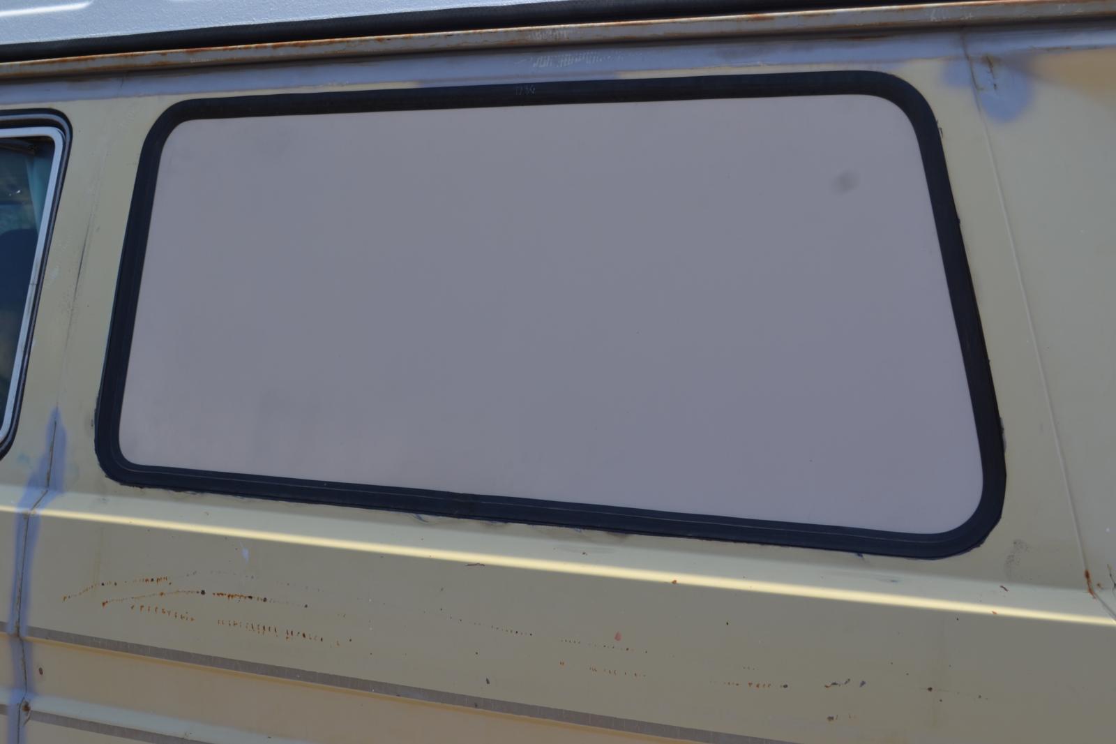

PostPosted: Thu Jul 17, 2025 9:57 am    Post subject: Re: 1981 Vanagon Westfalia Reply with quote
I also got around to removing the back driver side window with an aluminum cut out. I replaced the seal and painted the aluminum. I honestly want to weld in sheet metal for the two rear windows and the rear glass. I eventually will, but I have other things that need my attention. I also removed the rear cabinet as it needs some attention. I began installing Killmat while its out. I will also be installing new insulation.
