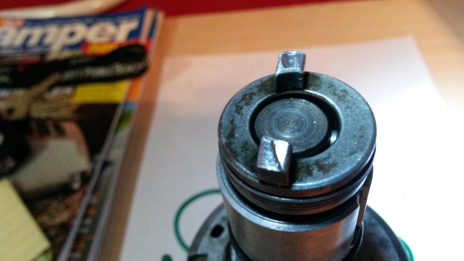

Post a pic of the bottoms of both distributors. The cog at the bottom of the distributor is held in place with a pin. The cog can be installed in two different position that could rotate the rotor 180deg from where it should be. Compare how they are mounted on your two different distributors.
