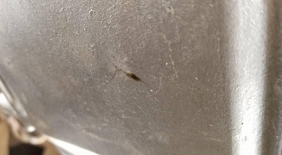

PostPosted: Fri Sep 22, 2017 6:00 am    Post subject: Re: Folks who have used the Small Car kit for the Subaru 2.5 swap... Reply with quote
Smallcar oilpan bulging and leaking in middle for no reason.
Smallcar oilpan mounting bolt area cracked and broken even though properly torqued to 6 ft/lbs.
Both claims denied by Smallcar.
Note the cracking and porosity of the material.
Garbage.
Neil2

PostPosted: Fri Sep 22, 2017 7:20 am    Post subject: Re: Folks who have used the Small Car kit for the Subaru 2.5 swap... Reply with quote
...and they have the nerve to jack up a van by the oil pan as an advert?
Personally, from what I've read here, everyone should just 'forget' they exist and find the parts elsewhere....
