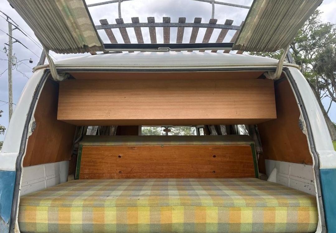

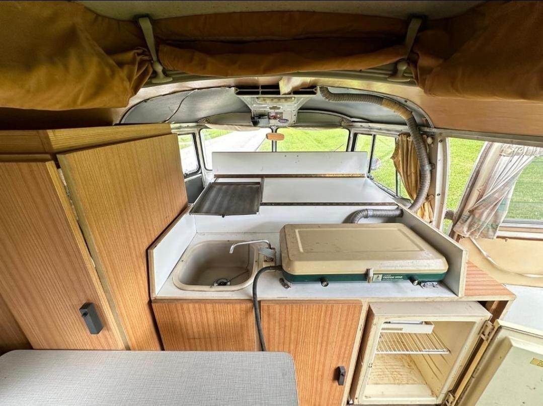

While working a deal on a so42 in sanford FL, I spotted this jewel- a 1966 so44. Pretty rare beast with alot going for it. It was also made on both mine and Bex's birthday's - 420, so I had to have it and we decided to fly out and drive it home to Arizona down Route 66 for a week. The challenge has been to escape from Florida, before the rust takes anymore from the bus, and get it back to dry AZ lol. There's still time!
Left on july 4th evening, was cool seeing the fireworks from the top side! Got to St Augustine the next morning and rode out to meet Robert Kennedy of Bulli Brigade fame who was the current custodian of the bus for the last year or so after Grayson pulled it from a barn.
Bus status- 1600sp 6volt, now runs great but history unknown. Occasional starter issue. New starter, battery, fuel tank, tires, petronix. Let's go for it!
Arrived last Saturday the 5th and picked up the bus.
Getting into some specs-
66 so44 poptop, only 500 kits made, still 6volt with original interior, original engine, still working Blaupunkt radio and Water bottles, Speedo says 20k so I assume 120k og miles.

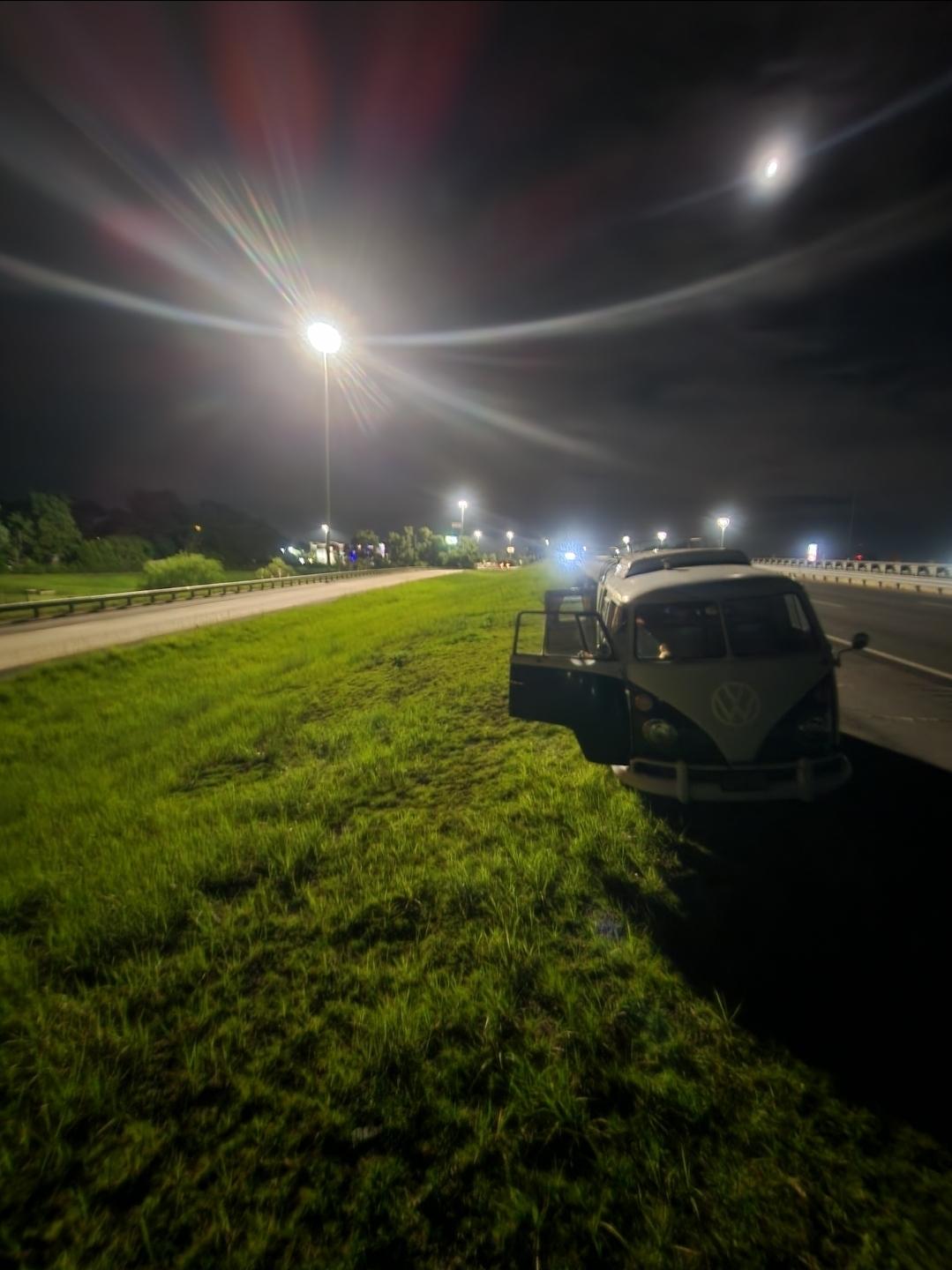

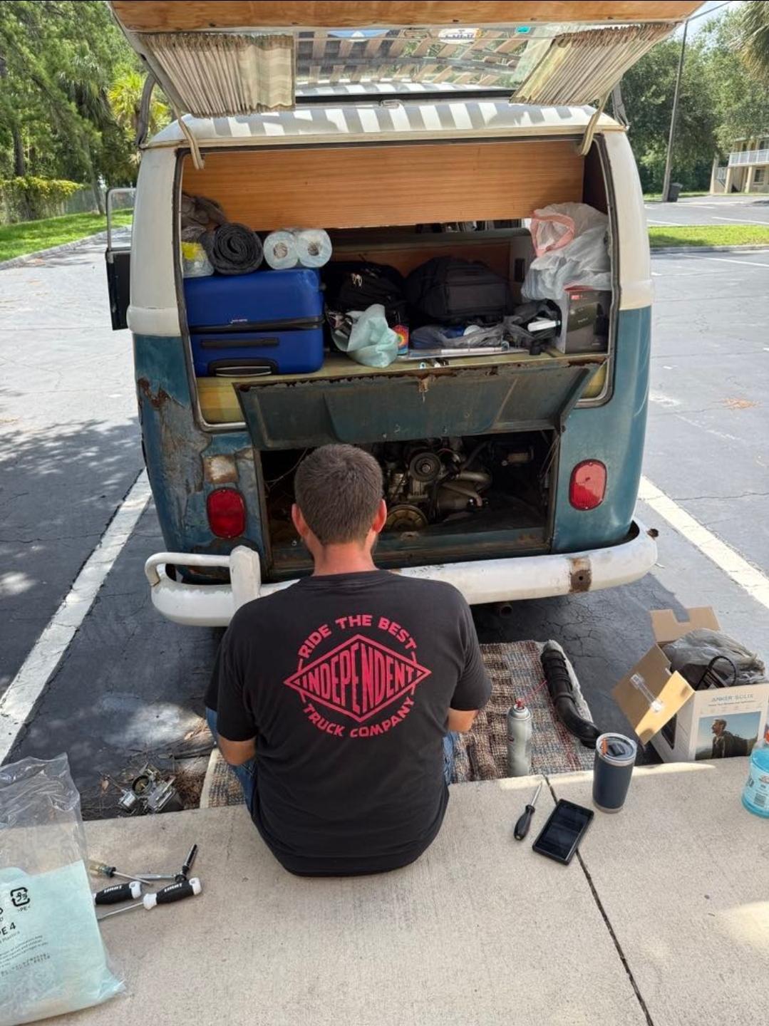

Sunday afternoon we headed out, and around midnight tragedy struck around Brooksville- loud rattling and then engine blew and locked up solid.
Got towed to a hotel 1 mile from us that we could see from the highway and crashed out around 2 am.
Next morning after posting an update in a facebook group, an amazing man named Michael Harmison volunteered to jump in his truck and come get us and tow us back down to Sarasota where I had found a used long block 1600DP at a local shop. Mike is my hero! But finding Turnkey on the weekend proved difficult but luck was now on our side and we got the lead thanks to Robert scouring his phone book to help us look. The turnkey was an unknown 1600DP that came from a customer car and sat on the shelf. Good end play and what they said was 175psi compression.
Made it to the shop and we dropped the bad motor that evening out in their shop so they could get finished quicker.
In the meantime, Mike volunteered to host me at his spot, and him and his lady Julie showed us around town, his VW's, and the beach.
Also got to meet a local Wayne who showed me some of his cool collection, Wolfsburg 55 pg and a wide bed bolt on kit he bought in Austria.
3 days later they had finished the swap. Also put new ebrake cables and repacked a front wheel bearing. I had drop shipped them a 6v hard start relay and ebrake cables which they installed after having to weld the ebrake holder brackets back onto the backing plates.
They had decided to throw a new Chinese KIPA carb on it to save potential tuning time which I didn't like, but it was running great so off we went. Headed back to family 20 minutes away and it ran great.
2 hours later I fired it up to leave and noticed it took a little longer to start and started popping and what seemed like missing under load. Drove for a bit into Gainesville then bellowing smoke started from drivers side. The valve cover was dumping oil. Pulled it off and I realized the gasket was garbage and they hadnt changed them. Stayed at a hotel in Gainesville and in the morning I checked the valves....all of them were at zero!
Also I was sure they didnt change the plugs either so I found a local shop- Werkshop49 which I limped to and was very good to me and got my parts in and installed. Asked them to tune on it and he spent 5 hours even after closing, trying different things. It seemed to get worse the more stuff he tried (carbs, dizzy etc). His smoke tester showed leakage out of the boots which also hadn't been changed, but were bought off as good by the last shop. A local guy Lorne came by to give suggestions as well.and lend a hand, much appreciated. The only thing harder to find than a 1600 on a weekend is dual port boots on a Friday night. I cant escape Florida.
Werkshop49-
Limped it to a cool local spot - Satchel pizza. Wild place!
Boomerang time- back I went Saturday to where it began on another tow to the seller Robert's house who just HAPPENED to have dual port boots being delivered to his house by none other than Doctor David Bogel, carb whisperer. Factory trained so I knew we would get it. I did the boots swap in the bus, and Dr. Dave with the help of Robert, whispered to my engine long into the night. He thought the needle/seat was sticking so eventually replaced that as well.
Sunday morning Dr. Dave (as I call him) was tinkering again and had it running great. Also had a special guest drop by, Cunado! He ruthlessly car jacked someone from their cool restored Austin buggy and took the gang on a roadtrip around the block while we slipped out across the countryside to follow the sun.

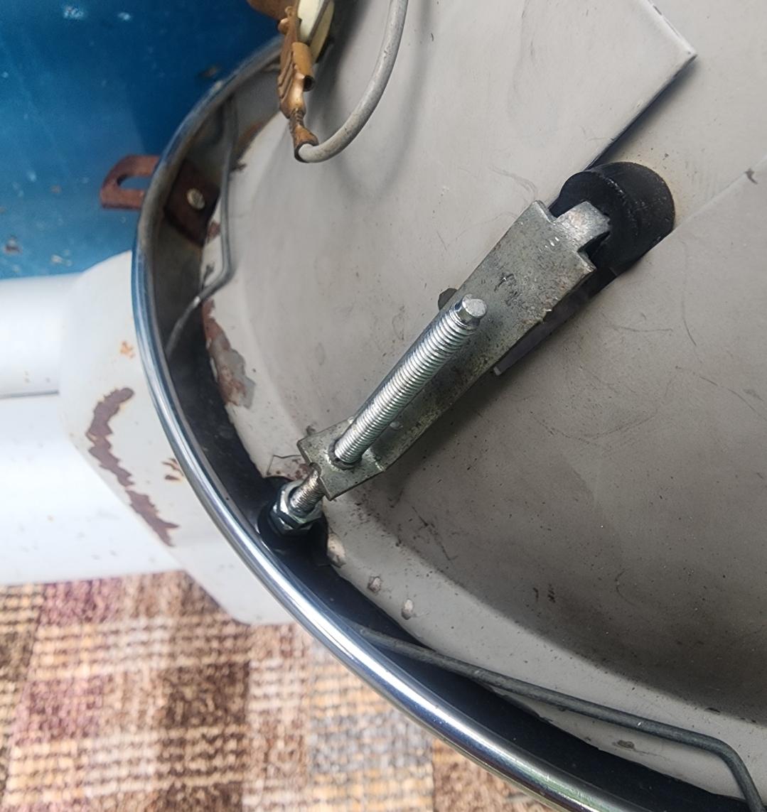

Pulled driver headlight apart as the adjustment screw heads were stripped (phillips) and it was way off. I just happened to grab a headlight ring from a project I bought back in florida, so I swapped the ring but it wouldnt adjust properly as it didn't have anything besides some loose tubing holding the screw heads to the replacement ring, so I did the 4mm locknut trick. Should adjust great once nightfall hits.
Adjusted valves- drove a little over 1000 miles and # 3 had both tightened up. The rest were still good except for #2 exhaust had become tighter. Running Doghouse on the replacement engine. While I was under it I noticed I was now missing a strainer plate capnut, so back over to Polk's Bug Shop to grab more spare parts.
