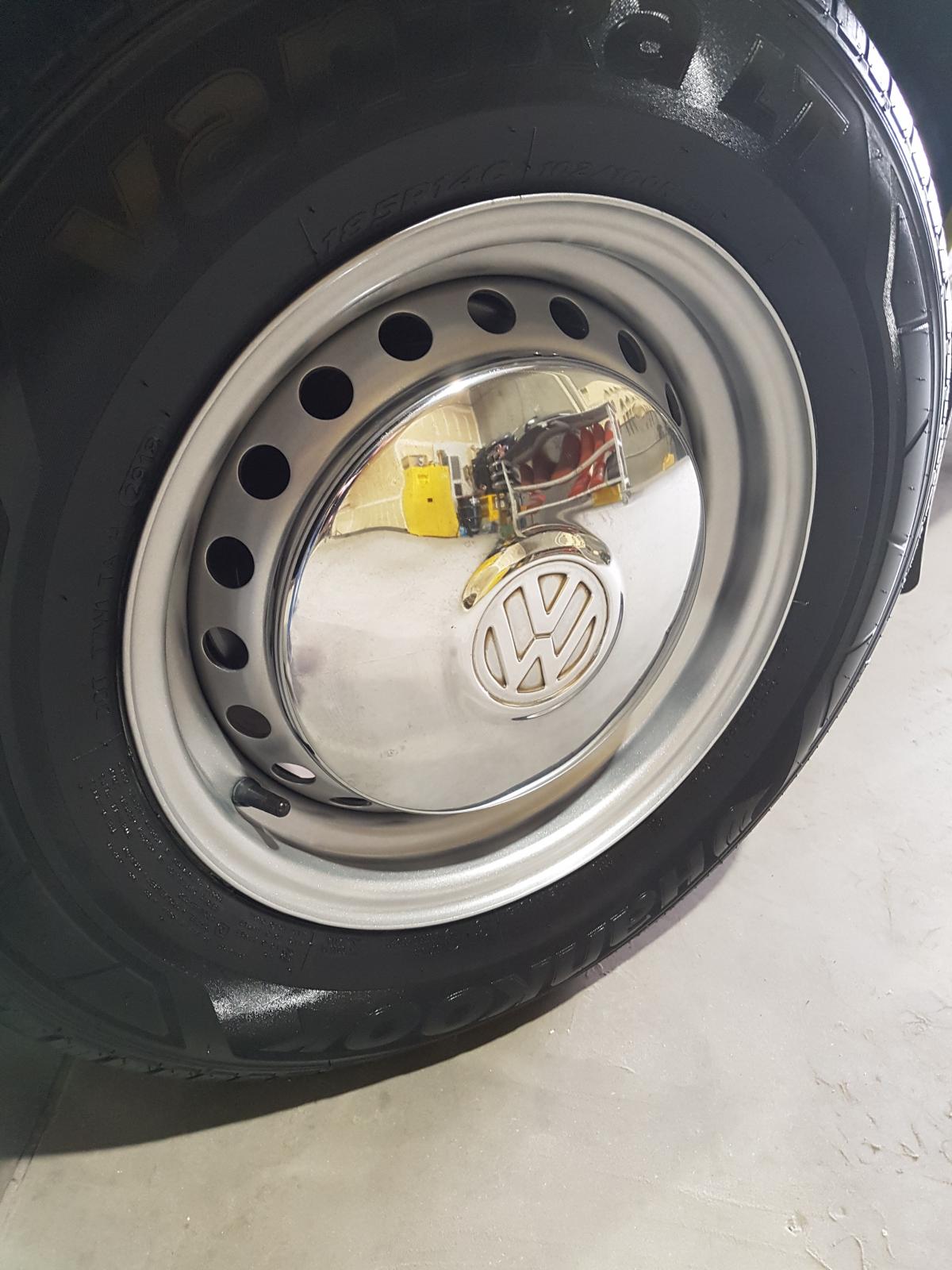

PostPosted: Fri Dec 28, 2018 9:57 pm    Post subject: Re: Stock silver powder coat paint for my '78 Bay Reply with quote
Got mine done today (5 wheels). This thread was the most helpful, so I'm posting these here.
The color we used was Bengal Silver.
Fresh out of the oven:
Mounted:
It was overcast today, so I'll have to wait until tomorrow to get some sunny pics.

PostPosted: Fri Dec 28, 2018 10:53 pm    Post subject: Re: Stock silver powder coat paint for my '78 Bay Reply with quote
Looks good. Where did you get your powder from?

PostPosted: Fri Dec 28, 2018 10:54 pm    Post subject: Re: Stock silver powder coat paint for my '78 Bay Reply with quote
The powder coat company...they are full service.
