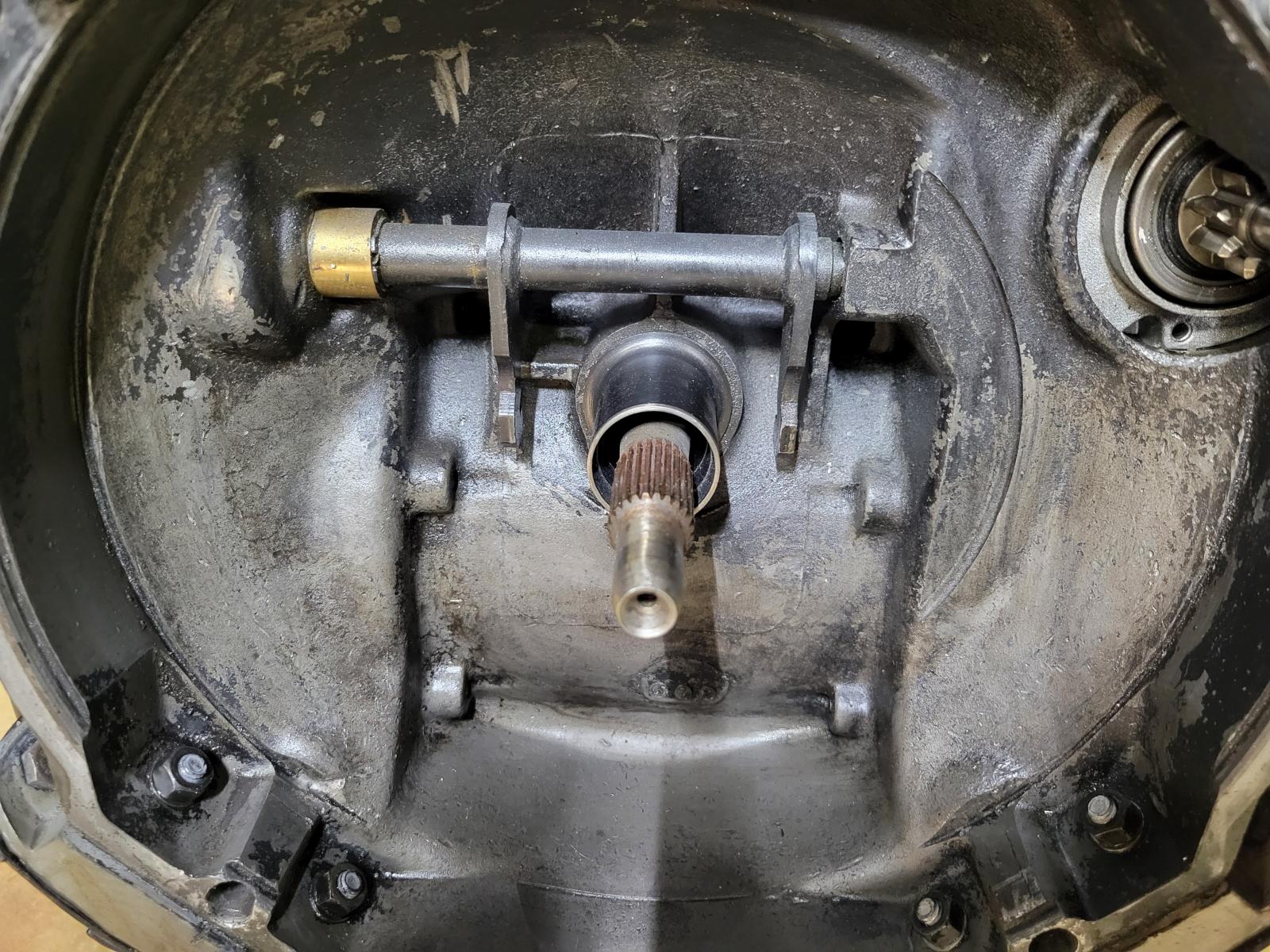

I need to replace the seal. How do I get this tube out?

That's a first for me. All the TO tubes I have seen are three bolted.
I'm spit balling here. Perhaps if you heat the tans case a little around the seal area, the metal will expand a bit and release it's grip on the tube.
Kind of the reverse of installing a crank timing gear, just much cooler temp.

I have never seen that before either. Is that a late type 2 trans?

Aftermarket press in (pound in with hammer) tube..... Wiggle it up and down and sideways till it comes out....
It's so you can use late TO bearing on early trans...

Right. I just couldn't remember how it went in. Thanks!

The right size shaft collar and a puller perhaps? I kinda hate the wiggle it out idea because it needs to fit snug when it's put back in.

Agreed its a retrofit that's pressed in.

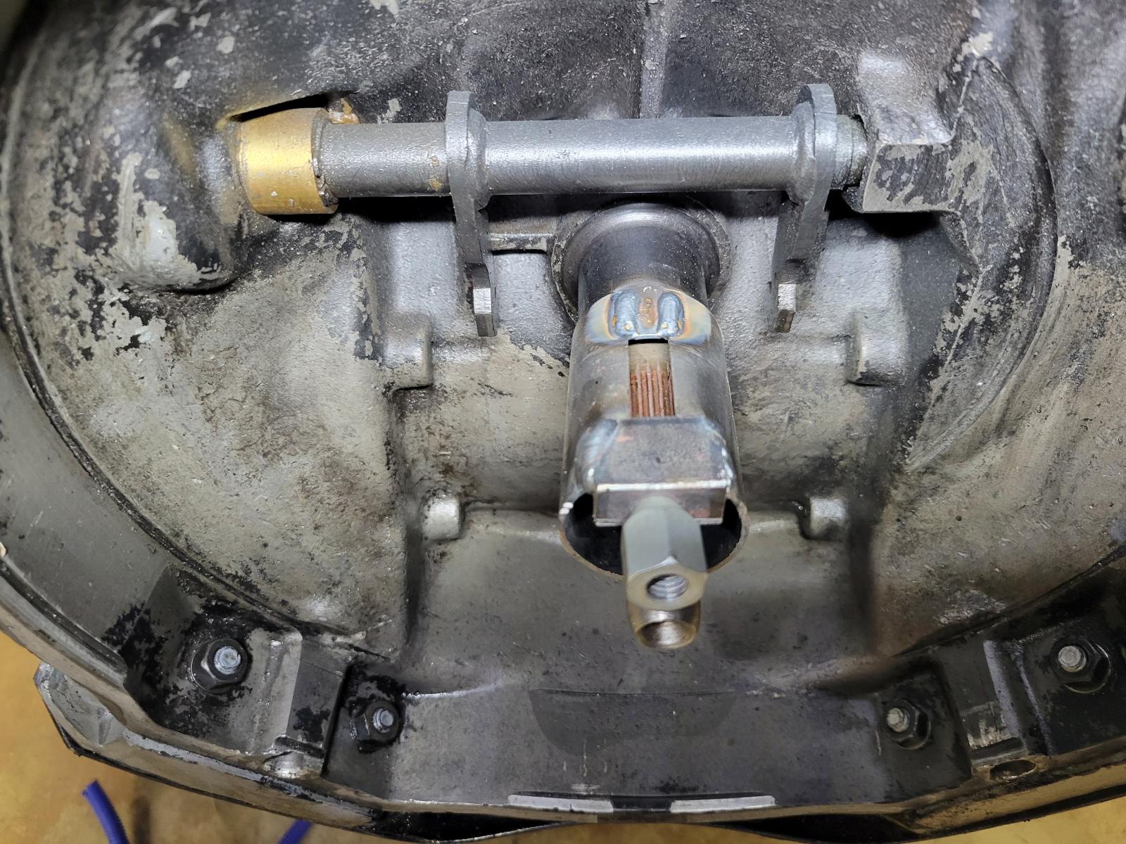

I have some 1-1/2 ID iron pipe. I'm going to try to reduce one end of that pipe to get a close fit to the tube and use that to walk it out.

I'd say weld all thread to it and use a slide hammer.
The newer improved version of this part has a few holes drilled in it so you can make a puller, and a drain hole so as to..... not channel all leaked oil directly into the clutch.
You can buy a new one, or just put a lot of holes in yours while you can.

Good idea Glenn.
Randy Bowen sez I'll need to get with Whisler to source a replacement seal. Or maybe I'll just buy another if Randy has one.

I agree.
Here is revised version
https://www.thesamba.com/vw/classifieds/detail.php?id=1441973
