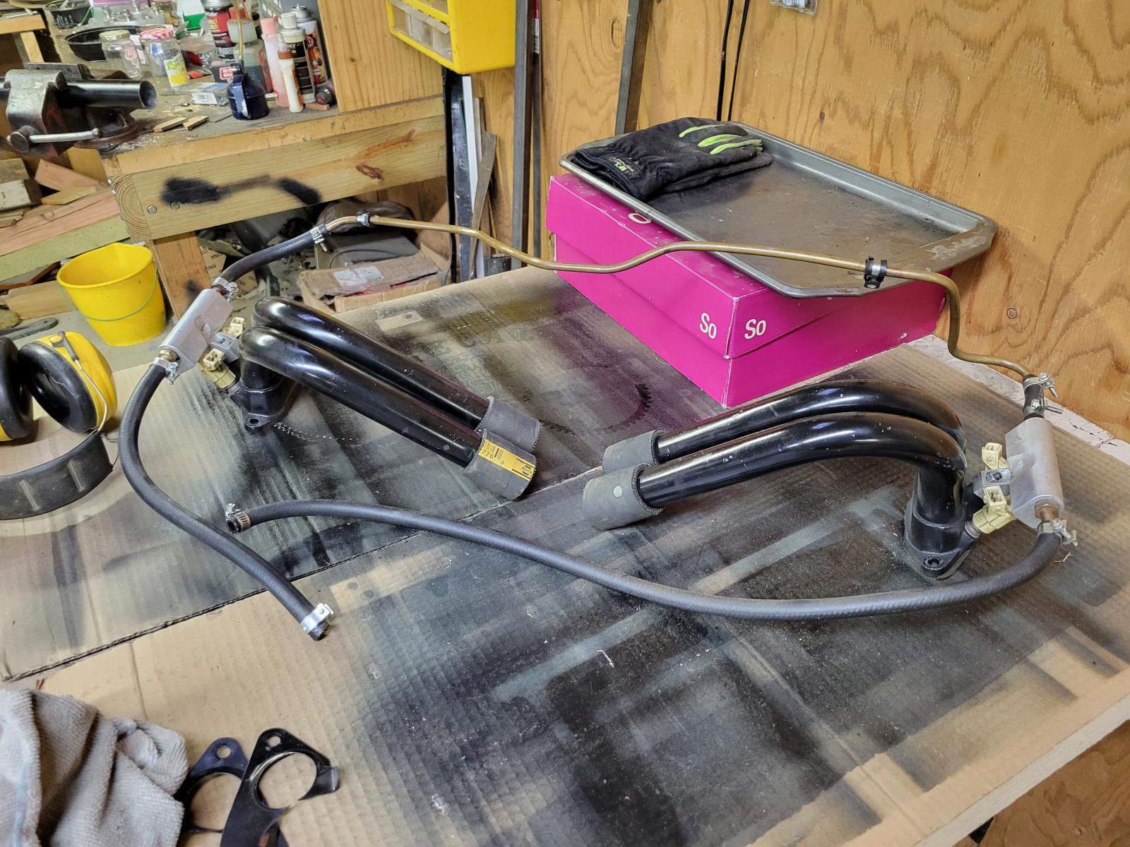

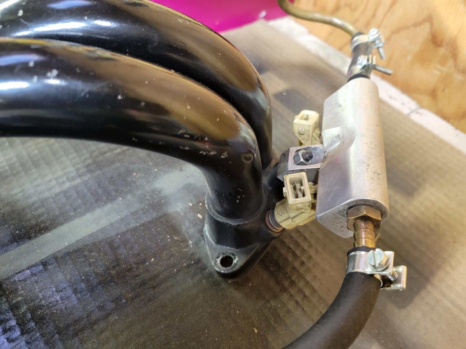

PostPosted: Tue Jul 15, 2025 7:23 pm    Post subject: Re: Home Stretch Reply with quote
Progressing with the engine strip-down. Here is the FI fuel loop and injector holder.
Tomorrow I'll have the old heads off and give Randy a call to get some port-matching done with the new Panchito heads.

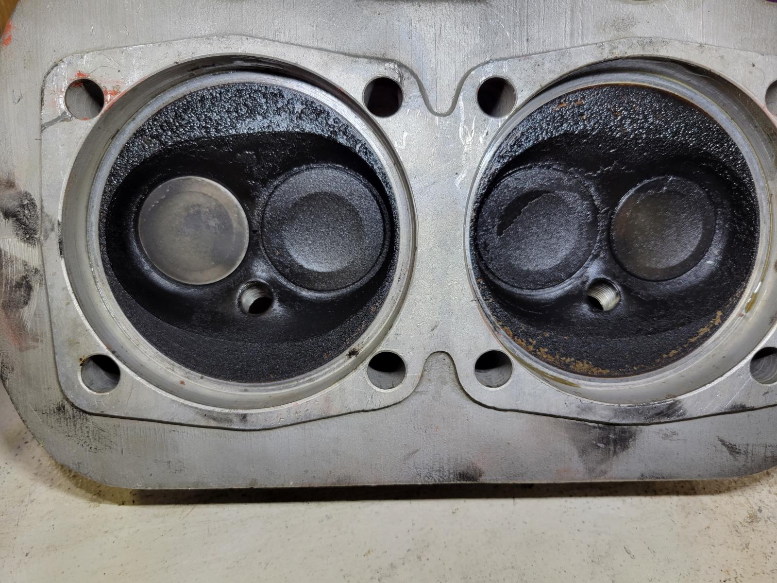

PostPosted: Wed Jul 16, 2025 6:48 pm    Post subject: Re: Home Stretch Reply with quote
Here is one of my old heads. These things have been on several Berg Cruises and in three different cars. Lots of miles, many of them crossing the desert in the heat. Looks like I've been running them a little fat. Also I see cracks between the valves.
