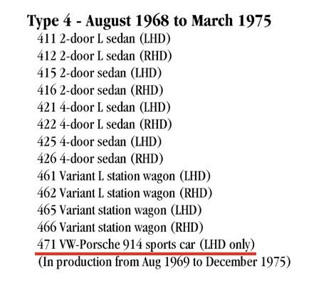

found it in my files.
the first two numbers of model type were used in the first two numbers of vin.

Yes, the number to the right of the "fahrgest-Nr" 460 is the chassis number
460 pretty much lays out the "series" of the car. The "460 series" are all wagons/variants. Really its the "46 series".
The 420 or 42 series are all four door sedans and the 410 or 41 series are all two door sedans.
We know yours is a "46" from the upper left hand corner of the plate and the 460. The "0" in 460 means ....1970. According to other sites, the "S 89" in the top row of type "should" be the authorization/certificate number for your gasoline heater system.
2037938 is your chassis number. There were three production groups listed for 1970 in the production survey. Keep in mind the model year changes in August. These production survey numbers are in a really poor order in my parts book.
So:
In July of 1970 model year your vin # would have been something like 410 2100 000. The 0 in 410 designating 1970 model year
In August of 1970 (1971 model year starts) it would have been in the range of 411 2000 001. And again, the "1" at the end of 411 stands for 1971
In December of the year 1970 (model year 1971) we have VIN #'s range 411 2017.
So, what does the VIN # on your dash start with?
