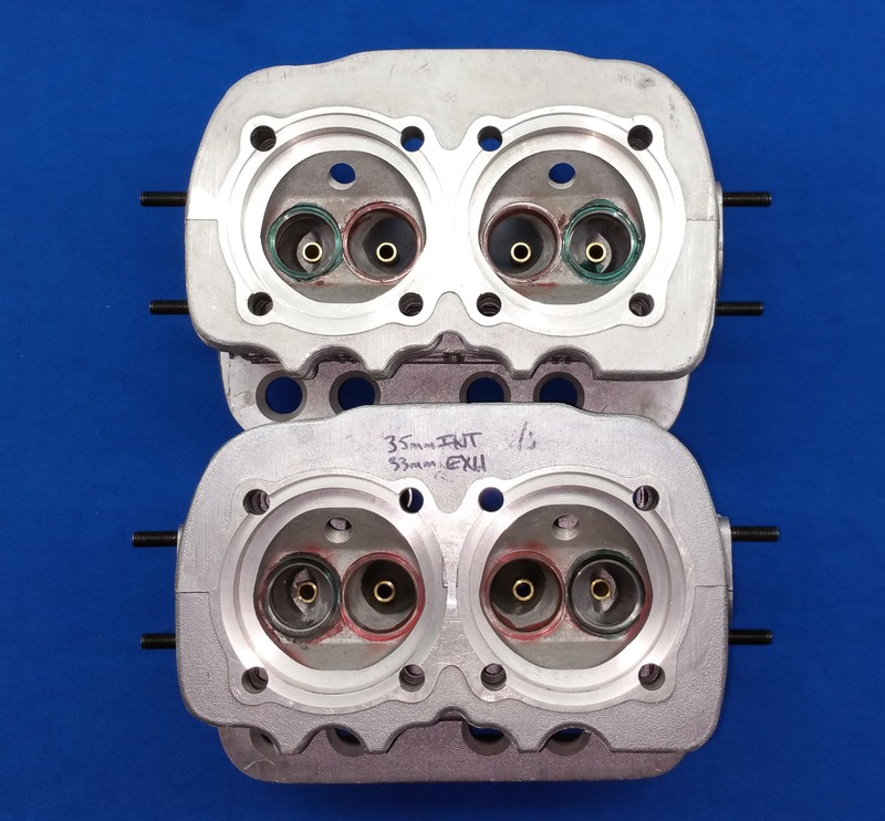

PostPosted: Fri Dec 05, 2025 4:53 pm    Post subject: Re: Wolfsburg West Okrasa heads/kit Reply with quote
Given all the comments on the WW Okrasa kit with my engine build just starting, took the new manifold and heads to my machine shop to get them checked over. The intake manifold flanges were warped with welding slag internally. Here's what they found.

PostPosted: Fri Dec 05, 2025 6:38 pm    Post subject: Re: Wolfsburg West Okrasa heads/kit Reply with quote
That sucks seem like your not the only ones with wolfsburg west head problems.. I think wolfsburg west should pay for this work since they are already expensive heads or return them with your finding sheet of the problems ....
But im not shock about the manifolds those are normal..but you would think wolfsburg west or the company who makes them would clean them up and reface the manifolds...I say call wolfsburg west and see what they say like I said these kits are not cheap they should do something about it .....so before any work notify them ...
