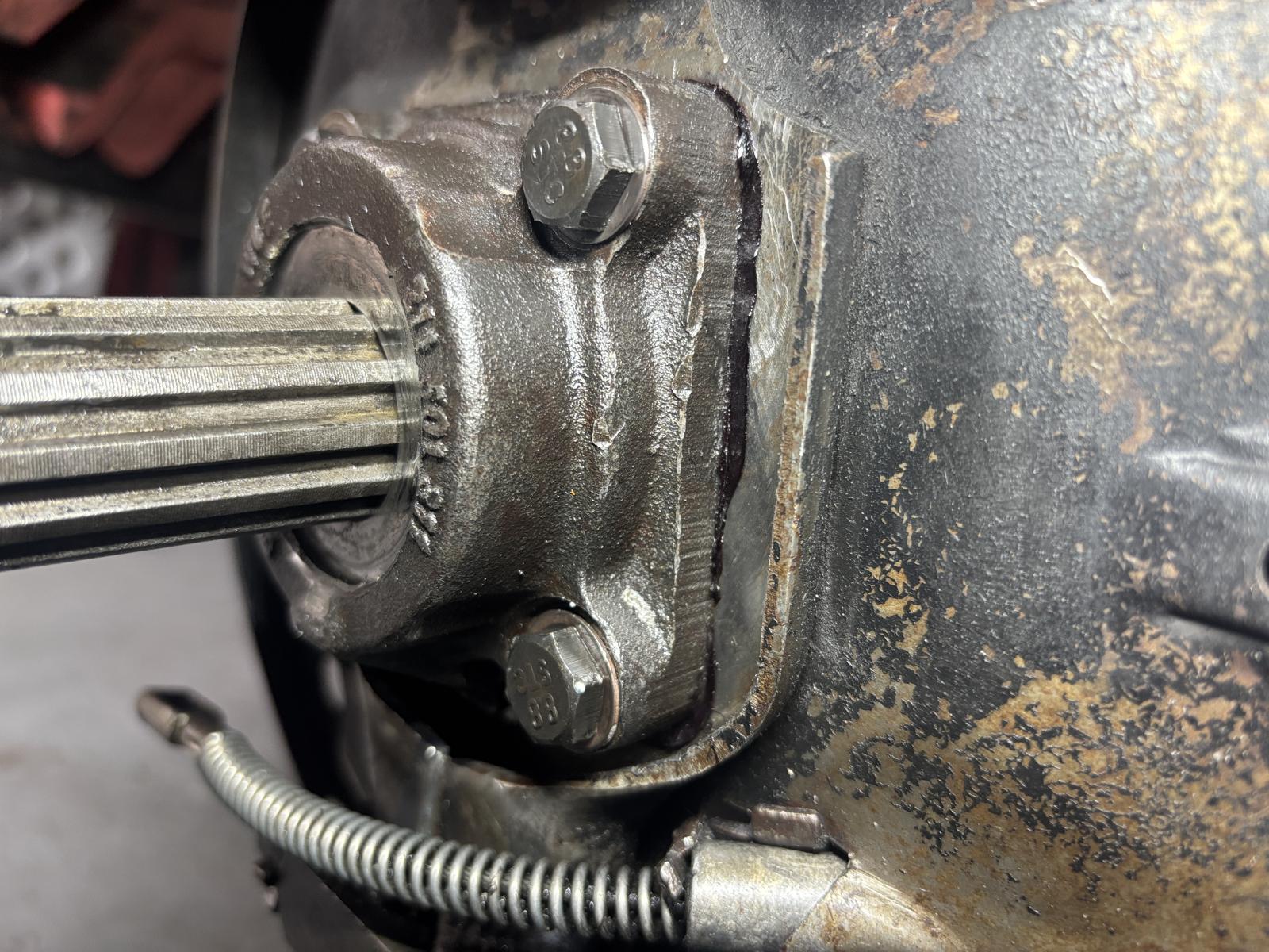

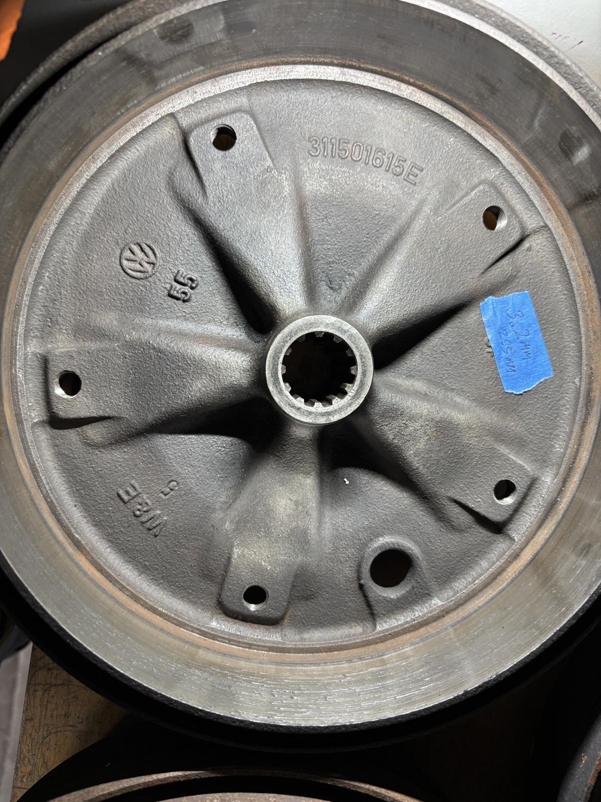

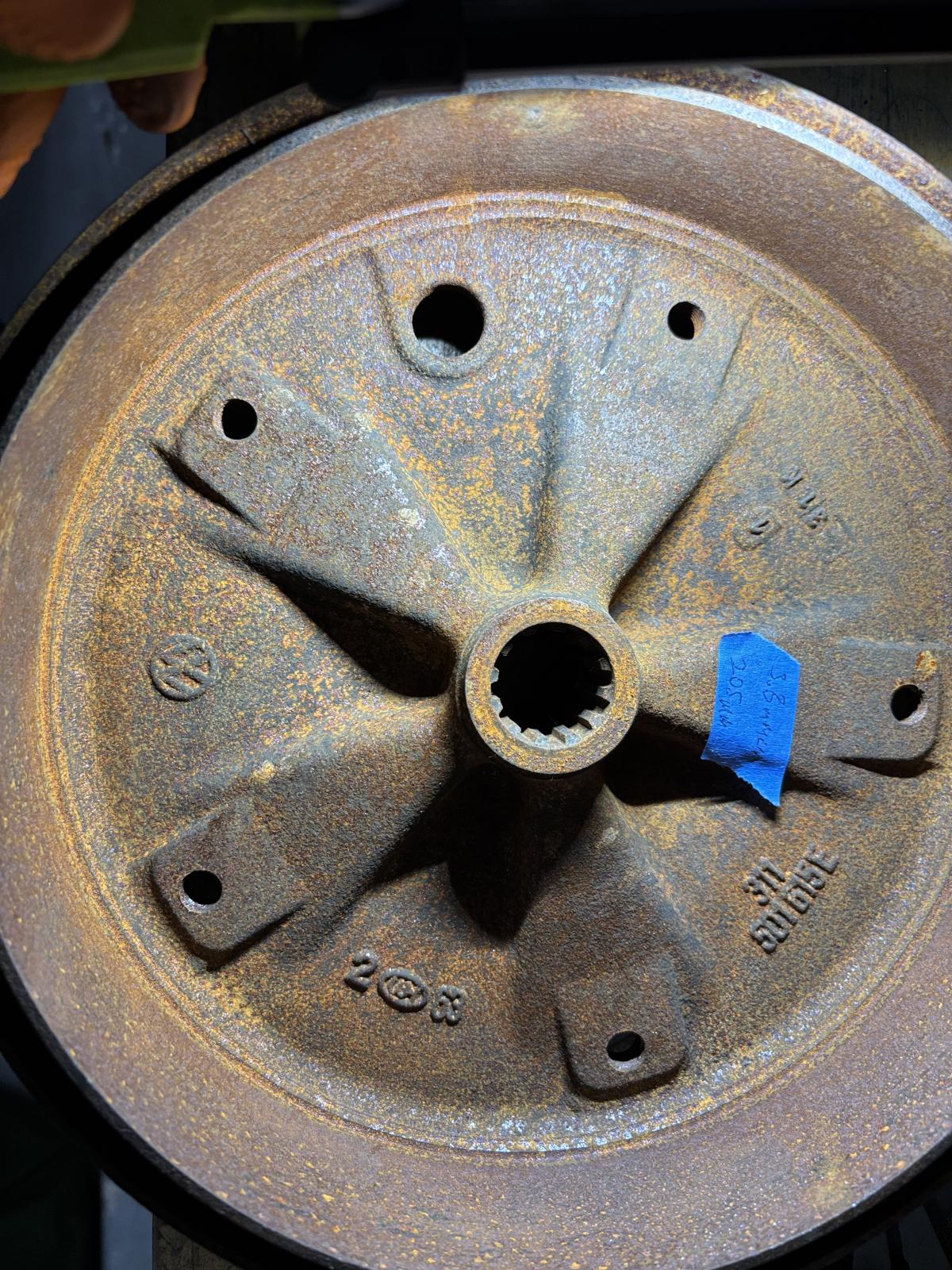

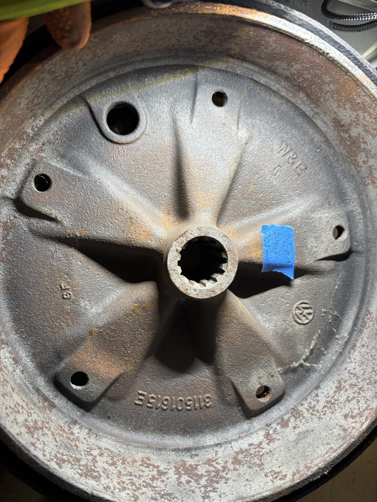

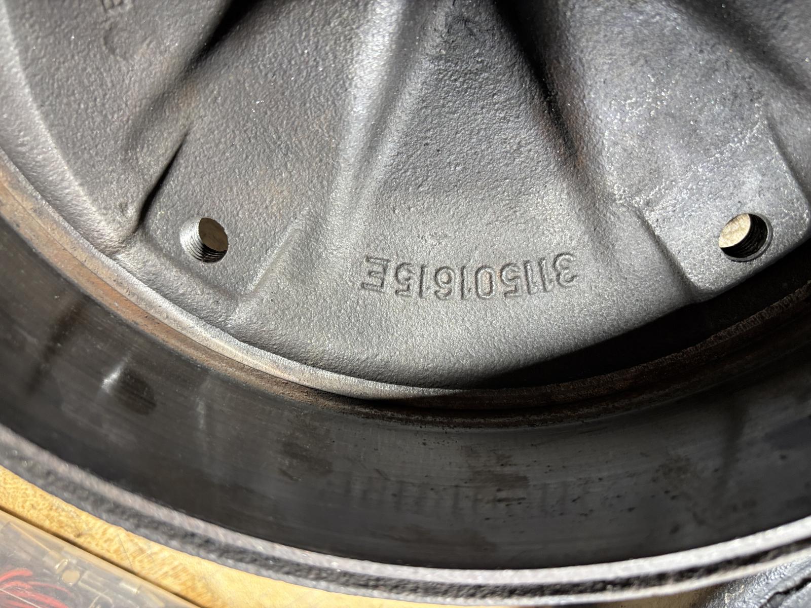

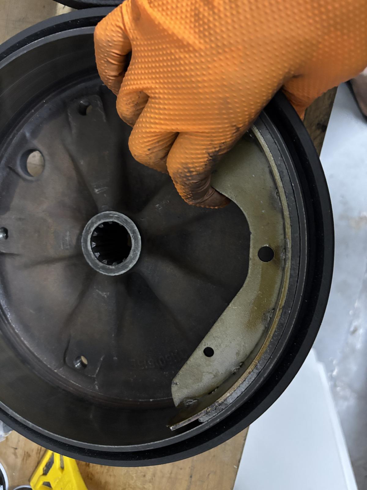

Well O’Reillys couldn’t do the drums because of the splines on the drum they said it would not work on their machine.
Picked them up.
One drum is thicker than the other.
This one has a wider inside diameter since the lip is thinner.
Shoe fits the arc of the good drum.
The same shoe does not fit the other drum arc.
This drum appeared to have been cut??
Type 3 rear brake drum.

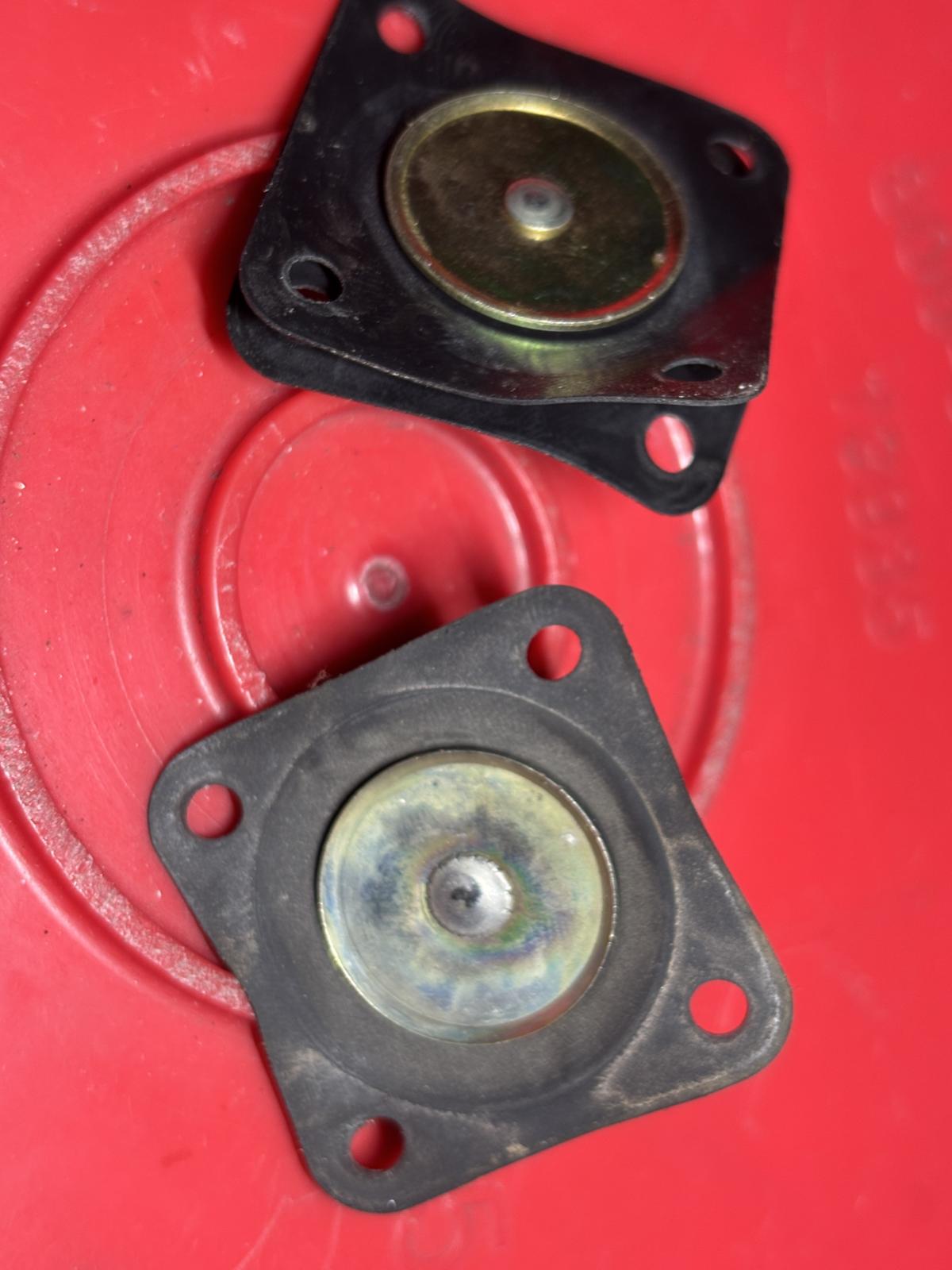

Eric&Barb wrote:
don.ville wrote:
First part from the rebuild kit I tried was the accelerator pump diaphragm.
The new part at the top has a strange double diaphragm. Mistake or different design?
Mistake, you could cut off most of the outer side rubber to turn that into a good part. With two it can not flex properly enough.
This can’t be a mistake. Shocked What are the odds?
I got this one from Amazon from a different manufacturer. This kits had more parts and included a fuel filter and floats.
The pump diagram also has a double gasket

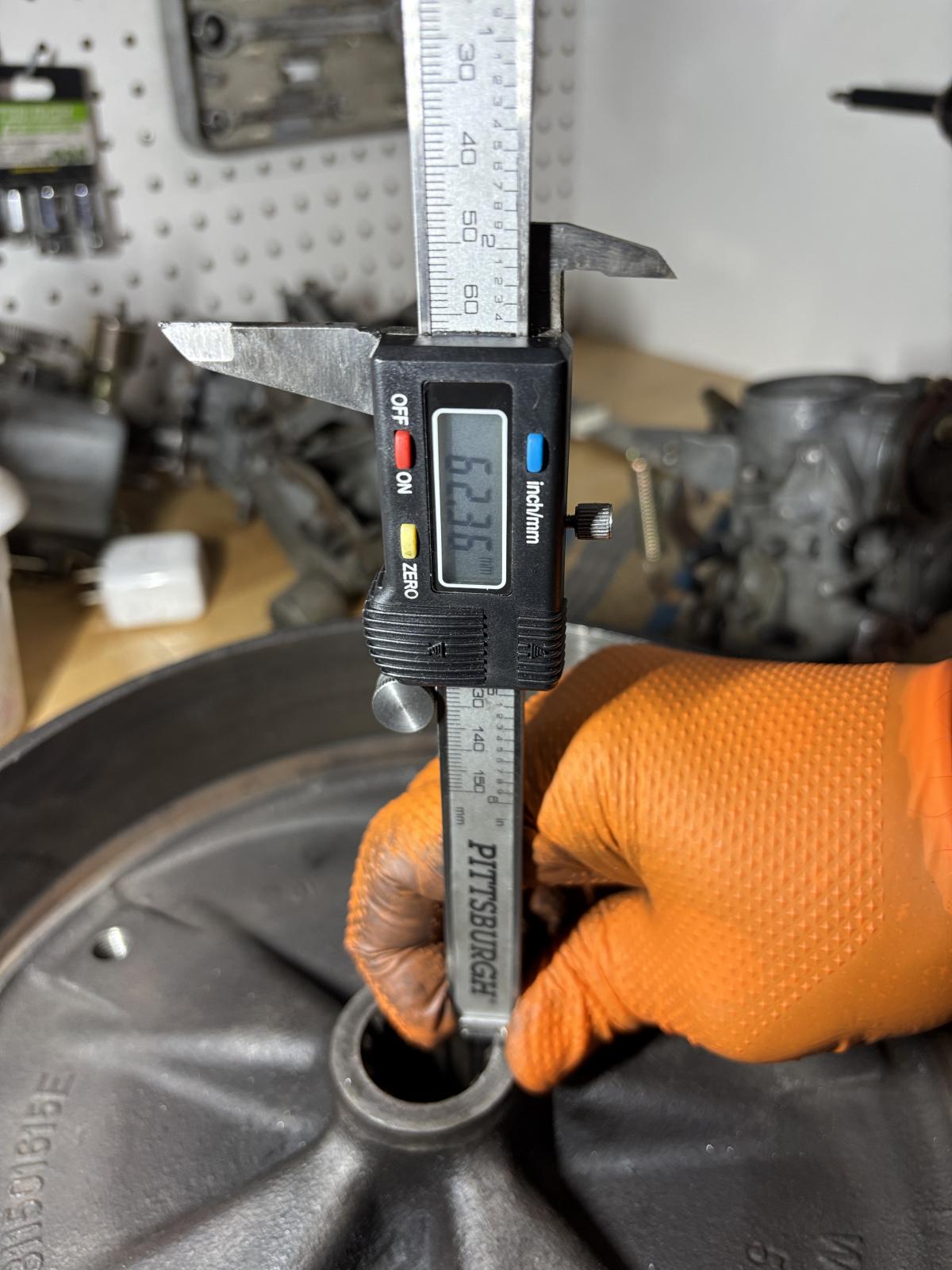

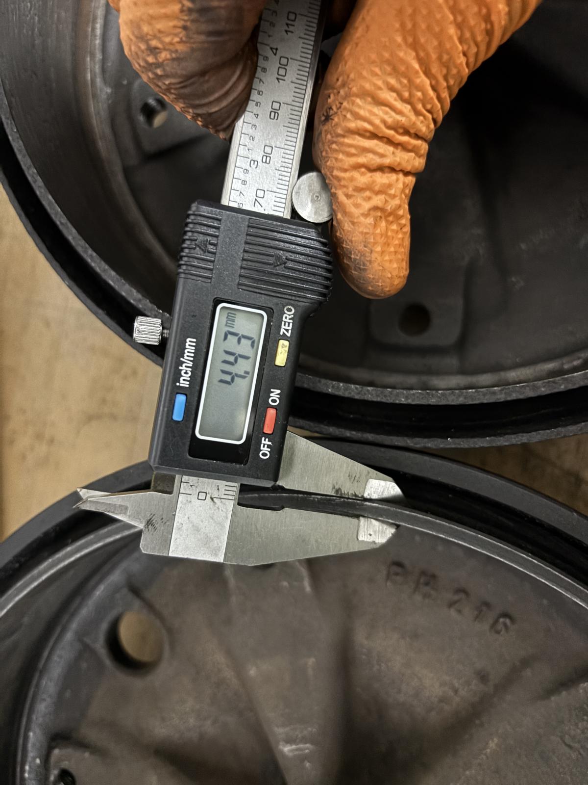

don.ville wrote:
Picked them up.
The diameter I'm asking about is from one side inside of the drum to the other inside of the far side of that drum.

PostPosted: Thu Sep 11, 2025 7:42 pm    Post subject: Re: 67 Standard Peach Kombi, West Palm Beach, FL Reply with quote
This is a 205mm drum from factory for a 63-65 Type 3.
My calipers aren’t that wide and the tape measure I have is not precise enough to measure wear between the drums

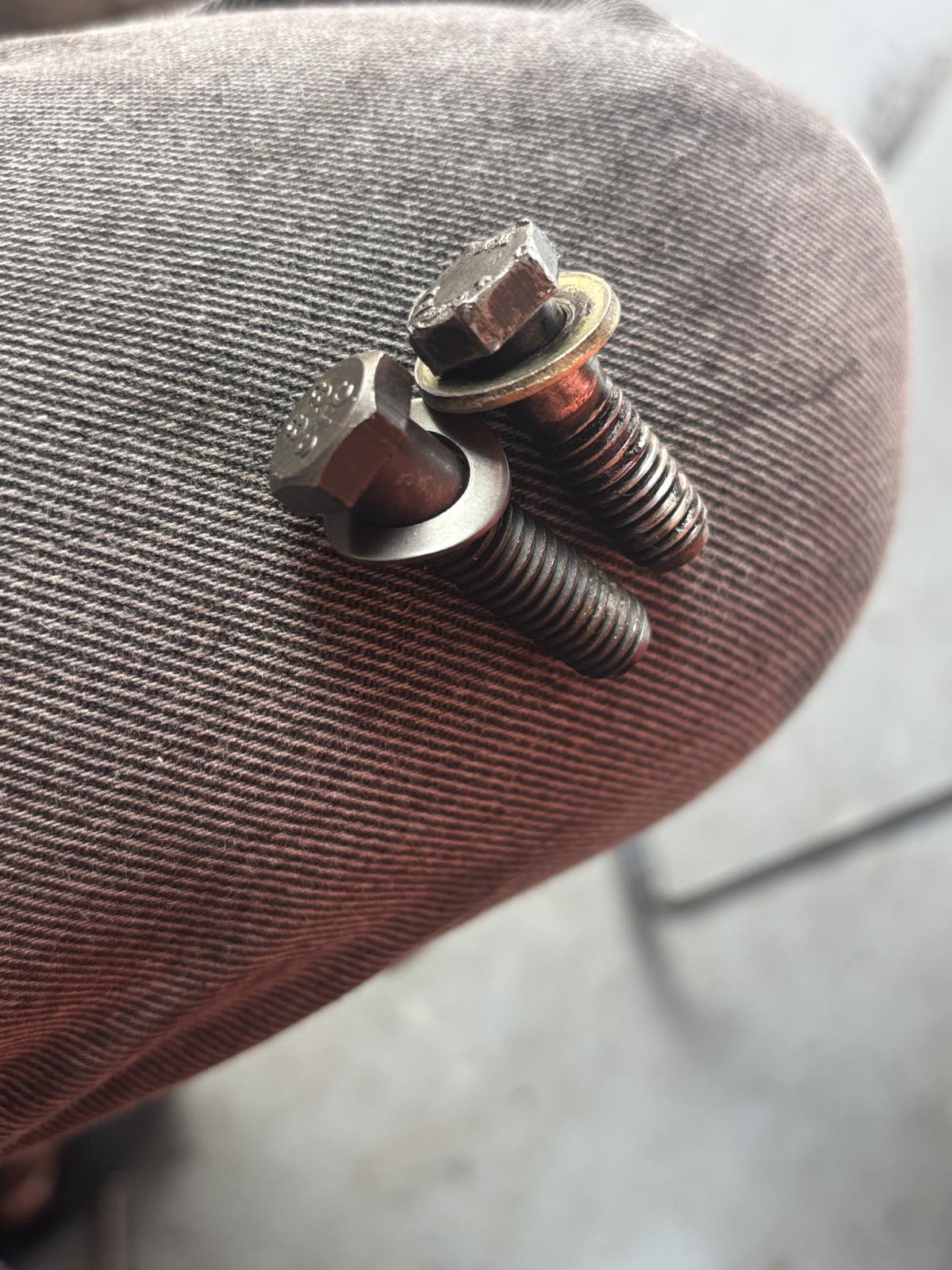

new bearing cap bolts and wavy washers, new emergency brake to backing plate mounting clip and bolt.

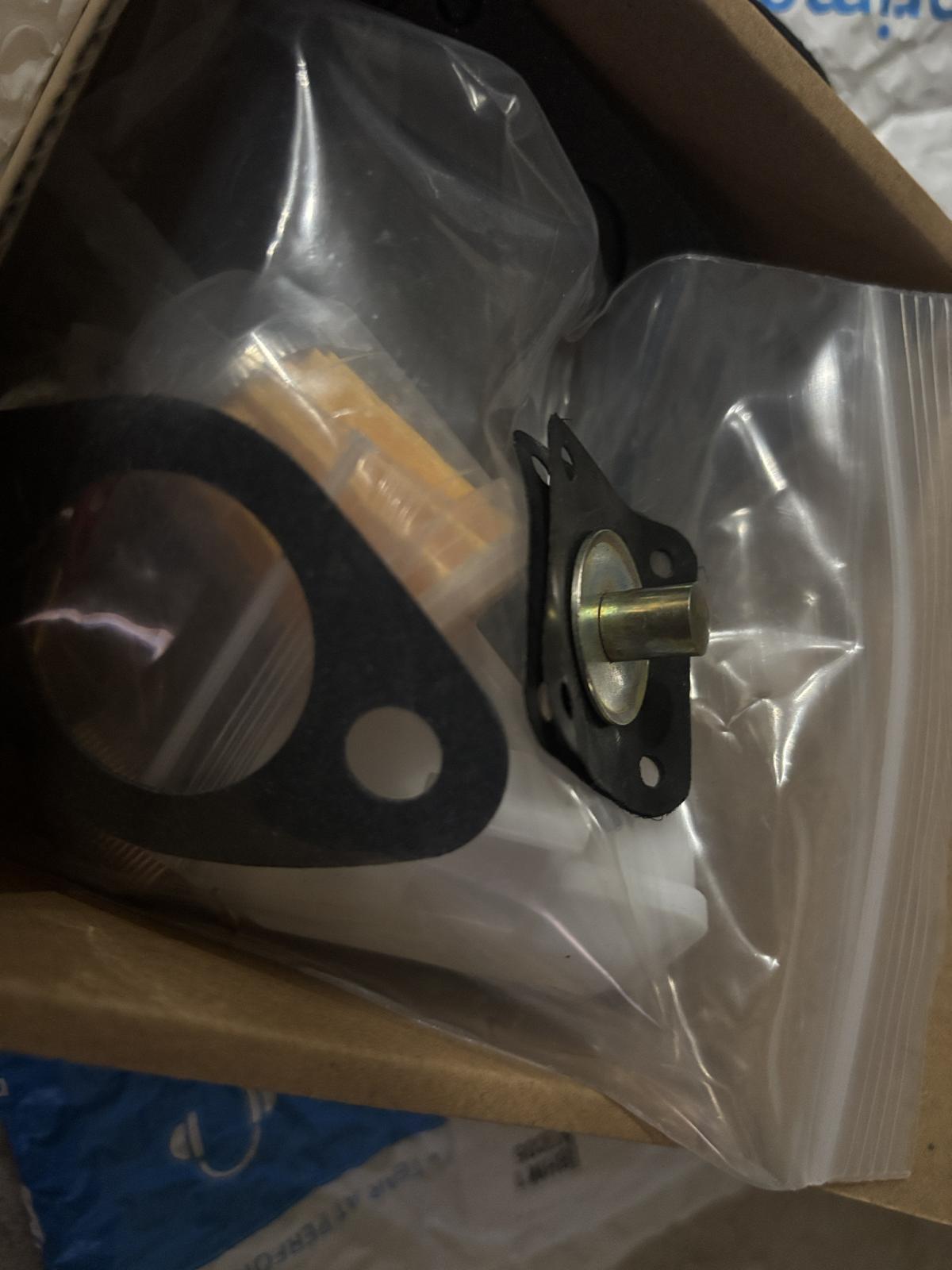

Did some carb swapping to make sure the spare carb that I drive around with will work when called upon.
New carb rebuild kit came with defective parts.
Created a thread
https://www.thesamba.com/vw/forum/viewtopic.php?t=806338

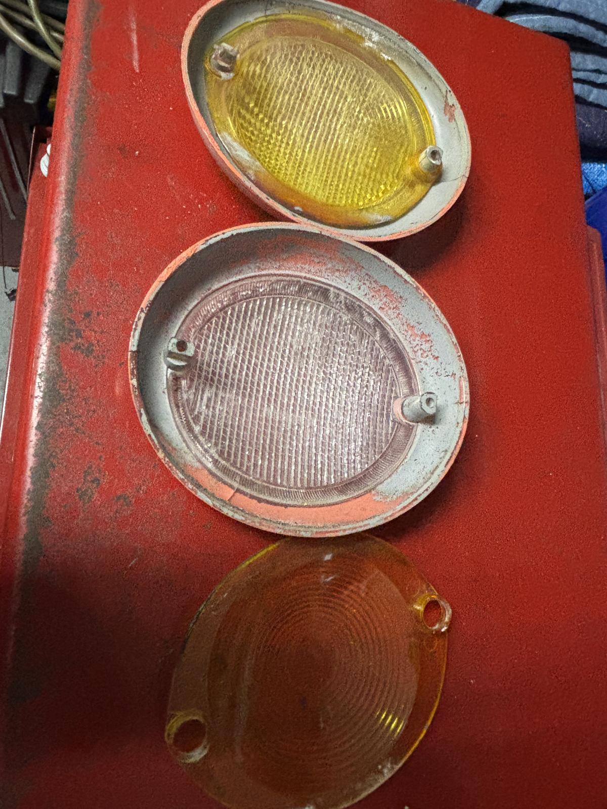

Brakes feel really good.
Moving on to other parts.

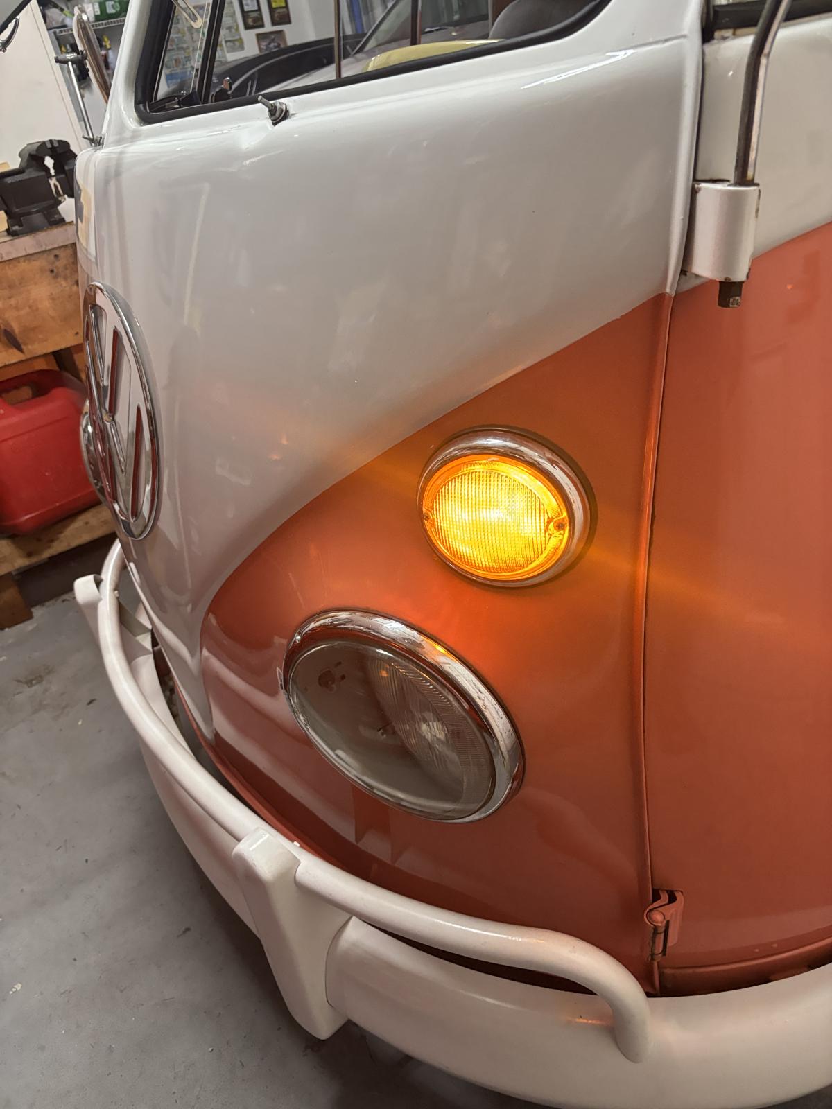

My fried egg turn signals are Hella old, time for an update.
I will skip painting the plastic chrome ring, looks fine to me.
Part was from CIP1

Eric&Barb wrote:
Check out this product advertised where the pic shows what looks like double seals on the rubber parts.
https://www.thesamba.com/vw/classifieds/detail.php?id=2560098

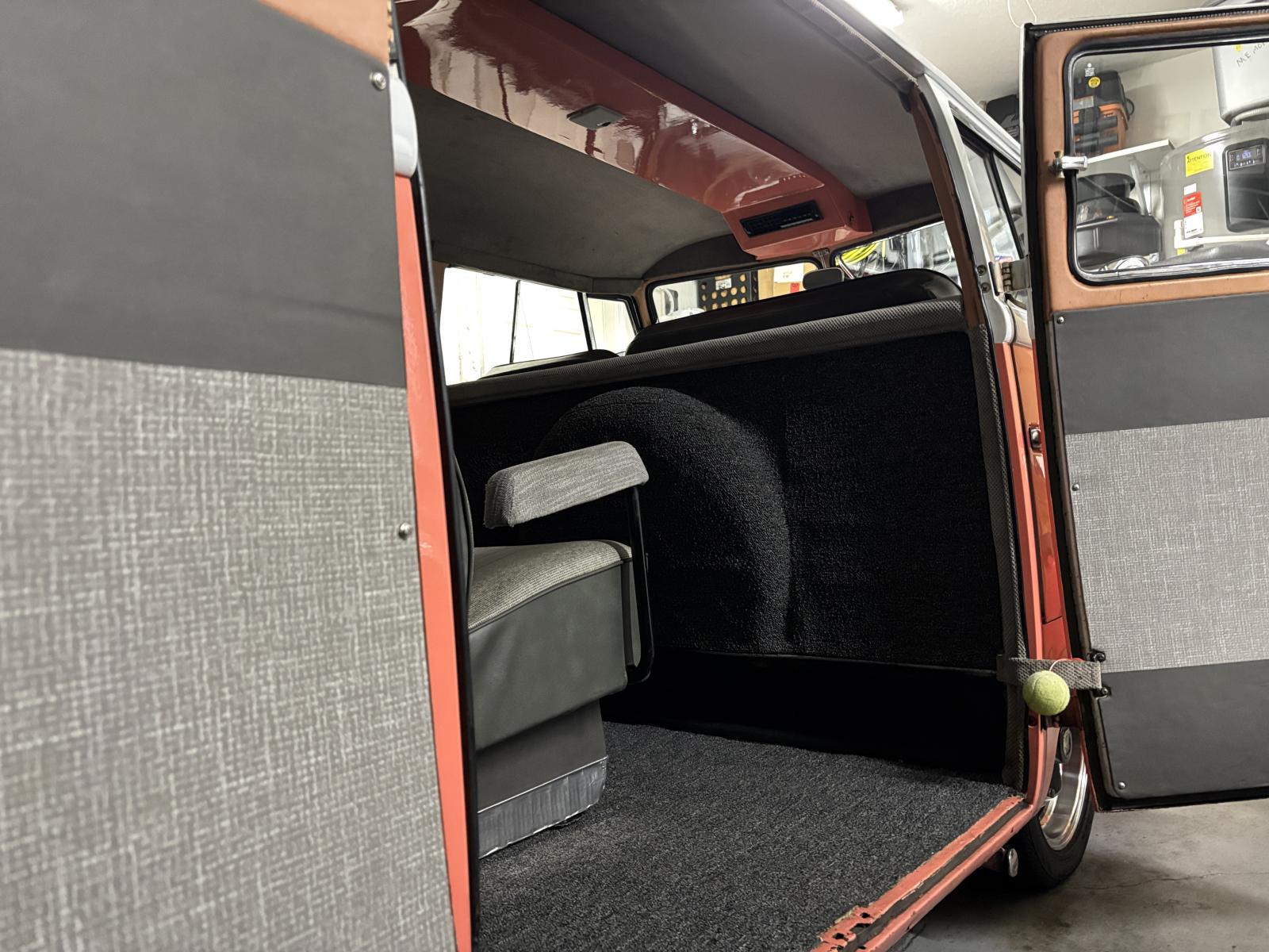

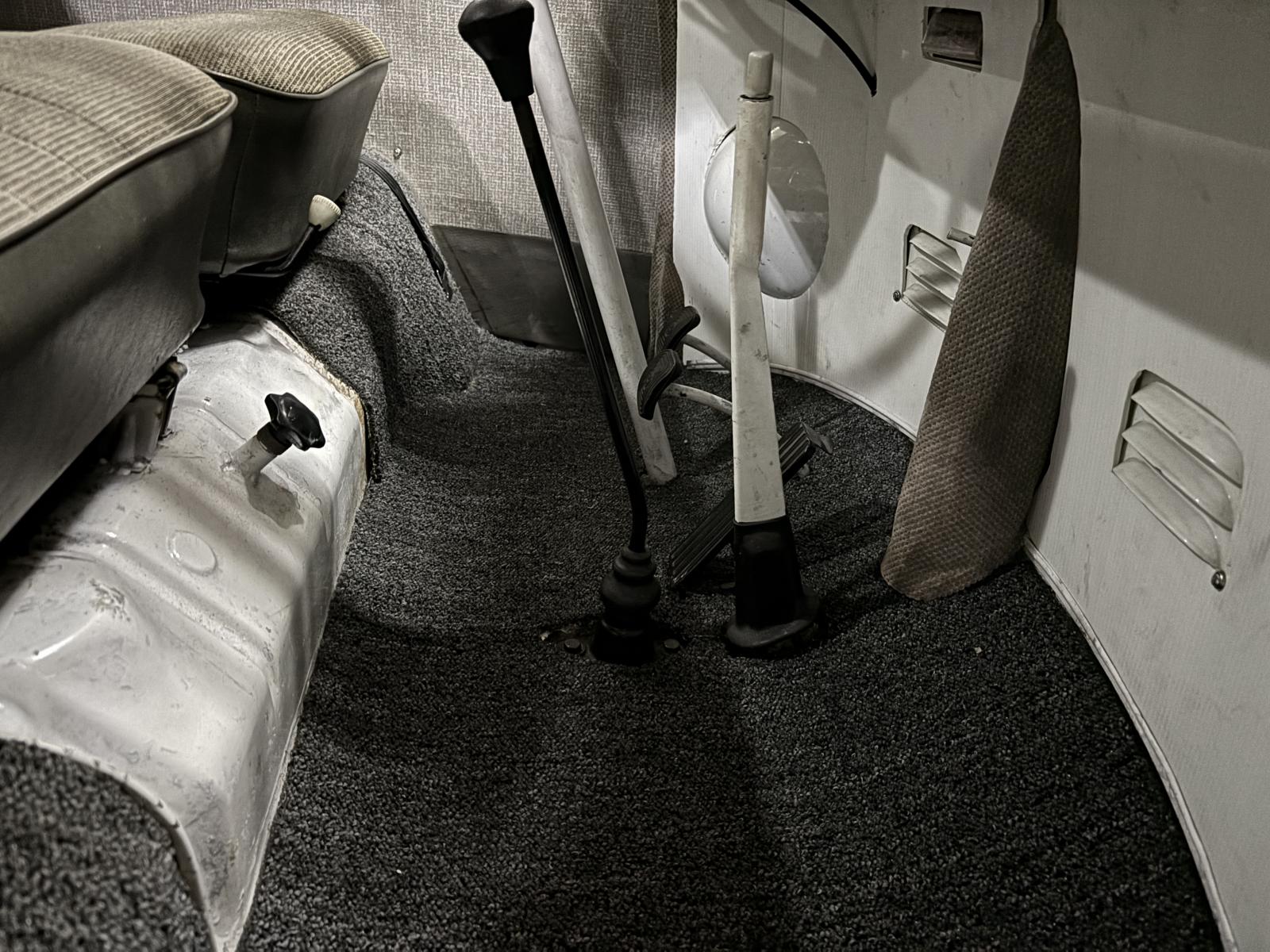

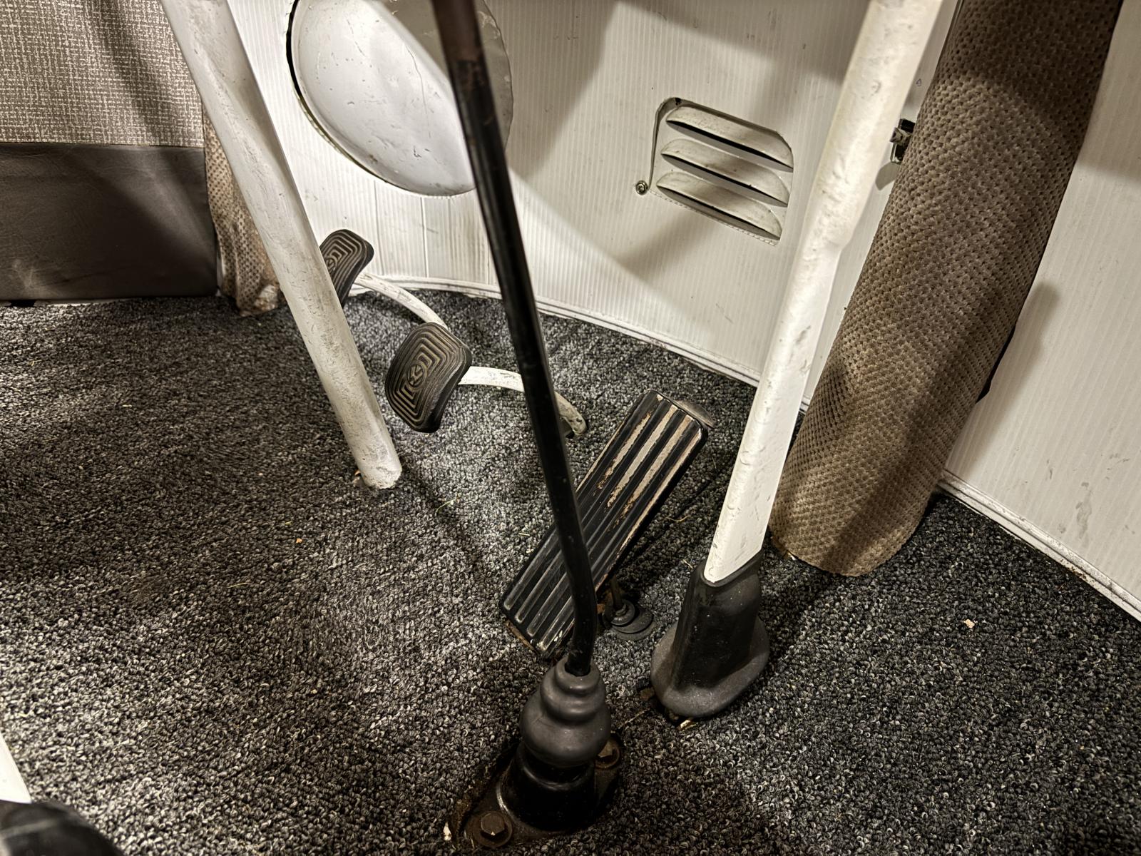

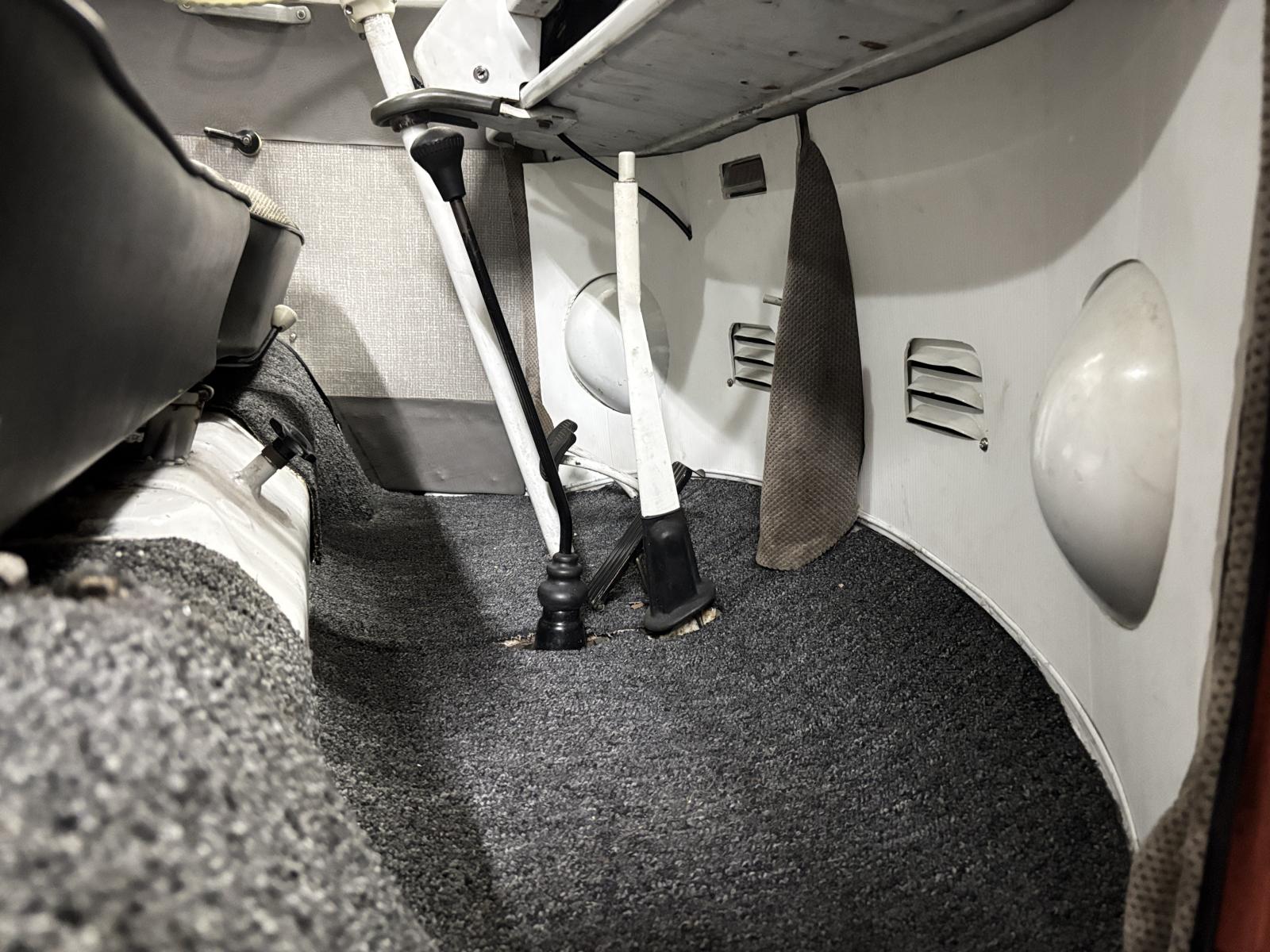

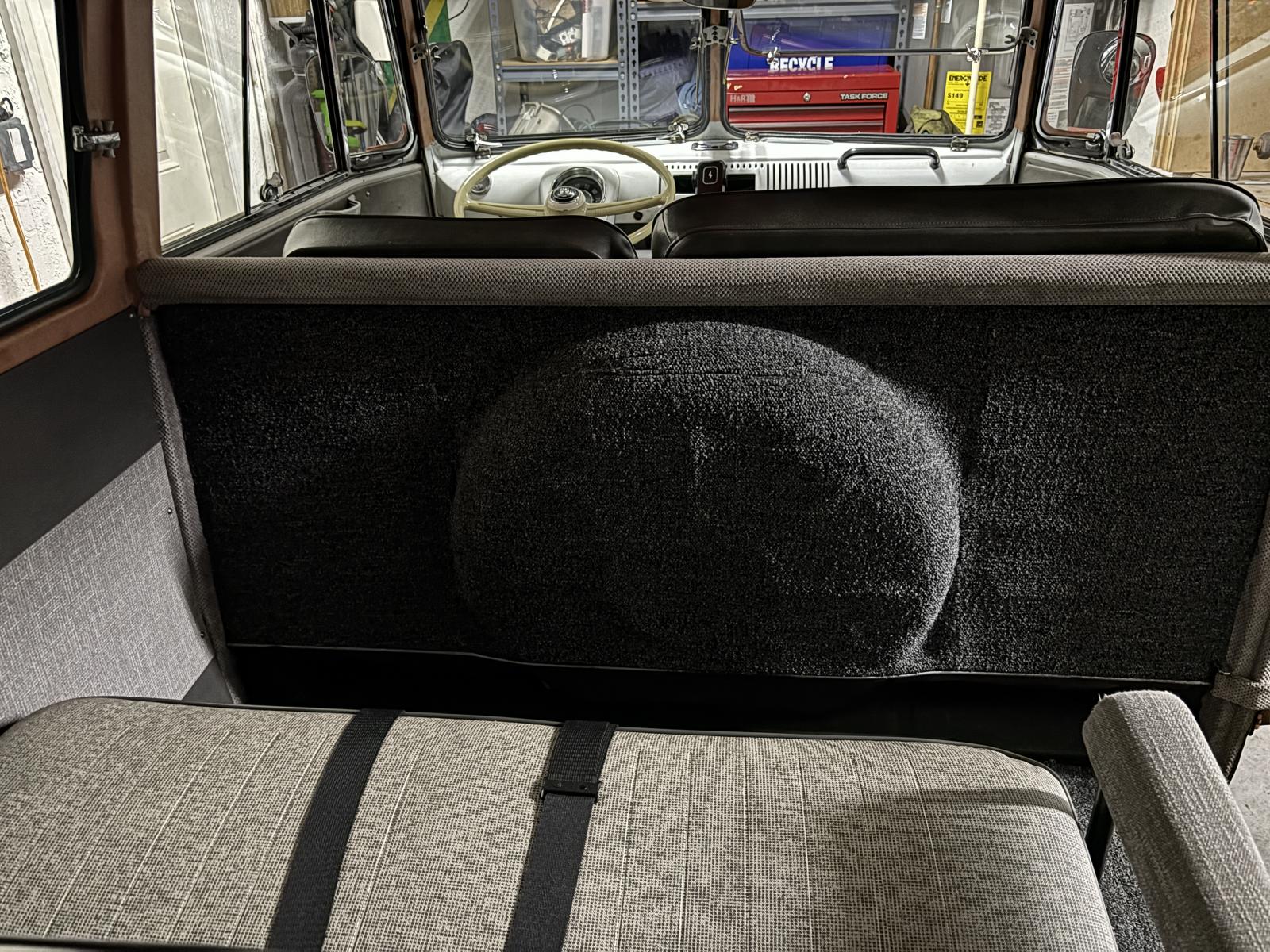

Random pics of interior with TMI seat covers and cheap home carpet on the floor.

BarryL Premium Member
Joined: November 01, 2004
Posts: 15439
BarryL is offline
PostPosted: Tue Oct 07, 2025 6:25 pm    Post subject: Re: 67 Standard Peach Kombi, West Palm Beach, FL Reply with quote
So nice. Good job.
What sequence of layers did you use on the seats?

PostPosted: Tue Oct 07, 2025 7:19 pm    Post subject: Re: 67 Standard Peach Kombi, West Palm Beach, FL Reply with quote
It looks great Cool

don.ville Premium Member
Samba YardMan
Joined: February 07, 2008
Posts: 2965
Location: West Palm Beach, FL
don.ville is offline
PostPosted: Tue Oct 07, 2025 8:37 pm    Post subject: Re: 67 Standard Peach Kombi, West Palm Beach, FL Reply with quote
BarryL wrote:
So nice. Good job.
Metal springs, carpet/fabric layer over springs, TMI custom fit sponges for each seat, then vinyl seat cover
