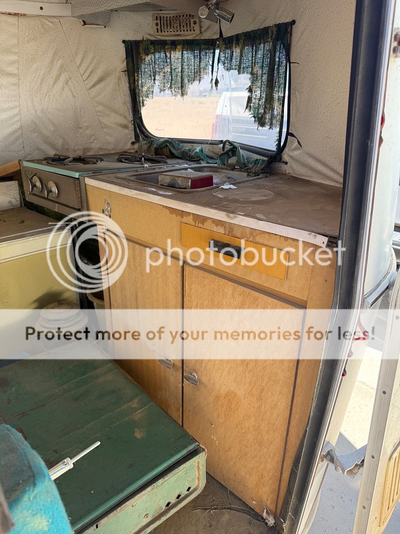

Here are some photos of the puck I just picked up. It’s in very bad shape.

Your puck looks like a diamond to me, very complete unlike mine. Looks like fun!

Wow! That thing is rough! It looks like literally everything needs to be done. But I’m glad you’re willing to put in the effort to save it. It will be a massive project, but worth it in the end.
Is the plan to bring it back to original, or are you going to customize it?
For parts, your best bet is EriBasar in Germany. They were so helpful when I didn’t even know which specific pieces I needed. Lots of good used parts as well as everything new you might need.
