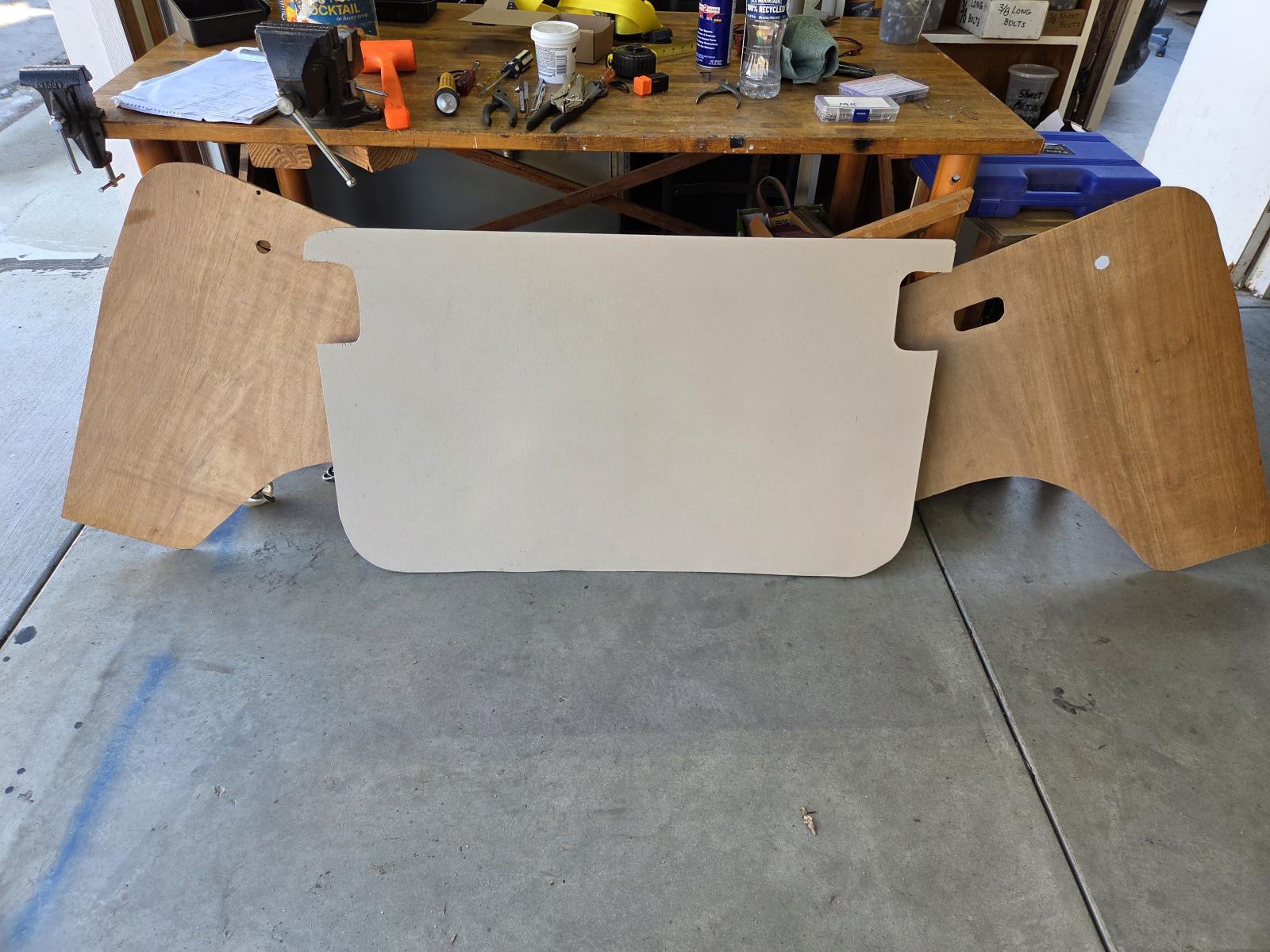

Sorry for the long delay in posting, There is still no delivery date for the EV conversion parts. To get an exclusion from tariffs the entire order must be shipped together as a 'EV kit'. The batteries are the long pole in the tent.
Thanksgiving and relatives got in the way of my hobby. Last post showed progress on converting the interior from shag carpet to minimulist transport. As a step back, 10 days ago thin wood side panels were ready for paint and the new rear ceiling was complete and painted.

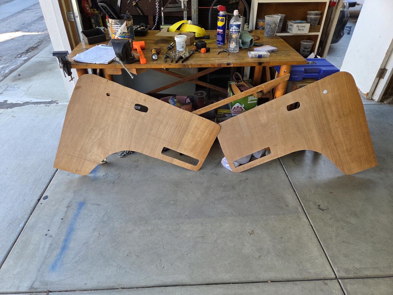

Still to be completed are the door panels: sliding, passenger and driver. I bought the bus without any panels. When I saw the price of original equipment door panels I almost sh*t a brick. I decided that 'minimulist' included painted door panels. This was aided by the fact that I am frugal (some say cheap) so I traded OEM vs my time to make door panels. Cheap won out in the trade. I made templates for the panels from taped-together thick paper by tracing the door outline.
I used the interior 0.1 inch plywood to cut out the panel. Too bad for me, I cut the plywood blank 1 inch too short for the passenger and driver door shape. Yet another trip to home Depot. The photo above shows the problem at the bottom of the door panel. Below is a photo of the plywood passenger and driver panels after cutting them out from a 4x8 sheet. Yes they are mirror images. VW is no fool for production costs.
I used the same method for making a sliding door panel. I did not spend the time to look at how the OEM parts delt with the protuding door latches front and rear. Instead I ask myself "what is easist solution?" So I cut out around the door latch mechanisms Below is a photo of the resultant door panel, painted and ready to install. The light tan color will be used on the rest of the interior.

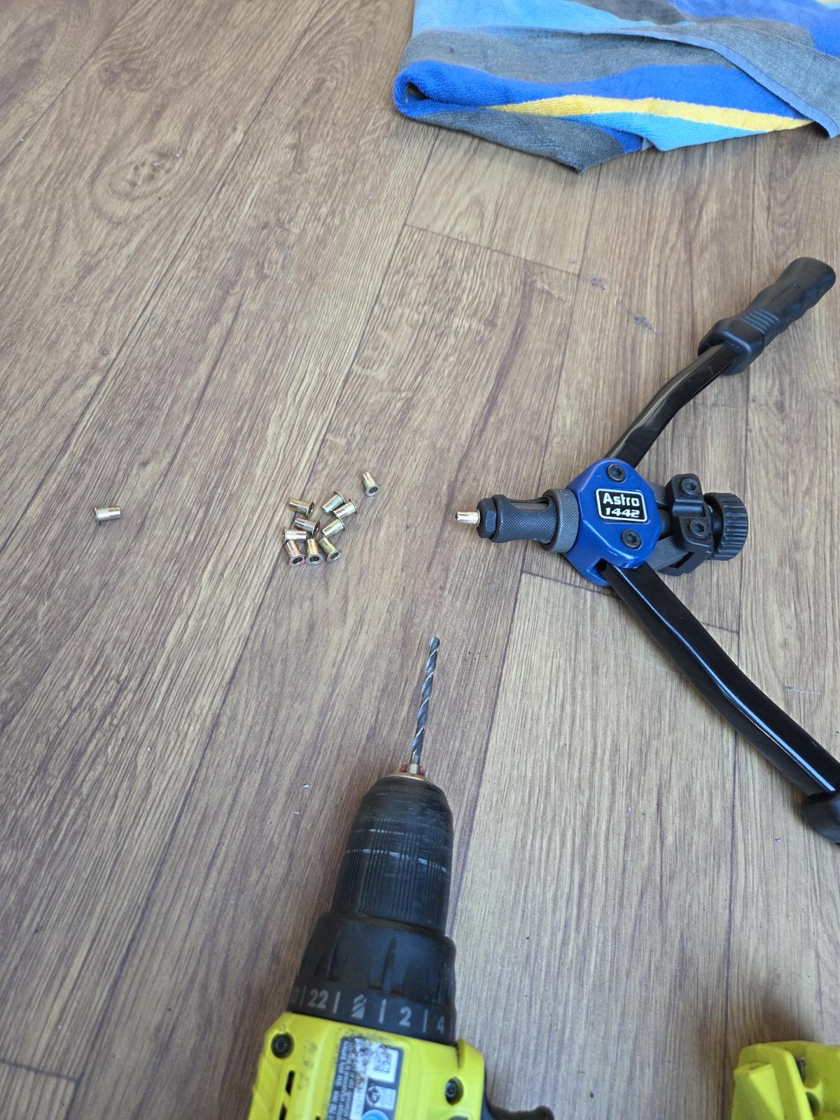

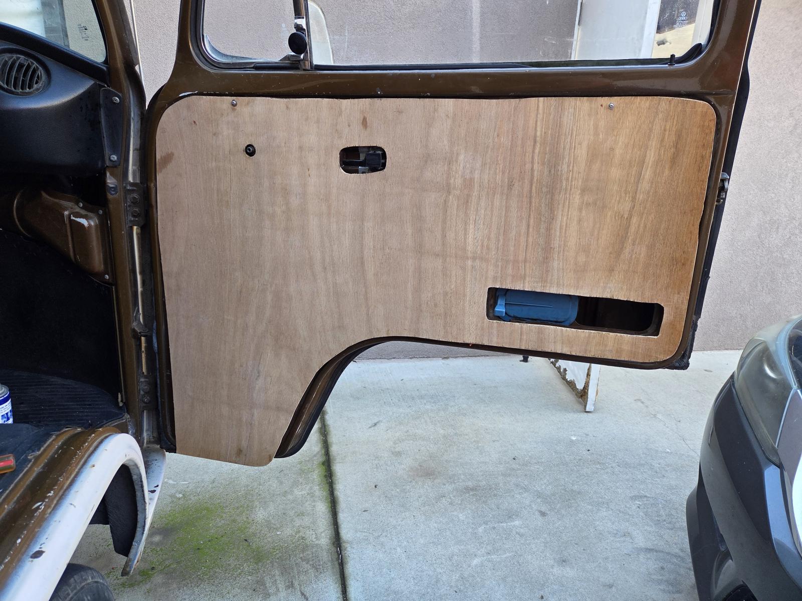

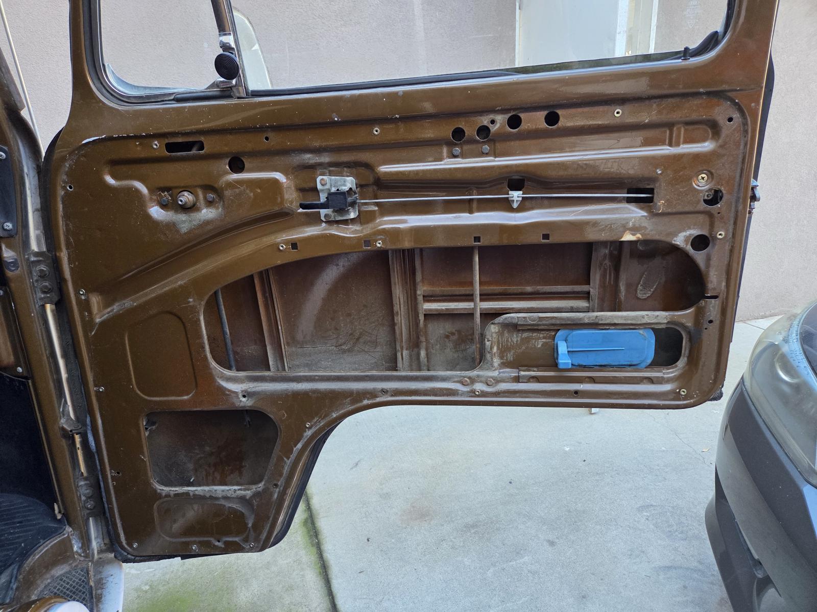

The door panels are going to be installed using 4mm screws and rivnuts in the door upolster holes. Rivnuts are similar to the plastic wall inserts used to hang pictures, but are rivited unto the door sheet metal. A Rivnut was installed in everyother hole, and on each corner. The revnut insertion tool is shown below.
The passenger door frame is seen below. Look carefully and you can see the 13 rivnut installed into the door. The passenger door panel was then test-fitted into the door. Two 4mm screws at the top hold the panel in place. This locates the panel so the other screw hole can be located and drilled.

I’m a fan of rivnuts, but it’s gonna be a real pain for the next person to get those out. I usually self tapping screws with finishing washers to attach wood panels.
