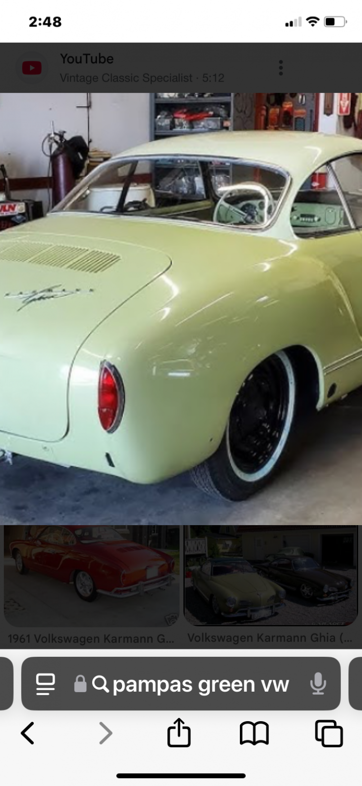

Looking to paint my 67 westy soon. Using SPI products. I have the epoxy primer and 2k primer. A few local painters recommended going with a single stage top coat vs the base and clear method. I have done all the metal and body work and have sprayed primers before. Im looking at a Pampas Green with color change at belt line.
Any thoughts? Spray upper half then lower half?
