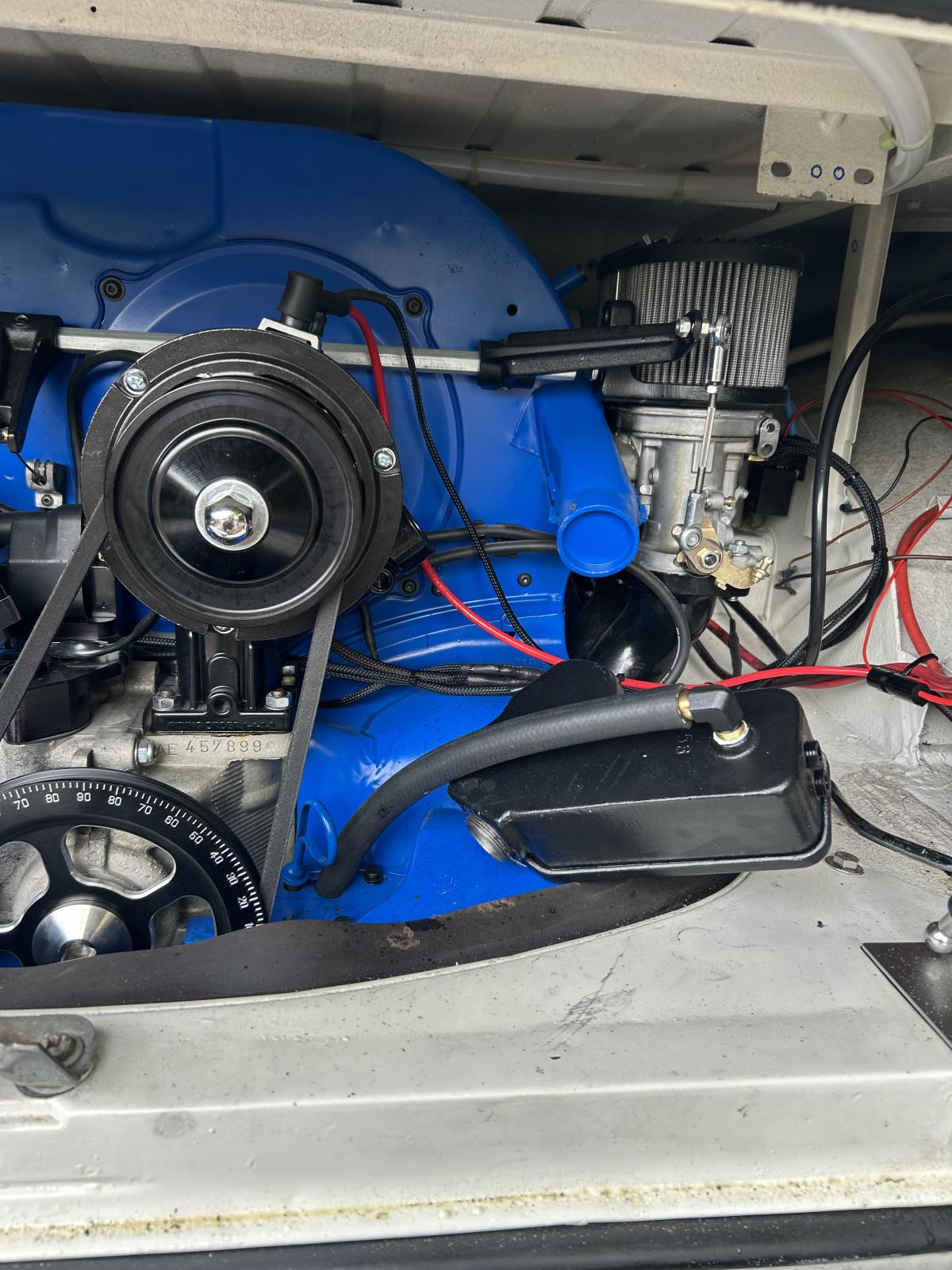

Anyway, exited the bus, and could see a small pool of oil from below the filter, but worse than that, on opening the hatch, found this

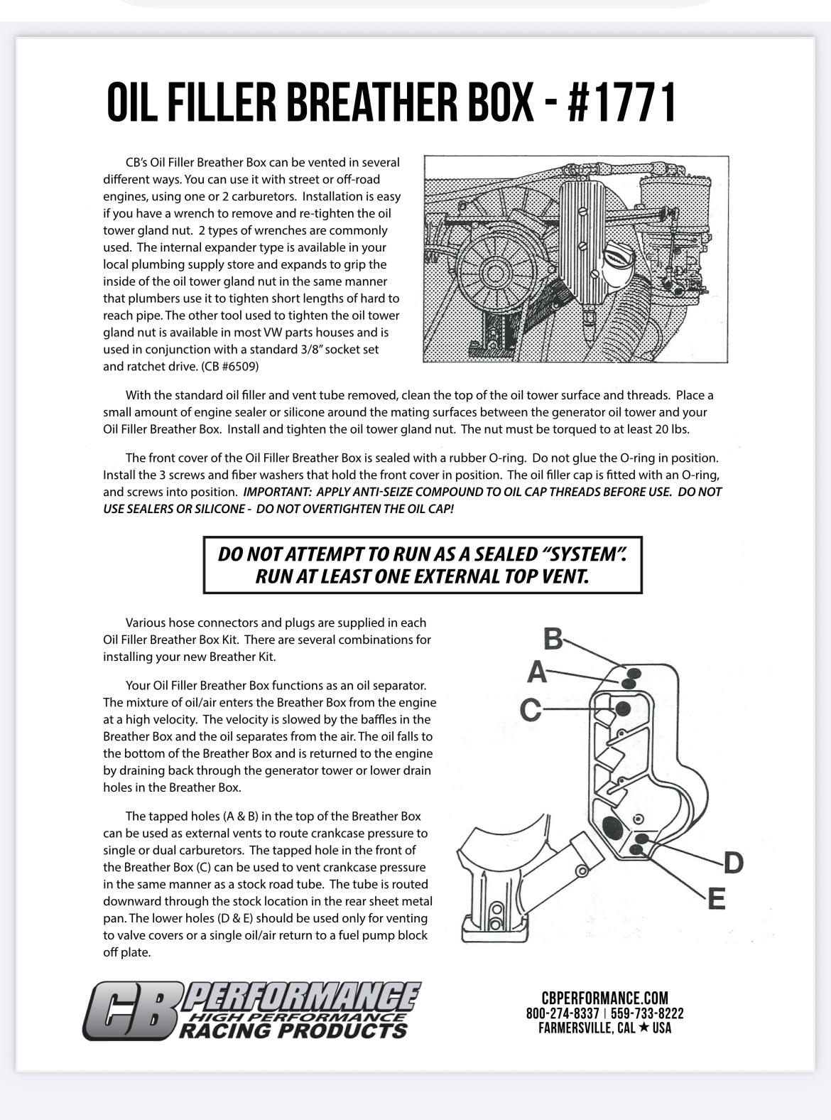

I had fitted the CB Oil Breather/Filler tower, and it looks like it has just come loose ? I fitted it using the special tool, but here lies my question ? Do you guys use Loctite or something to ensure this doesn't happen ? I know that sometimes the tool is a bit sketchy, and should of bought one of those 'inner' pipe wrenches probably ? I am using the vent 'C' to a road
draft tube for pressure relief

Wow, that sucks , but luckily you got it in time.
I've installed a dozen of them and never had a problem. Never used thread lock either.
I've seen someone, maybe csp make a glandnut that has a large hex opening. It comes with a matching male hex tool that is driven with a 3/8 ratchet. _________________ Glenn
