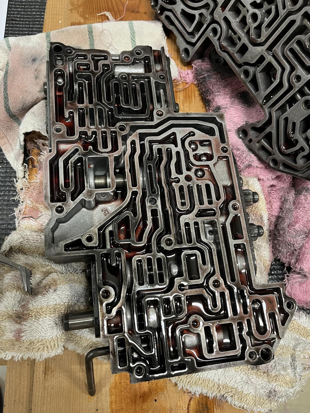

PostPosted: Thu Nov 13, 2025 7:00 pm    Post subject: Re: Official lazy person's stupid question thread Reply with quote
Might be a stupid question, but to clean the valvebody in a transmission, what do you clean if with?
I’ve read to use brake cleaner. I’ve read to not use brake cleaner. Not to use rags (lint), then to use compressed air to dry.
Sorry to ask stupid question, but first time in the tranny, and going slow.
I haven’t gotten into the valves yet, just observing the cavities where the balls are, and want to clean it before starting on the valves
'90 Multivan Westfalia
AndyBees
Joined: January 31, 2008
Posts: 2684
Location: Southeast Kentucky
AndyBees is offline
PostPosted: Thu Nov 13, 2025 8:30 pm    Post subject: Re: Official lazy person's stupid question thread Reply with quote
I've rebuilt two VW 010 automatic transmissions. Both of them were a success.
I did the work at my uncle's garage. While I was working on the first one, a guy dropped by to see my uncle about a VW part. He walked back where I had parts laying on the work bench. He said he was retired from the Ford Transmission Division in Norwood, OH. He said, "we used WD-40 when assembling transmissions." So, that was what I did.
As for cleaning, I used Mineral Spirits mixed with Kerosene. I used several different brushes to knock loose the brown/black stuff. Once I finished up with the cleaning, I rinsed the parts with clean clear Kerosene.........
Now here's where everyone will go crazy. The next thing I did was use Dawn Liquid, water and a brush. Then, I rinsed and rinsed with water followed with lots of compressed air.
As I said, those rebuilds were a success.

PostPosted: Thu Nov 13, 2025 9:11 pm    Post subject: Re: Official lazy person's stupid question thread Reply with quote
All good,, but I'm really partial to 'Joy'. Joy cleans and degreases way better than Dawn...
fxr
Joined: December 07, 2014
Posts: 2684
Location: Bay area CA
fxr is offline
PostPosted: Thu Nov 13, 2025 9:26 pm    Post subject: Re: Official lazy person's stupid question thread Reply with quote
Kerosene then Simple Green for me.

PostPosted: Thu Nov 13, 2025 10:59 pm    Post subject: Re: Official lazy person's stupid question thread Reply with quote
Simple Green, Awesome, and anything similar will etch aluminum if left on very long. You should follow with Dawn, Joy or something similar to breakdown the Simple Green.
Simple Green definitely breaks-up oil and settled baked on crud.
Also, I thoroughly pressure wash the outside of the transmission and blow dry with compressed air before opening it up.
