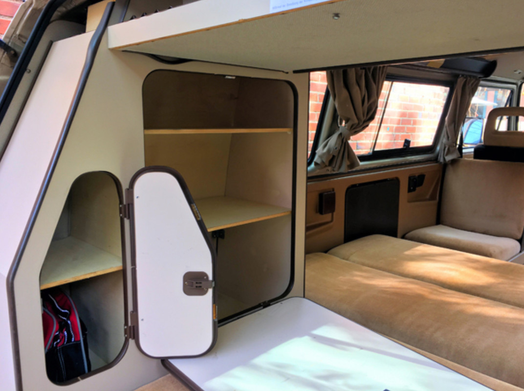

I want to add a side door like this image. However, I need your thoughts on if the door should open towards the front, the back, or sliding.

Weekender-style FTW. It’s the only option that makes sense to me… Cool

If I were doing that mod. I'd want the hinge toward the front of the van.
Otherwise you'll either need to empty out the rear of the van or access the door over the rear seat/bed to get to things in the proposed closet.
I didn't vote. Wink

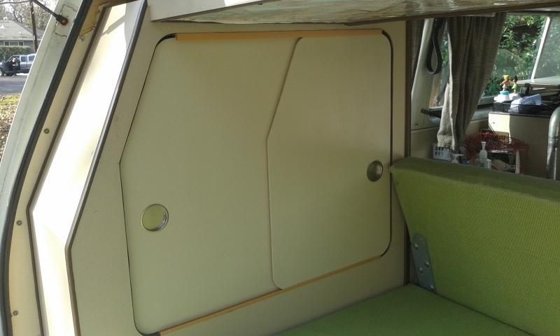

Have you considered the sliding door variety that someone made?
Any swinging door is in the way one way or another.
Someone else made the rear table top a lift off door.
A door most of the time, and the door lifts off and mounts to the rear table leg.

Member Campism did the first mod - here's what I did:
https://www.thesamba.com/vw/forum/viewtopic.php?p=8621856#8621856
The advantage of the sliding doors is that you can get to all the cupboard without moving all the stuff that might be sitting above the engine. Even if you decide to have a conventional door, consider having the front lower shelf as a tilting shelf so you can get right down to the metal floor and store quite tall things there. Spare gallon of water perhaps, Zodi water heater, whatever.

WOW. I like the sliding door style. Solves several potential problems concerning access.

Kinda depends on what you plan to keep in there and how the van will be configured when you need access.
Hinge to front = can’t access from the bench seat.
Hinge to back = probably more useful than hinged at front.
Hinged ANYWHERE = can’t access while you’re in bed or with thick bedding in place.
Sliding = the best option imo but doesn’t look as factory made.
I only keep bedding and the Westy curtains in that space so the he stock door works perfectly and I’d hate to do an unreversible mod if it didn’t benefit me

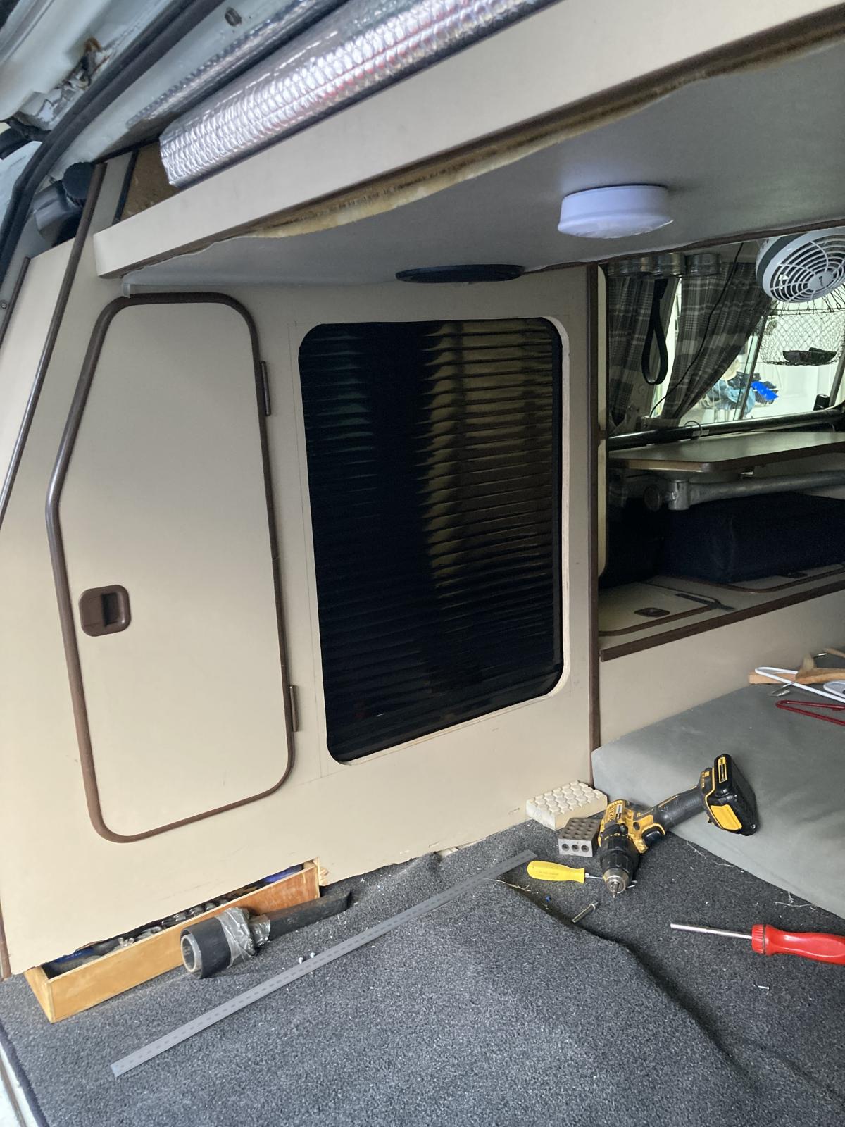

Another option, a rollup tambour door

Thanks for the props but I copied Frank Condelli's mod. He's the originator, as far as I know.

Although its our DIY Cabinet and not stock , I elected to use sliding doors just for the reasons listed above. Nothing in the far back is generally in the way with the slider option. Even when carrying a bunch of stuff back there on a trip, we still have sneaky access to the cabinet unless the item in the cabinet is really big like a 5 qt oil bottle.
The oil bottle lives on its own dropped sheet metal shelf/support compared to the rest of the plywood shelf.

If I were to do this again I’d lean towards the sliding doors.

From what everyone is saying. I think I will go with the sliding door system.

fxr
Joined: December 07, 2014
Posts: 2684
Location: Bay area CA
fxr is offline
PostPosted: Fri Nov 07, 2025 10:42 am    Post subject: Re: Closet side door question Reply with quote
RicMcK wrote:
Hey FRX: Where did you get the formica sheeting for the new doors, or did you just paint them?
The doors are 5mm / 3/16" plywood, painted with Krylon Almond Satin rattle-can paint to match the early brown interior.

Very timely poll here. I just received this tambour door I ordered. It was stuck in customs for awhile and the price went up because of, well you know! But its this weekend project I hope.
https://www.ebay.com/itm/304195614545?_skw=tambour...BMmNSP98tm

PostPosted: Sat Nov 08, 2025 5:41 pm    Post subject: Re: Closet side door question Reply with quote
Got the tambour door installed today. Think it’s going to free up a lot of underused space in the closet cabinet.
Still have to build a shelve to optimise the space! And trim the exposed plywood.

Can you please try to post a photo of the inside (down) and what I looks like when it's rolled up (inside)?
