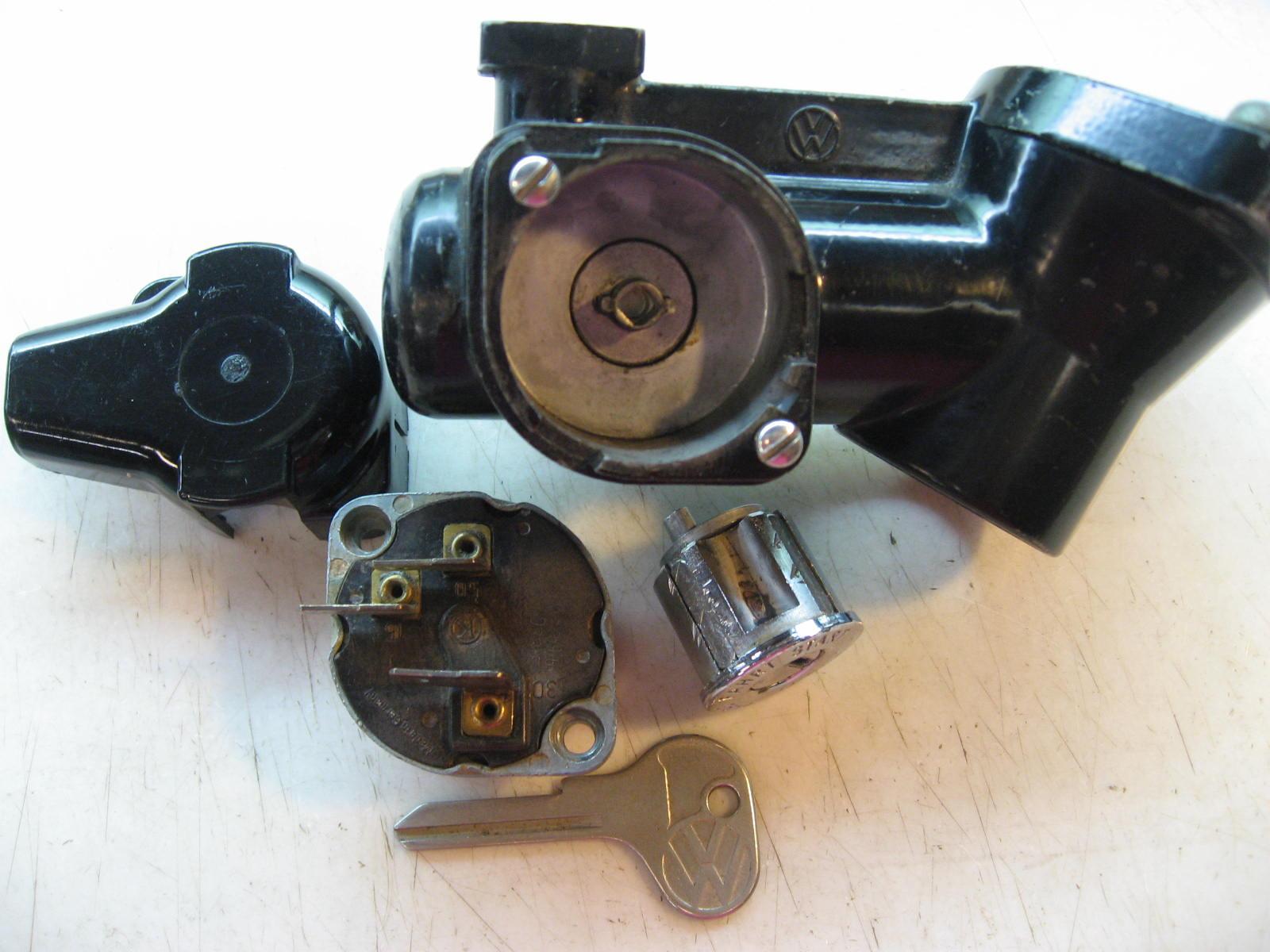

The last things to do is examine the actual steering lock housing.
There isn't a lot that can be done to the steering column locking apparatus as it is assembled at the factory. This is the right side where the key lock barrel goes that does all the rotating and pulls the pin out of the column to free the steering wheel to unlock.
Mine I cleaned up inside with pipe cleaners. A little grease can be daubed on the guts.
The left side controls the electrical ignition switch.
This part interfaces with the lock.
The switch can be opened but I don't advise it as the four tabs break off since the housing is pot metal.
This is what is inside. It has a follower plate with three contacts: 30-power in, 15 coil on, 50 solenoid start. The mechanism has an anti-restart so the starter can't be forced into the flywheel.
This old one was pretty worn away where the current had eaten away on the start contact.
Short of the key saying "Neiman" on it I'm not sure what the make of these contraptions is. The black body has a VW emblem. The lock barrel has no name but uses a "Neiman VW" key. The electrical switch has a circle with "K" and "L" inside.
If anyone knows more post up.

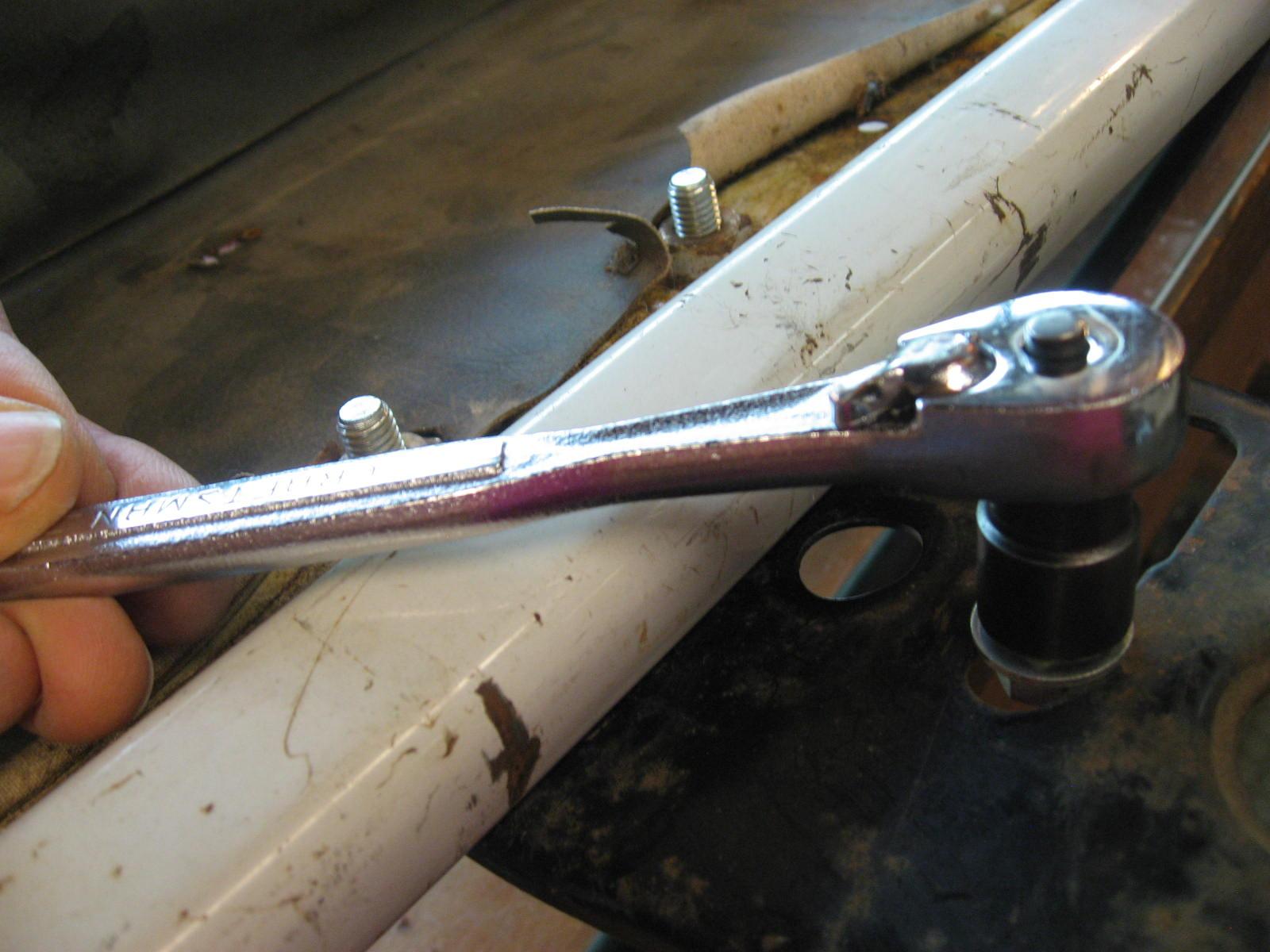

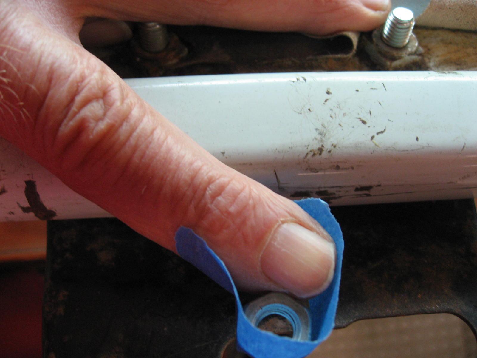

To remove or install a steering/ignition lock you have to pull the steering wheel and turn lever etc. Best place to see all that is in The Bentley 1963-1967 Manual section V9 page 1 and 2.
First thing I do is take off the ground bolt at the battery cable. There are a lot of hot wires that are easy to spark behind the pod.
On mine I found that the bolt method was too frustrating unless the speedo is out. I put an exhaust stud on mine which gives you something to grope for.
The washer and nut I do with them individually taped to my finger. The nut takes a few tries but eventually it will hang on the top thread.
Then I use this 1/4" drive ratchet and socket by feel. For the first part of the threads I have to lift off the socket and move it but eventually I get to use the ratchet. You can purposely bugger the threads with plier bite to help the ratchet start sooner.

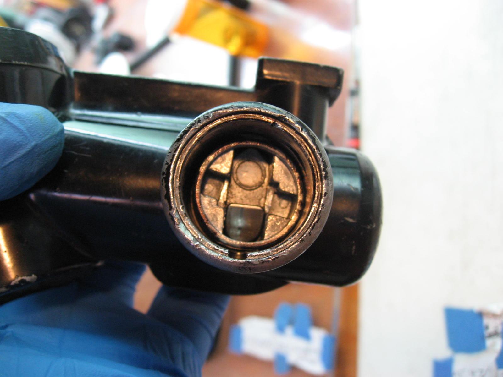

Anyone know if or remember how to take this apart?
The front submarine looking snout thing (on the right in this photo) has a seam that looks like the factory put on that cover last.

PostPosted: Sun Nov 21, 2021 8:34 pm    Post subject: Re: Neiman steering lock - no key Reply with quote
After removing the electrical portion (on the opposite side) you can push it out from the electrical side. Get a small screwdriver/punch and it just takes a few gentle taps, it’s easier if you push the locking pin in a little from the column end.

PostPosted: Tue Nov 23, 2021 7:17 pm    Post subject: Re: Neiman steering lock - no key Reply with quote
schnidlee wrote:
matthew henricks wrote:
I am pretty sure that these parts can be removed too. I know i have done it but for the life of me i can't remember the details. The spring loaded wedge gets depressed and then you can turn the assy and it slides out. I had one where the interface bar to the electrical assy was broke and i figured i had nothing to lose so got it apart. (and back together again...)
Thanks for the encouragement. You guys are right. schnidlee held my hand.
This is the lock position (halt)
You have to turn it 90 degrees either way.
Then push from the other side.
The guts come free.
Lo and behold they pop out.
Now I don't want this part to fly apart until tomorrow I can study it.
This part stays in and was factory installed.

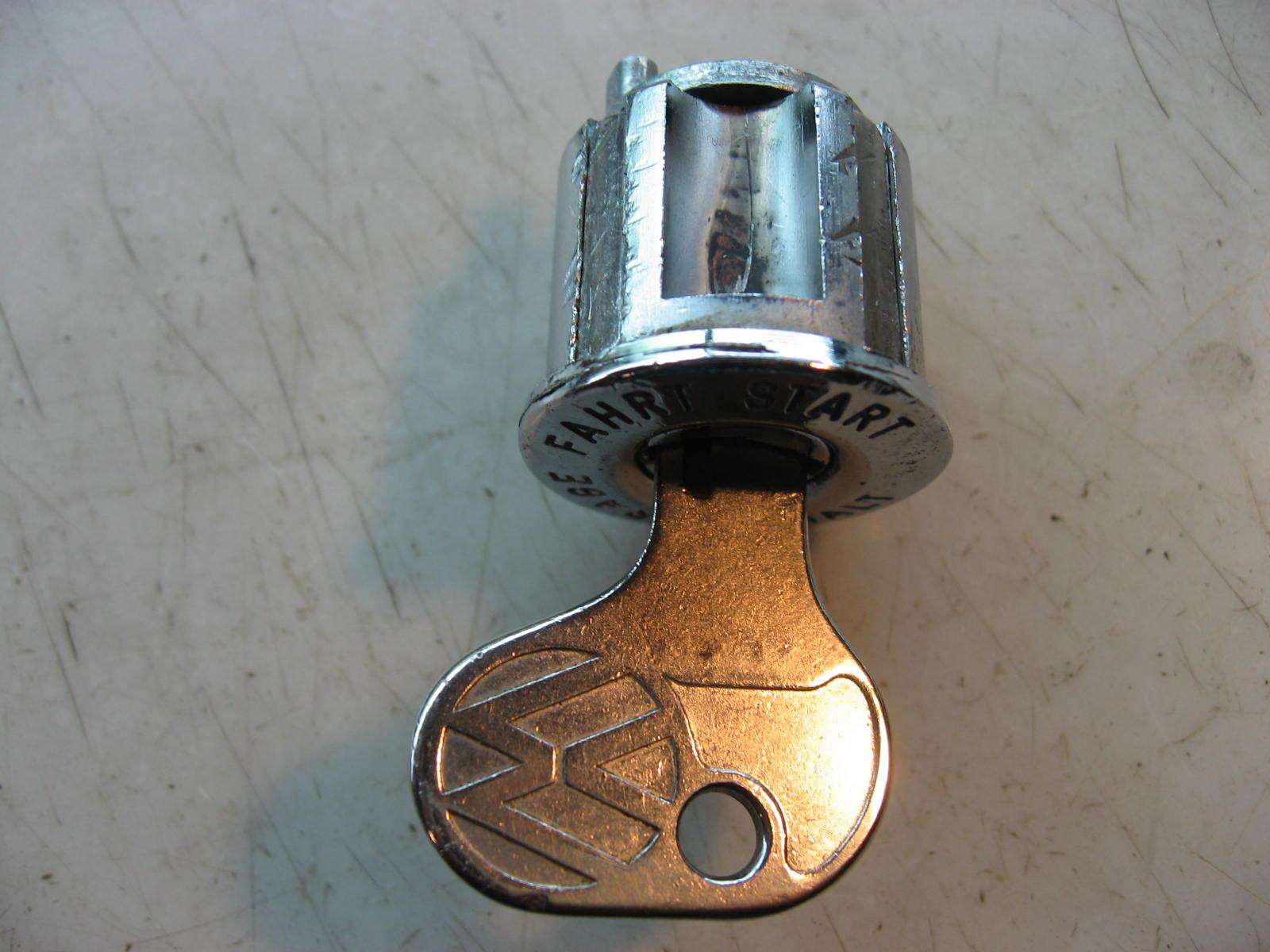

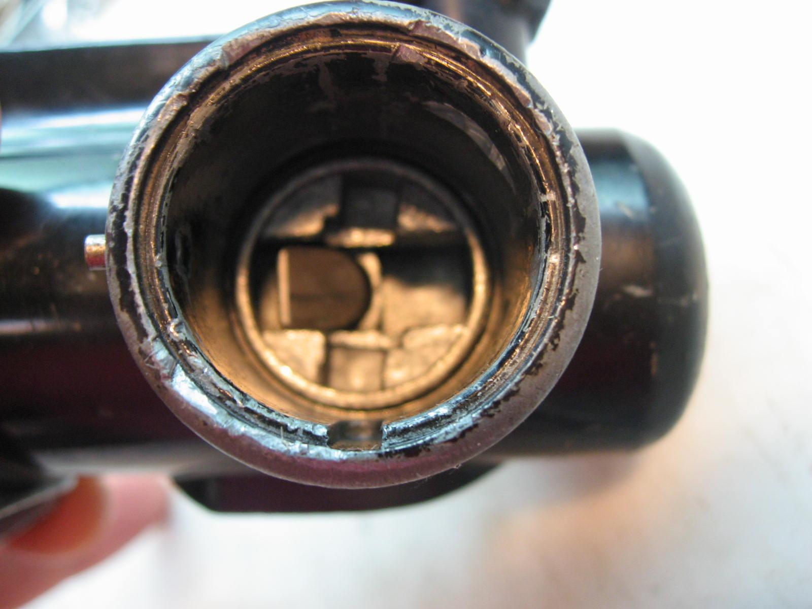

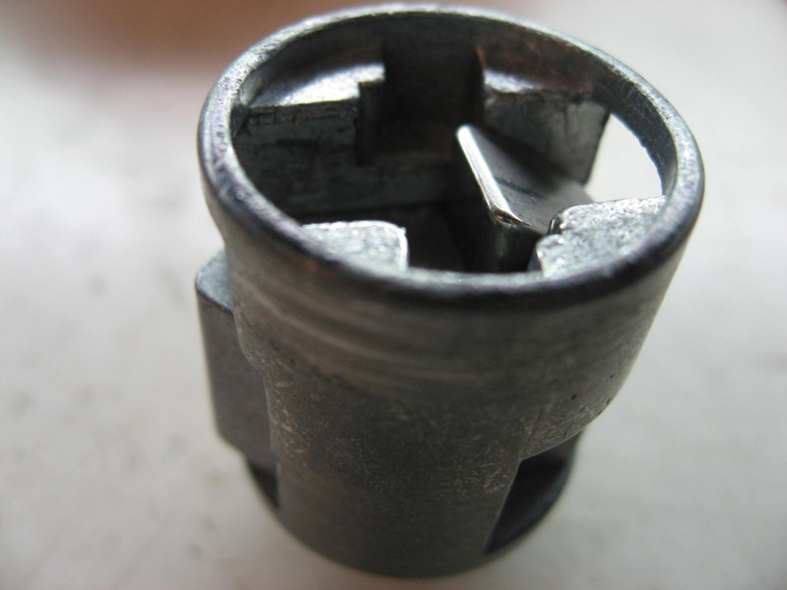

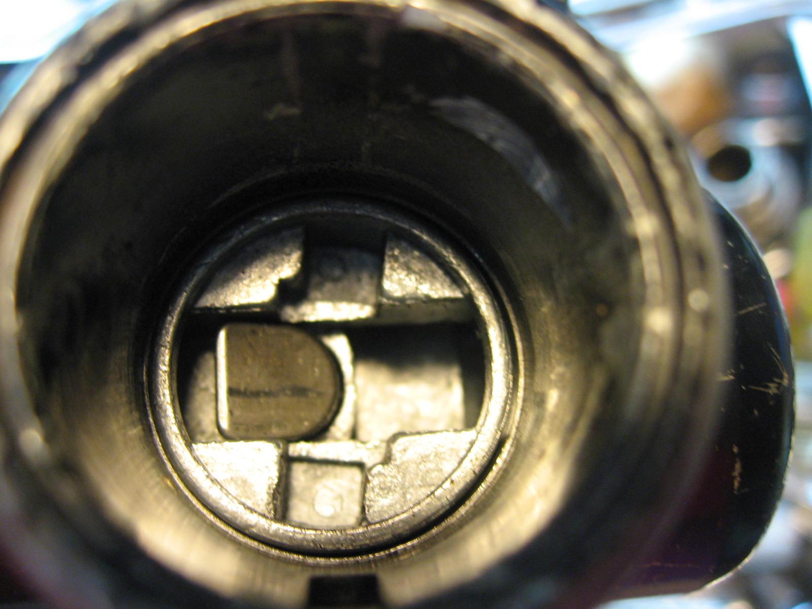

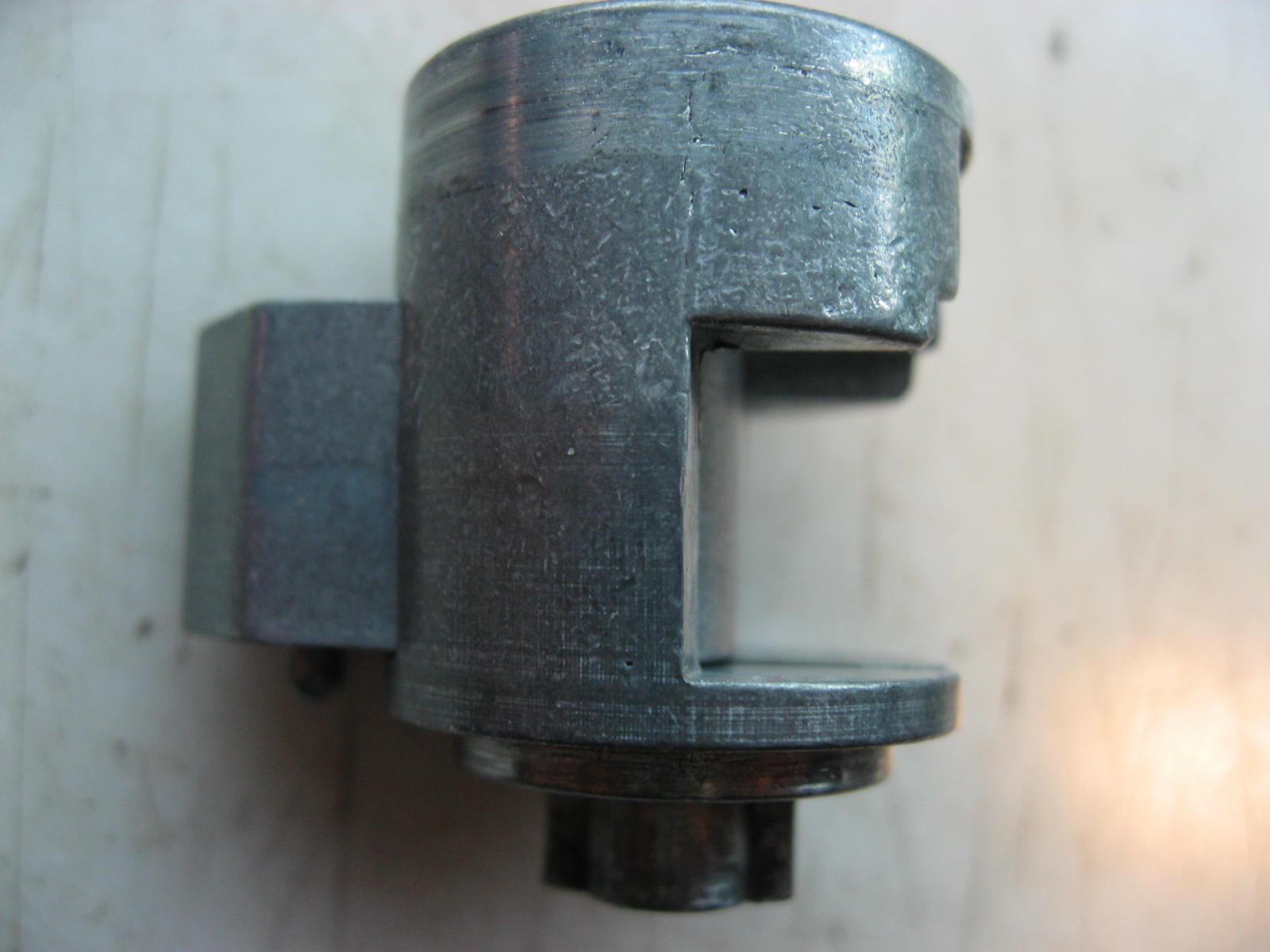

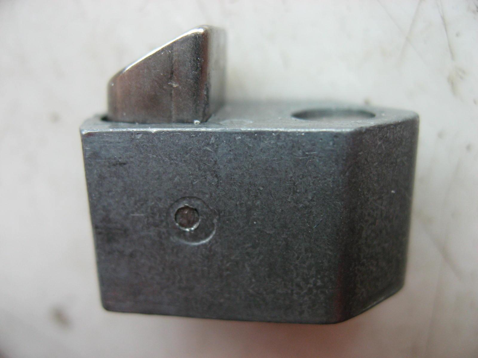

To finalize my reporting on the 1965 steering/ignition lock I went ahead and studied the last of the moving parts and their interaction.
This combined mechanism of the key barrel, the steering lock and the electrical switch is an exquisite masterpiece of engineering starting with the key's interaction with the pins all the way through to the final key removal and final lock after driving.

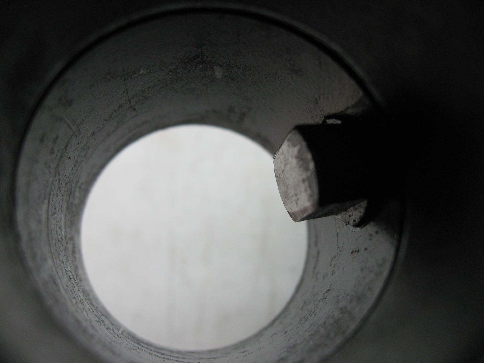

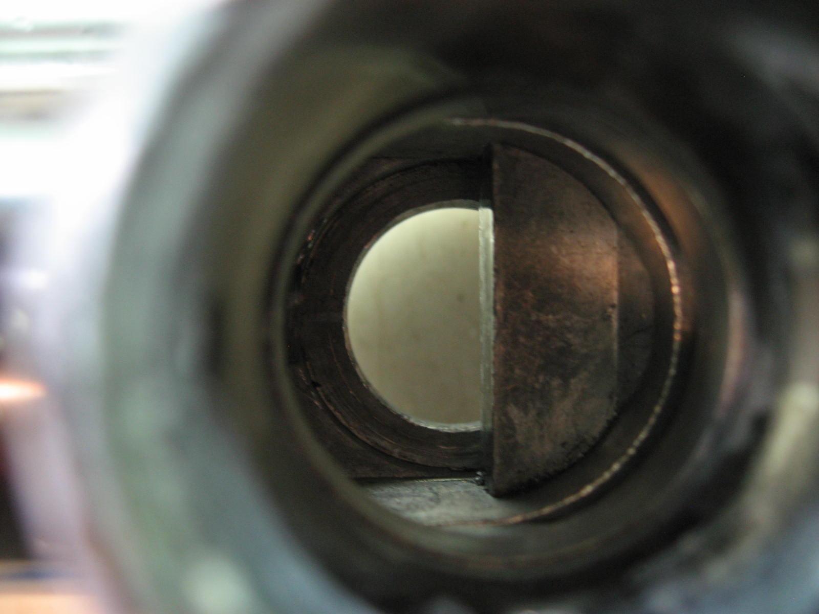

This first photo is looking into the steering lock mechanism into the cavity that the rotating cam mechanism was in. The front of the lock is on the right and the column is on the left in these photos. The part shown moving is not removable. It has a spring on the right. If anyone wants to see the shape I can do a sketch.
This is the column pin interface in the locked or "Halt" position.
The column lock pin "out" or inserted into the column to lock the steering from turning.
The interface in the "unlock" or withdrawn positon to free the steering.
The column lock pin withdrawn to unlock.
This is the brain or smart cam that controls all the positions. Here it is in the lock position or "Halt".
Here is the cam in the unlock with ignition "on" position. This is the "Fahrt" or "Journey" position.
The cam has several moving parts. Here it is naked with the "Halt" side on the left.
Here it is with the ignition on or "Fahrt" position on the left.
Every ledge, shape, crevace and groove of this cam thing does something.

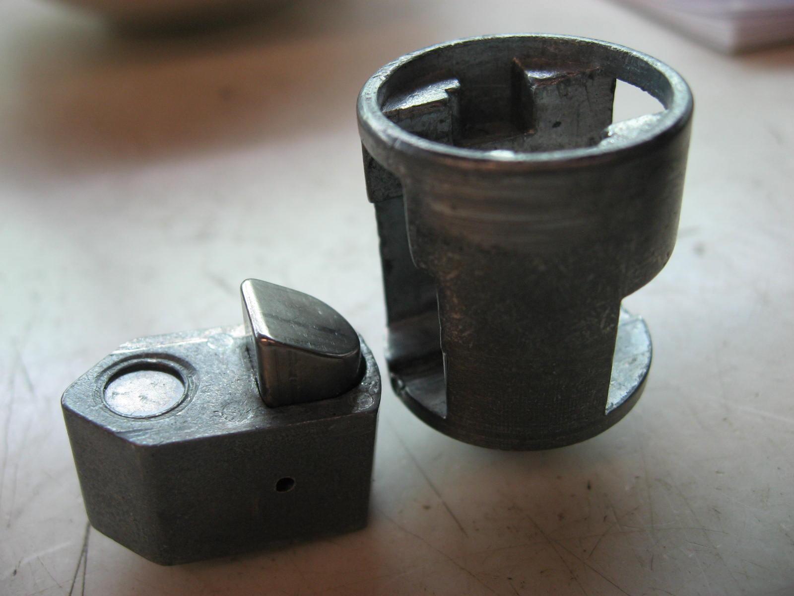

This is the last removable part to show its moving parts that are not removable. It is a sliding, friction, extending and retracting device. There is a latch on a spring secured by a dinked pin. The latch interacts with the key to let the cam lock the column as the key is removed.
Here is the spring loaded pin that rides in and out of the groove of the cam. The loaded pin helps in the final locking as well as retracting the latch as it rotates. I can explain that part more if anyone cares.
The pin's spring is made captive at the factory.
This is the correct orientation of the two parts. The cam and sliding device must be fit this way only.
Here is the cam ready to be inserted into the chamber.
I am astounded at the engineering and interaction of all the moving parts that make up the steering lock/ignition mechanism. These parts were designed by humans sitting at a drafting table then the plans were sent to manufacturing for creation and assembly.

I have a South African bus that is meant to have a steering lock but when we got it it had a conventional ignition switch in the instrument housing.
I have been trying to peice togther the parts. I was given a body but it had no switch or key barrel. I managed to source those and quickly realised I was missing a key part, the center cam.
Then I found another body that had the cam and putting it all together it all seems to work on the bench. However the cam seems slighty different to the one pictured elsewhere in this thread and does not feature the sliding part?
This is what I have...
I assume its missing but also wonder what it actually does?

PostPosted: Sun Nov 09, 2025 4:41 am    Post subject: Re: Neiman steering lock - no key Reply with quote
I assume it’s missing the sliding bit but I wonder what it actually does?
Also, the profile of my cam is subtly different to the other shown.
I'm wondering if I can reverse engineer the parts and 3D print them in Ali as it seems there are quite a few bodies out there without the guts. The switch was easy enough to source and I got a lock barrel. Although it fits, I know it’s wrong as it only has one locating lug where the one pictured elsewhere in the thread has two and that is what the cam is set up for.

BarryL Premium Member
Joined: November 01, 2004
Posts: 15446
BarryL is offline
PostPosted: Sun Nov 09, 2025 6:37 pm    Post subject: Re: Neiman steering lock - no key Reply with quote
Can you post a photo of your lock barrel and your electric switch?

The switch seems readilly available and has the single click start
The lock barrel (211.905.855.3) is not right, it only has one lug to turn the cam where there are two slots in the cam. That said it will operate the cam fine. The lock only has one position where you can remove the key, in the steering bolted postion.
I'm also not sure the key sticks through enough to activate the slider, if that's what it does.
I have now managed to design and 3D print another cam in PETG as proof of concept and it works. Long term I'm sure it would get worn out. I got a quote through for having it printed in Aliuminium, for one its coming in at nearly £200 (~$263), less for higher quantities.
Using the photos in this thread I have tried to reproduce the slider but I don't fully understand its function or operation so can't see what it brings to the party at the moment. There is no slot in my cam for the pin on the underside of the slider
1975 South African Fleetline
garym999
Joined: November 26, 2022
Posts: 174
Location: Oxfordshire, UK
garym999 is offline
PostPosted: Mon Nov 10, 2025 12:49 pm    Post subject: Re: Neiman steering lock - no key Reply with quote
Right, I have now mocked up the slider so I can play with it and I finally understand its function I think...
It stops the steering lock activating until the key has been removed.
As already said a lovely bit of engineering
