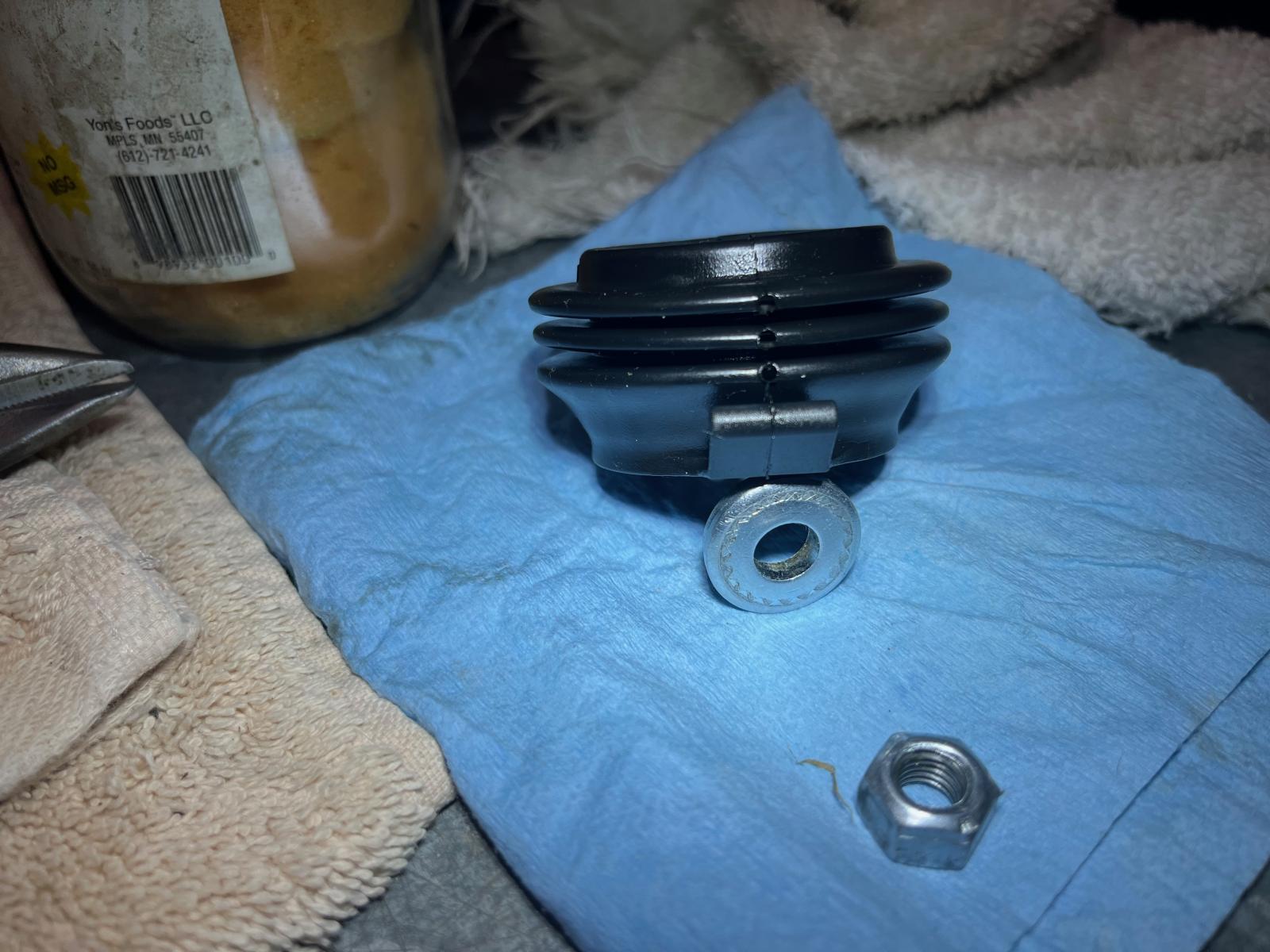

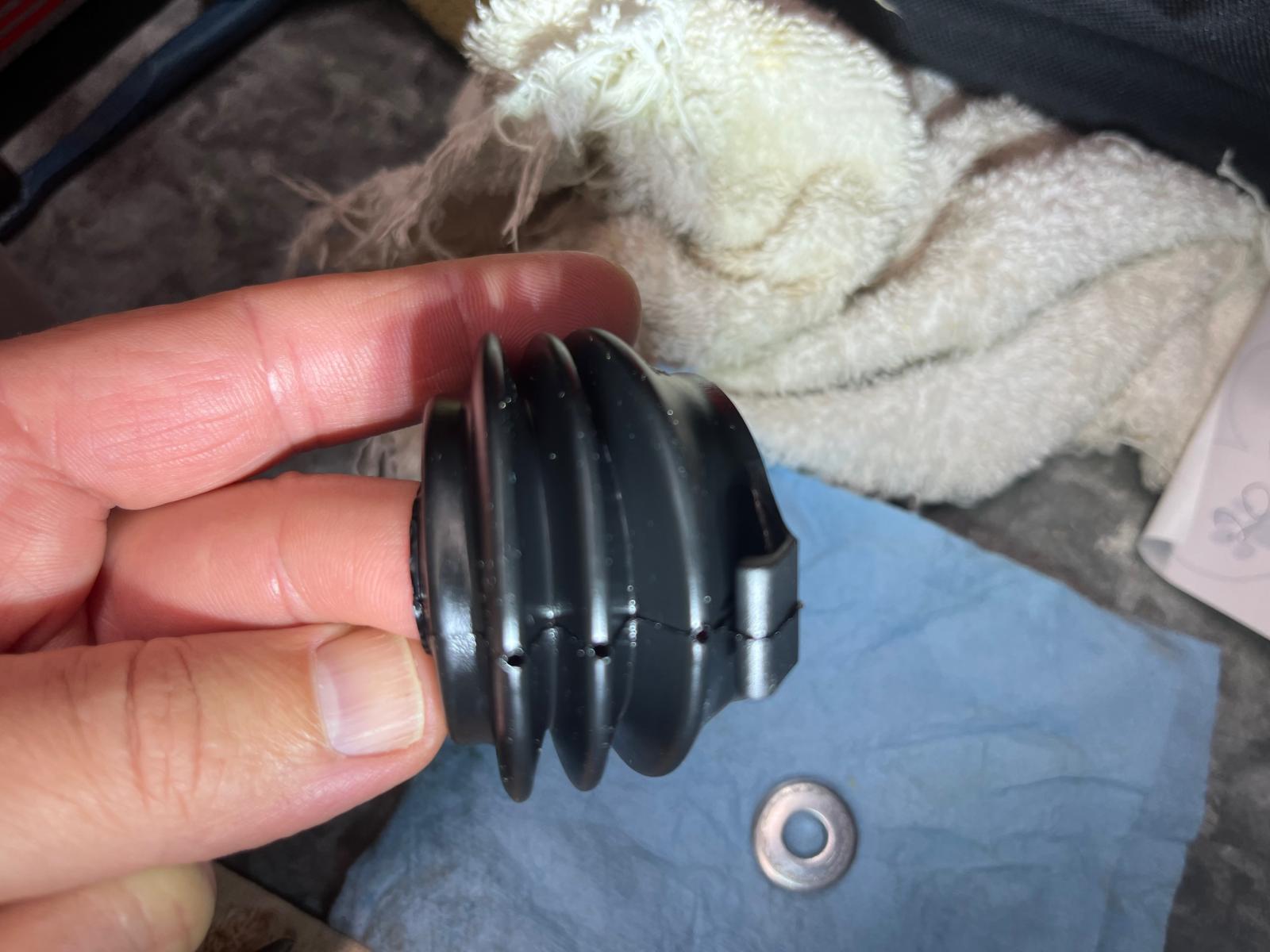

I was working on the shift linkage and noticed that the factory shift rod boot (020301261A) has tiny drain holes at the peaks of the shift bellows. I never noticed this before and don't believe the aftermarket parts have this feature.
Here's the factory part:
Note the holes in the bellows. Do you think these are intended to drain water, or instead is it an acknowledgement that the selector shaft seal eventually leaks oil?

Holes down. Pressure equalizing makes the most sense. The shift shaft seal would have to be completely worn out for it to leak. I doubt the engineers designed a boot with a lube letter outer for a failure well beyond the warranty distance.

Yes, water drain holes. That is why there is a hole at each low point assuming you orientate the holes down. If for air only, then the holes would not need placed on each low point. Their location indicates water drainage was a consideration. Point the holes down. Of course water drain holes will also serve for air venting, but for air venting, the holes need not be at each low point.
Dual function.

PostPosted: Fri Nov 07, 2025 8:58 am    Post subject: Re: OEM Shift Rod Boot: Drain holes? Reply with quote
Sodo wrote:
Never know what kinda funky thing some feller gonna do with his shifter boot.
thats 020301261A stretched over a CNC shifter cup.
A custom shifter cup with no drain hole BTW…. Wink
