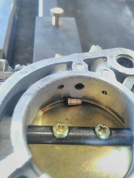

New genuine Redline Webers. 2 sets, 3 seats did this as soon as I tightened the idle screws.......
