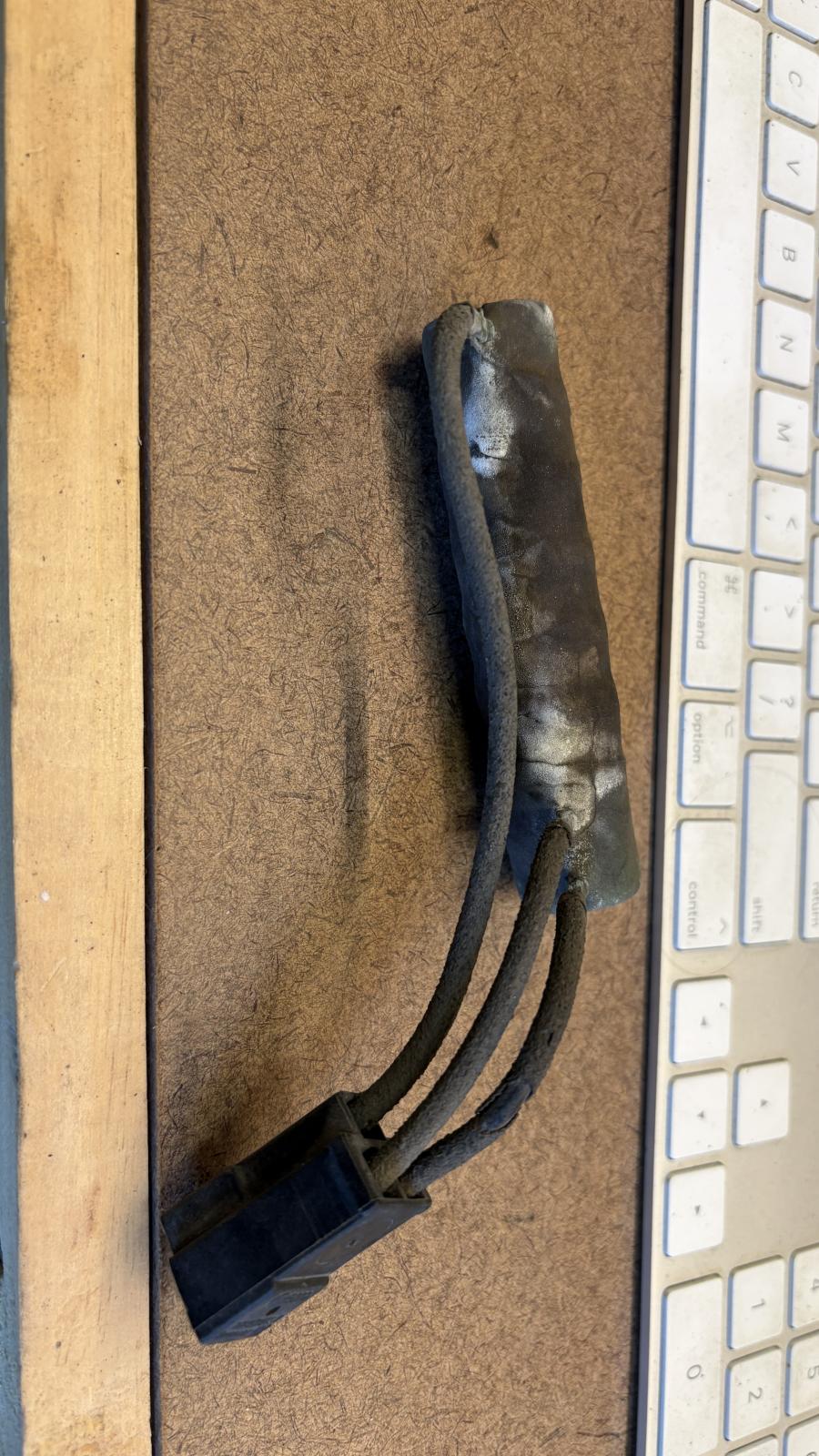

Pulled the old resistor finally (was too dang cold and windy yesterday). Ran some DMM tests - don't know the exact test or spec but got OL across any combination of connection testing.
Ordered a new one. Let's see what happens next!
She looks pretty tired.

Did you run this test?
syncrodoka wrote:
You need to short the wires going to the radiator fan switch to test for resistor function, that tests high and low. If it passes that test then it is likely the radiator fan switch that is bad.
IIRC you short the outer 2 and the high speed turns on, short one of the outer contacts to the inner turns on the low, one outer/inner combination will do nothing.
I had your same issue and when I jumped the fan switch the fan operated fine so the resistor was OK. A new fan switch and all is well.

Sometimes I’m not as smart as I think I am so check my thinking here. I did jump the wires in various combinations, and I was not able to force the fan to come on. Prior to removing the resistor I was getting a high fan when driving. I did not get the low fan when I turned on the AC.

If you have a three speed system IIRC the fan comes on medium with A/C. Not controlled by the fan switch.
The fan switch mounted on the lower drivers side of the radiator turns the fan on low somewhere about 195 and on high maybe 207 or so.
If you jumped the fan switch properly and only got high speed then I'd replace the resistor.
