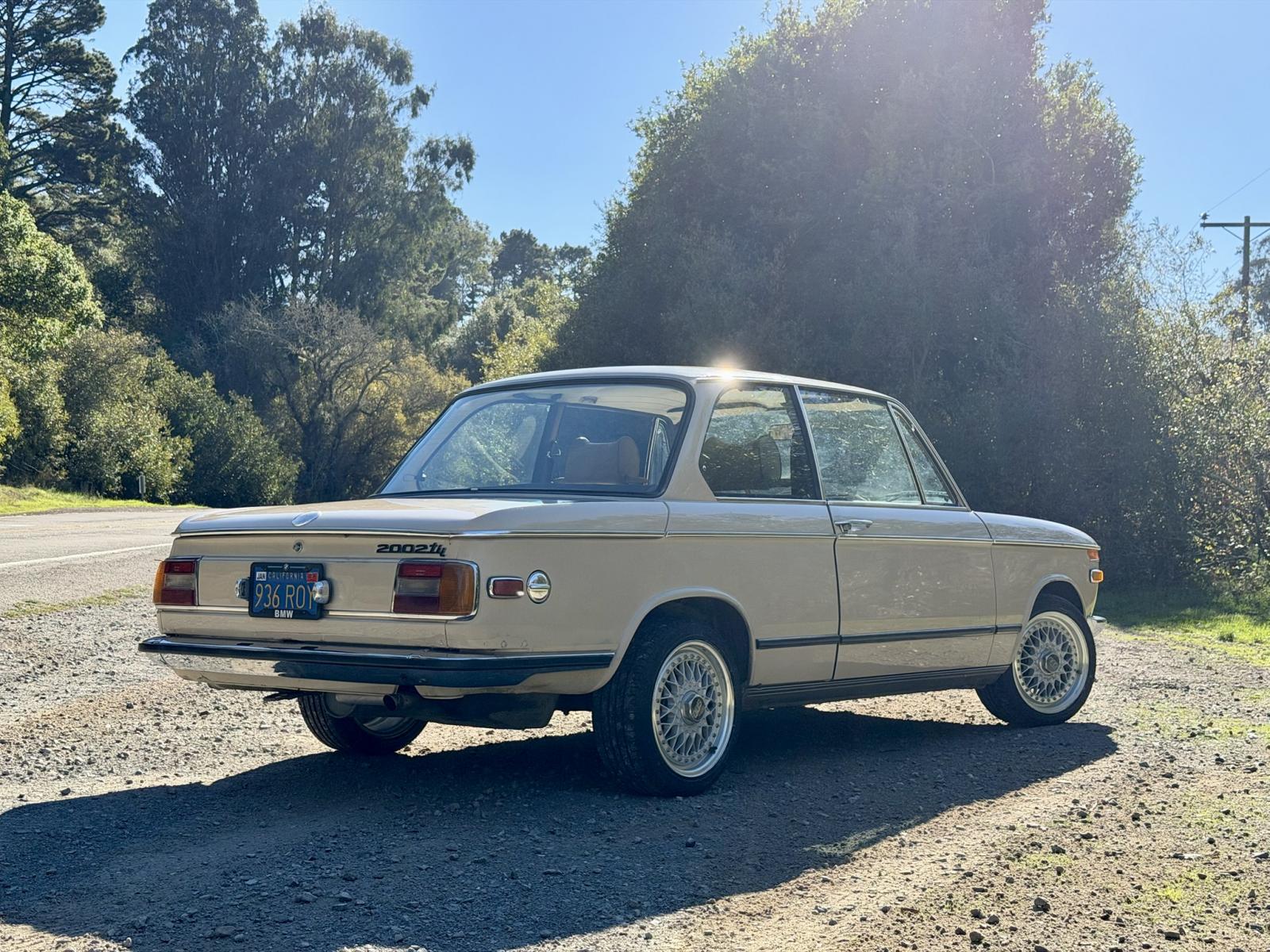

Anyways thanks for the help! On to the next project; rebuilding the motor in my 74 2002tii. This time the head gasket actually is bad (and no there's isn't any oil in the coolant...).

'74tii with '72 bumpers? Or gray market?
Chamonix White?
Love it!

PostPosted: Mon Nov 10, 2025 9:09 pm    Post subject: Re: Blown head gasket or something else? Reply with quote
Chamonix White?
Love it!
First thing I did was ditch the diving boards. Color is Sahara.
