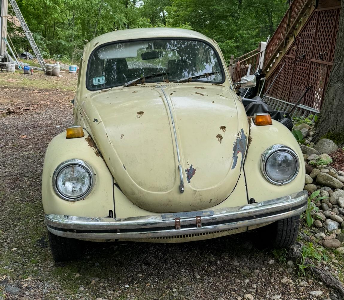

Back in May 2025 I grabbed this 71 Shantung Yellow Super Beetle off of Craigslist in Fitchburg for $1200. Didn’t run, but was complete, floors were recently replaced and had a new gas tank. Seemed like a good deal so I pulled the trigger. The seller also made me buy a 1970 beetle, so this was a buy 1, get one deal.
I’ve spent the summer working on it and getting it back to running status. I will add more photos and updates later. Just starting this build thread to get the ball rolling

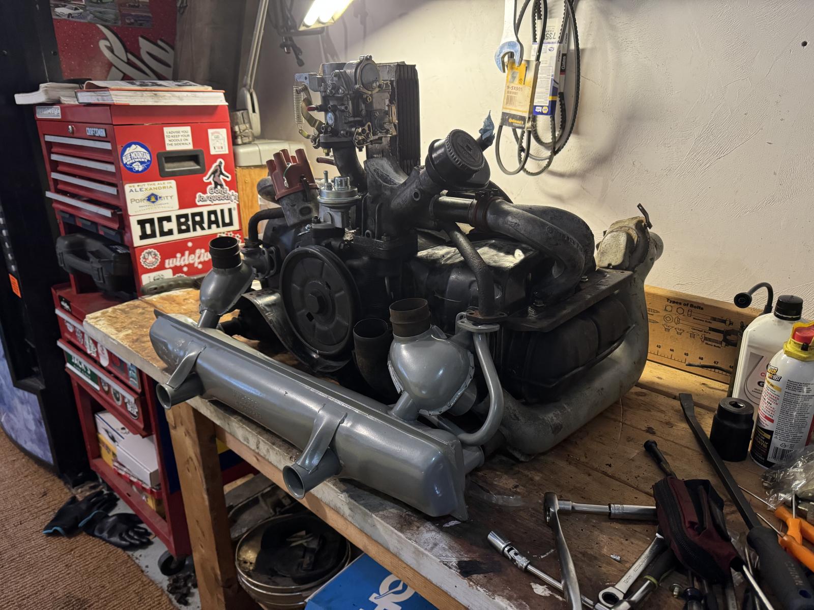

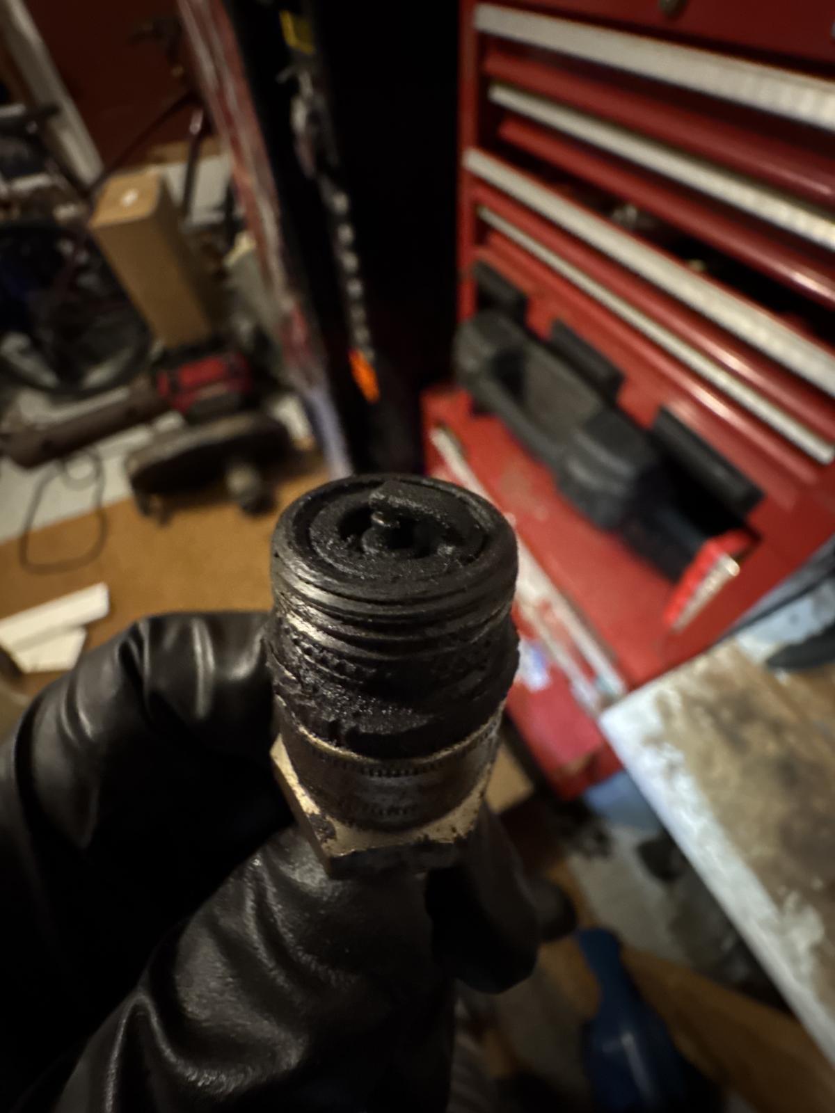

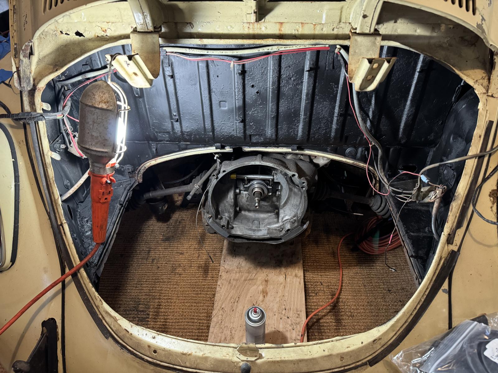

After brakes, I moved onto taking out the motor for cleaning assessment…
The 3/4 side had inserts on the spark plugs. I couldn’t remove the 1/2 cylinder head from the piston sleeves, I soaked and hit with a dead blow hammer for 2-weeks and I could never get it to come off. The fins of the cylinder sleeves were caked with mouse poop and piss, the pistons looks caked with carbon. So I decided to just do a quick top end rebuild. I got some Mexican cast piston and cylinders and local Massachusetts Samba member APPLEGREENVW hooked me up with a set of decent heads he had on his shelf for 20 year.
Put it all back together and I was making some progress. New seals throughout, push rod tubes, etc. spared no expense Laughing
Tore out the sound deadening, spray painted, replaced seal, was getting closer.
Moved onto some transmission retreat. The return spring was broken, R/R that. The mounts fell apart when I was removing them, like I said, this bug has seen some miles.
You can get a lot done when your furloughed during the longest shutdown in history Embarassed

PostPosted: Mon Nov 10, 2025 4:58 pm    Post subject: Re: 1971 Cape Cod Shantung Yellow Super Beetle Reply with quote
A couple weeks ago, got the engine off the bench, checked endplay, adjusted endplay with shims, and installed it with help from a fellow samba member (Allyn), set timing, etc. and it sounds good.
I spent time this week replacing the evap lines in the trunk, and the line that go under the vehicle to the charcoal canister, I need to replace and also get a new canister. The car stinks of fuel. Never had a car smell this gassy.
Any tips for the gasket between the fuel gauge floaties? I have a new filler neck rubber tube on order too. I used windshield washer tubing for the small evap lines, I think I need to switch those over to fuel vapor lines? Hopefully that will calm down the fuel smells.
I’m also fine tuning the carb. No change in idle when I adjust the volume control screw (small screw). Following procedure in Bentley, but no change when I adjust the small screw. So I’m waiting for my rebuild kit so that I can refresh the o-rings. Etc.
