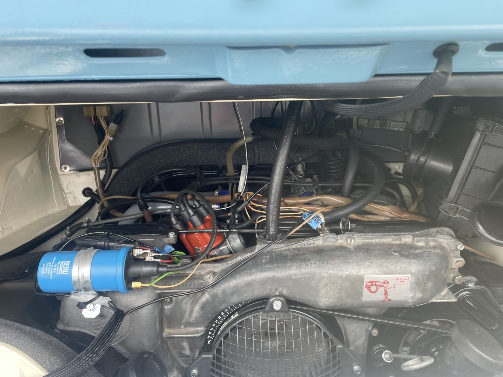

You and Ray must be talking about replacing a TS2 on a Type 4 and Type 3 car. In a Type 2 bus with L-Jet the most time consuming part of replacing a TS2 on the side of the road is unpacking the camp gear. I don’t see the the advantage of adding a home brew “Emergency TS2”. Have you had to do this in a Bay window bus frequently?
This whole process took 15 minutes to replace the broken TS2.

If you haven’t drilled and tapped the tin screw next to #3 intake for the TS2, you should. It’s a much easier spot. My ‘72 doesn’t have a hatch and i could definitely change it hot. I’ve hotswapped between the one inside the tin and the Vespa sensor outside to test function. The original location would suck when hot.
Your 72 bus/kombi with a German factory spec engine (72 model year) has a TS2? I gotta check that out.
Not factory spec: EA code(411?) 1.7 in a ‘72 Deluxe with retrofit ljet (except for Inj Rehab rails and injectors/awesome) from a ‘78 bus? It works great!
Nice!!! Thanks for letting other Fuel injection bus drivers that use a TS2 know what you have going on. Very cool.
Keep on Busin'

Let’s keep this question to Type 2 fuel injection buses with L-Jet.
Is it easier to install KTPhil and Rays “emergency TS” or just grab the spare in the drawer on the side of the road? Might be some confusion on the type 3 and type 2 bus accessibility. This is a Bay window forum after all but if Ray and KTPhill have a better way for a bus, i’m in.
I just carry this.
Keep on Busin'
