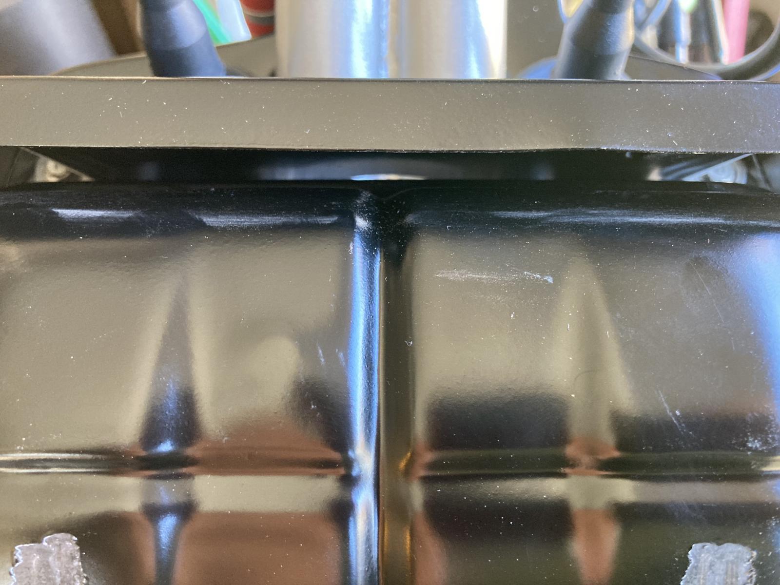

Has anyone else had trouble with the Speedwell 36hp aluminum valve covers not fitting? I just bought a pair and went to put them on and they won't fit under the cylinder tin. I would have to cut the bottom lip off the cylinder tin or grind off the top fin of the valve cover to get it to fit. I will likely have to return them if I can't find an affordable solution.
You can see the top fin of the valve cover hits the bottom lip of the cylinder tin and the cover won't fit under it. There also has to be room for the rubber seal that goes around the engine, so that will make it impossible to fit.
Here is the stock cover and there is plenty of room for it to fit under the cylinder tin, with plenty of room to spare for the engine seal.

Maybe a little risky, but you could grind off that first rib. Sandblast it, paint the whole thing black and polish the remaining ribs.

There is absolutely nothing wrong with trimming the cylinder tin. Slice that flange down the middle to reduce its height by half.

Should not be an issue trimming the Tin. Someone has already cut big holes to fit those Dual Port Manifolds...

I ended up sending the valve covers back. In order to get them to fit I would have to trim the cylinder tins. To do it right I would have to take all of the tins off, including the fan shroud and manifolds, trim the tins, paint them and put it all back together. In the end it wasn't worth it for me.

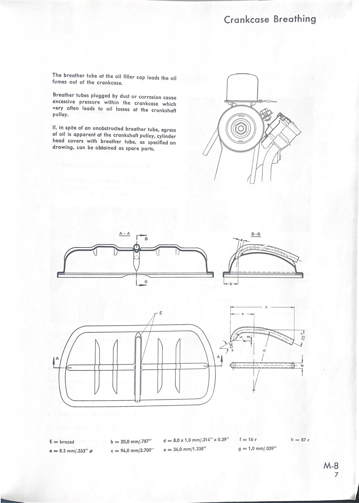

Period correct valve covers with the factory correct vent tubes would also work - see details per the 1958-1960 Bentley manual.
