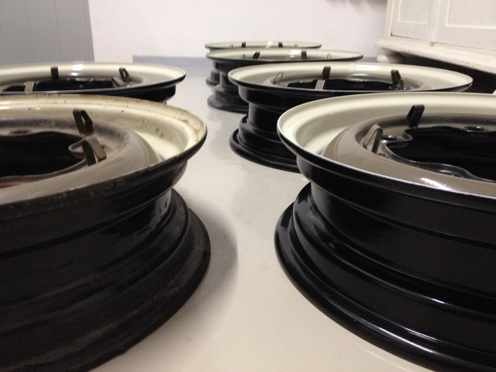

Next step was to source a original painted wheel, as the original wheels of the car had been repainted in a wrong colour. Sourcing the wheel was easier than I thought, I found it in the stock of my now dead friend, that had to be dissolved.
Unfortunately, it wa not possible to get a dead match on the L 479 clay beige and so I used a RAL tone as close as possible:
The rims got blasted and powder coated in gloss black. After, I started with the inner portion using a flexible masking tape.
and after drying finishing the outer rim, again using masking tape

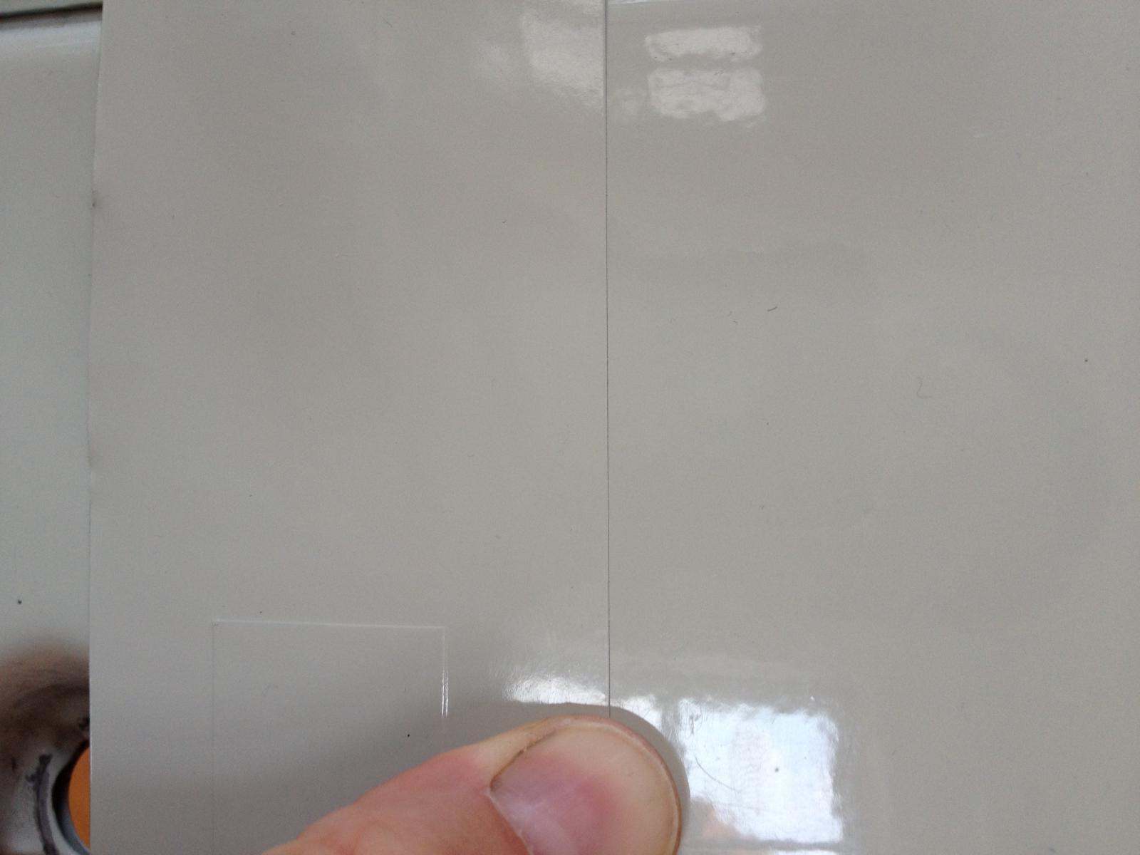

With fresh painted wheels:
Just a few word about pearl white:
Since years I'm trying to investigate the truth of this colour. I tried 8 or 9 different supplier in Europe and UK, including Standox, Glasurit, always unhappy with the result. No temple studio here. Just one part of the results:
Trying them at the object:
White colours are the most hard to get right. The problem is, most supplier use wrong pigments, such as red. Even if you found a situation where you think, the result may be ok, you will have a not matching appearence in another light.
The original formula was:
98.4 parts 1051 / 80 white
01.0 parts 1066 / 12 yellow green
00.6 parts 1052 / 40 black
These are the original mixing colours:
Now you get an idea of what yellow green means. There is not even a trace of red or orange in it.
But here, we see part of the problem:
"White" yellows with time, the more the longer it is not exposed to daylight (as you can see at the colour sample above). You will find darker areas of pearl white under the hoods and in the b-pillar and flanges of the doors.
When the supplier try to find a formula for this colour, they don't have the orignal formula at hand, and even if, they don't know how the pigment yellow green exactly was. When they take a original paint sample from today they won't find the pearl white as it was freshly delivered. So they add some pigments that haven't been original part of pearl white, because they try to get a match on the pearl white as it looks today after more then 60 years of environmental influences, now with more yellow in it.
If we have to paint a car partially, this is the right way to do, even it really is very hard to find a dead match.
If we want to paint a car completely, what is the right way? As delivered, or as 60 years later? _________________ 1961 pearl white beauty from Portugal

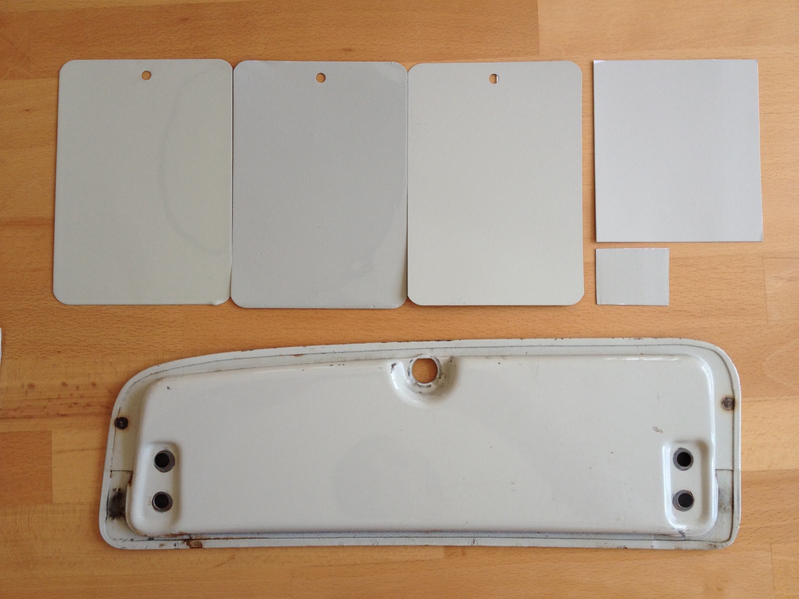

For a partial paint job I always send the glove box door to the supplier and hope he will get a close formula. But it didn't work out.
Here I show you the best match I could find: The supplier is MIPA.
But I was still not happy with the result. So I ordered the basic colours and have taken hours and hours to adjust the formula, mixing by hand to reduce the appearance of red by adding white black and green. Now, two years later still not finished... _________________ 1961 pearl white beauty from Portugal
https://www.thesamba.com/vw/forum/viewtopic.php?t=759951 |

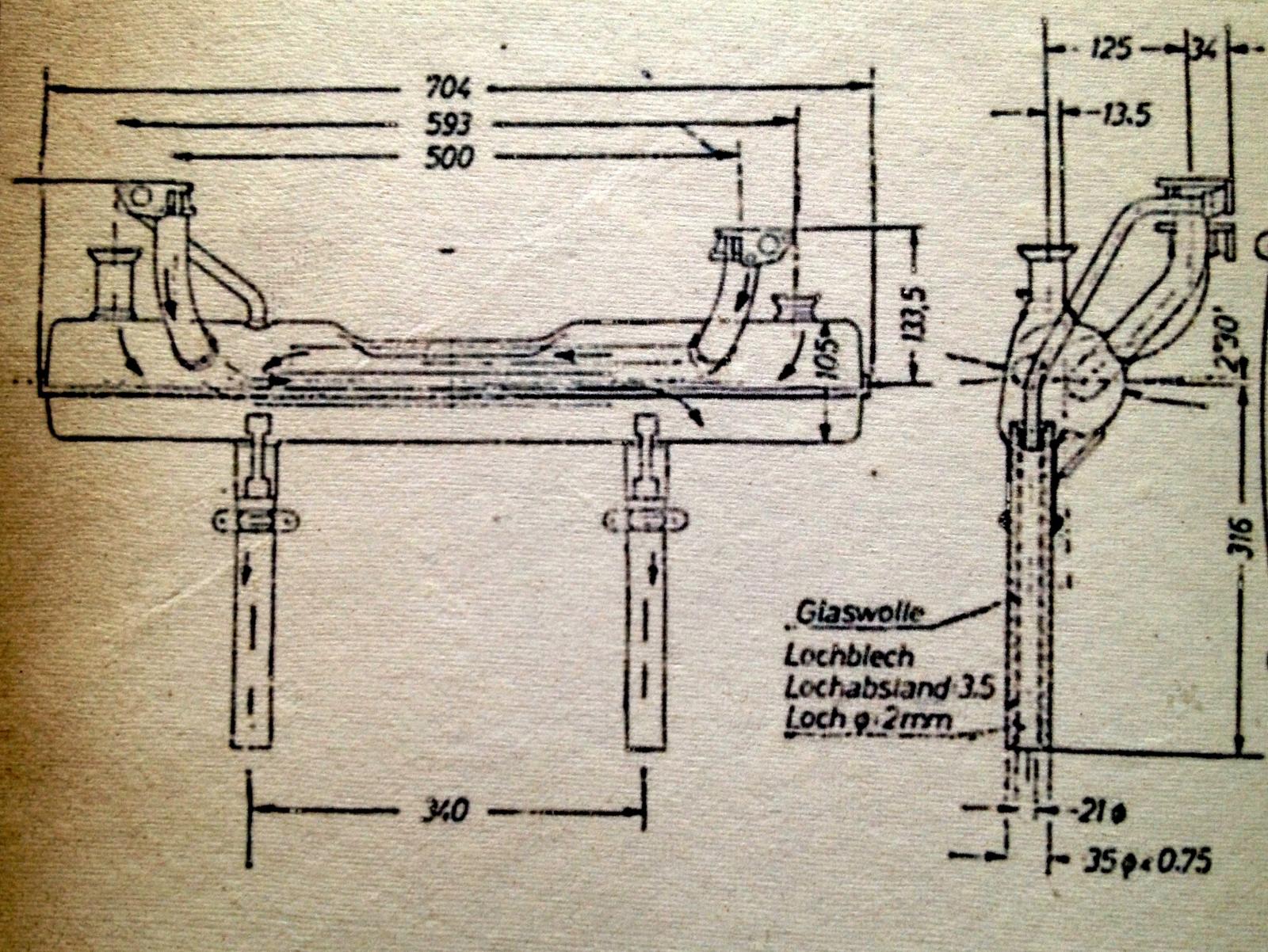

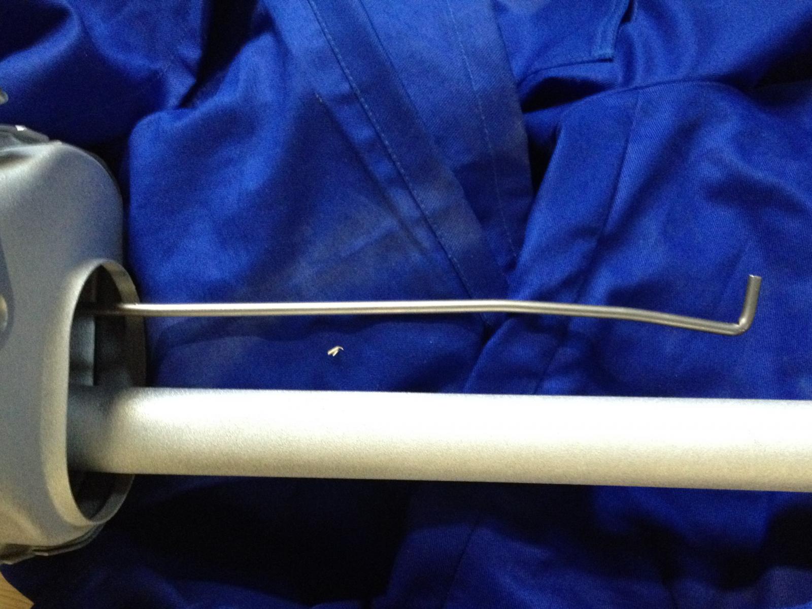

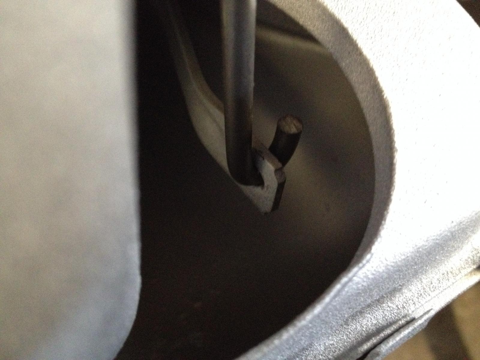

During the second rebuild of the engine, I was lucky to source NOS parts for the muffler and heating elements. These have been sandblasted and flame plated with aluminium and additionally with ceramic.
Note: The muffler are the original ones, how these cars left the factory. They are unique as the aftermarket muffler from Ernst, Lange, Sebring and others are different in detail. Two visible unique things are the VW stamp and the situation that the left end of the preheat tube is casted togehter with the flange:
Since have plated the first muffler (from begin of this thread) with the same methods, I put 33.000 Kilometers on this muffler, summer and winter. The coating ist excellent, still no rust or damage of the plating. But I will change it to one of the originals above, as these are period correct.
The flaps stayed untouched, as there is asbestos rivited on.
As one heater element missed the connecting rod, I ordered 5mm round steel an just bent it like the existing part from the other side.
Of course I had no tool to produce the bajonett stamping, so I bent the rod in a U-shape, what works fine.
