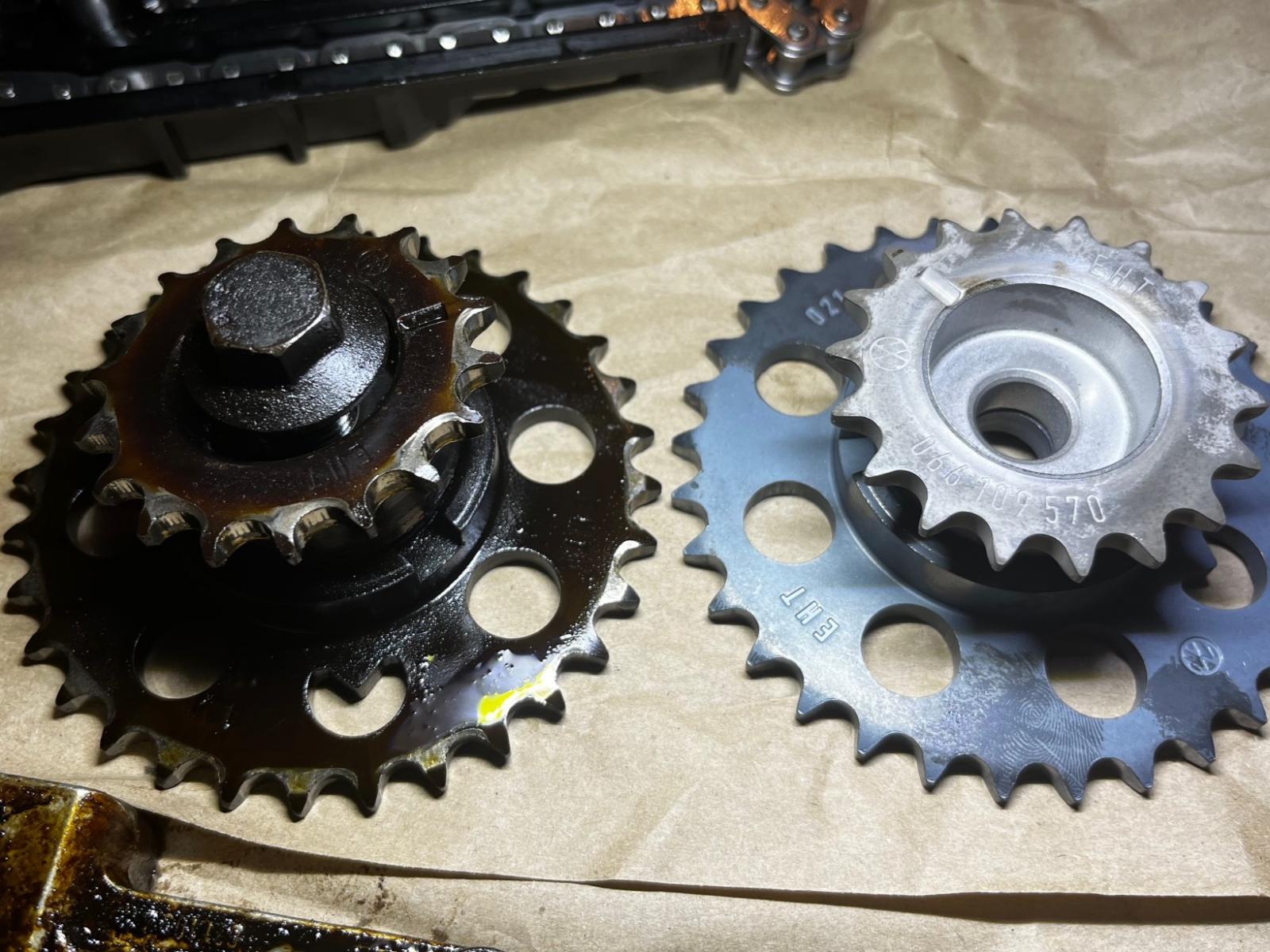

Hi Chas, not an expert but I can offer my experience tackling the timing job in our garage a few years ago.
The only way to get to the timing components is by either removing the transmission from the vehicle for access or pulling both the engine and transmission out and then separating them. Either way, lots of stuff will have to be removed like engine wiring, exhaust downpipe, axles and most of the coolant hoses. This took me several days of work, and then you have to do it all in reverse when you're ready to put it back together. A pro would be a lot faster than me, but you'll still be paying for a double digit number of labor hours just to get to the chains.
Once everything is torn down, replacing the actual timing bits shouldn't be hard for any competent mechanic. I'd never done this before and I had the chains, guides, tensioners, intermediate sprockets and hardware swapped and timed correctly in about an hour.
All of this to say, if it's taken apart far enough to inspect the timing components, I think you'd be nuts to not replace it all while you're in there. Our '01 was also very well taken care of with regular oil changes since new. But when I tore it down after 200,000 miles, I found worn guides, chewed up intermediate sprocket, etc. If you're looking for an easier way to inspect your chains, the oil fill tube comes off with a few bolts and will give you a view of the upper chain. You could probably snake your borescope in there to get a look at the lower chain and intermediate shaft.

Sorry for the soapbox, just wanted to give you my perspective. I'll attach a few pics below of new vs 200k mile timing components for your reference. Some of the guides were so brittle that they snapped while being removed.

Closeup of the old vs new sprockets:
