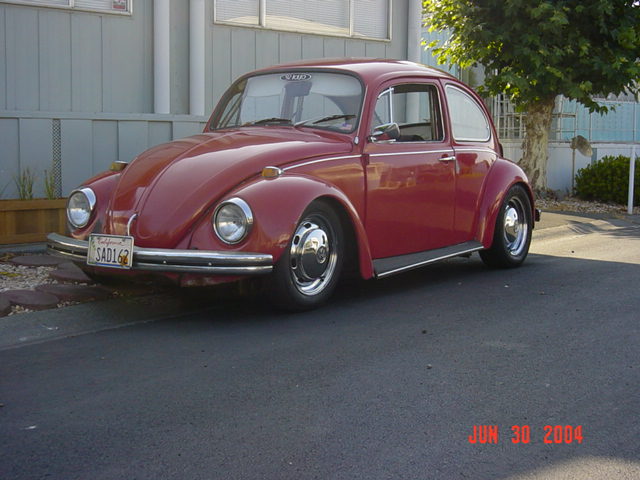

I'll have to dig up the Polaroid photo, wherever it ended up, of when we first got the car running. Here's what I remember though.
It wsa the late 90s, and I was introduced to the Cal-Look VW by a good buddy of mine who has a '58 euro-spec Bug (he has semaphores). It was lowered all around on chromies, with big hubcaps. I thought it was so cool with it's quad tip exhaust, and dual baby Webers. It was loud, and drafty when riding around in it. Realizing that as someone in their late teens/early 20s who doesn't make a lot of money, he convinced me to find a Bug since they were kind of cool and economical at the time. Well after searching, he ended up selling me his other car, the '69 I still have, which his sister was driving to school. I don't recall exactly what happened but maybe it threw a rod or something, since it did not have an engine case.
The car was in good shape and pretty similar to the photos above from '03. But it needed carpet, headliner, door panels, window cranks, and of course the engine. Somehow we were cruising around the bay area in his car, and literally found an engine case being thrown away. We snatched that up and I was able to get a lot of the other internals needed at Vintage Technology in Santa Rosa. We painted the engine tins red, built the engine with single port heads and the original single carb but the lower end was put together with the Engle W110 cam. I remember the first drive down the street from the shop; the car couldn't do more than 40 mph with the pedal to the floor!
We figured that the cam had something to do with that, so at the next swap meet in Vallejo I picked up a set of Baby Webers for the car. I might have found the pop-out windows there too; he said the car had them originally but in the 90s, "Cal-Look" was all about dechroming so he put in solid windows with black rubber all around.. The pop-outs were coming back in style though and are nice. Once we had the ICTs installed, the car could drive normal freeway speeds! It sounded cool to with they way they "talked", along with the single quiet pack muffler.
I quickly found the engine ran hot. I would take a drive from Santa Rosa to Sebastopol, and the oil temp would be 200 degrees easy. One Saturday, after work, my buddy says, let's take it to Pinole (his girlfriend lives there) and see how it does. We watched the gauge go past 200, all the way maxed out, and then it dropped. "Woah, see, there's just something wrong with the gauge!". I started loosing power shortly after though, and found that the engine was indeed too hot. Trying to turn around in the Marin area, we made it just a few more miles when it was too hot again. Pulled over to a safe spot to let it cool off, but it would no longer crank over.
We towed the car back to where I lived, and found a rod had welded itself to the crank. I took the block over to Van's and they found that the center main, when the case was torqued, was not touching, so the 2 center rods were not getting enough oil. He was able to fix the case with heat treatment and a new line bore, and again I went to Vintage Tech to get parts including a new Scat crank. Van hooked me up with a set of the 311 rods, and we re-used the pistons & cylinders. This is the same lower end that's still in the car today!
