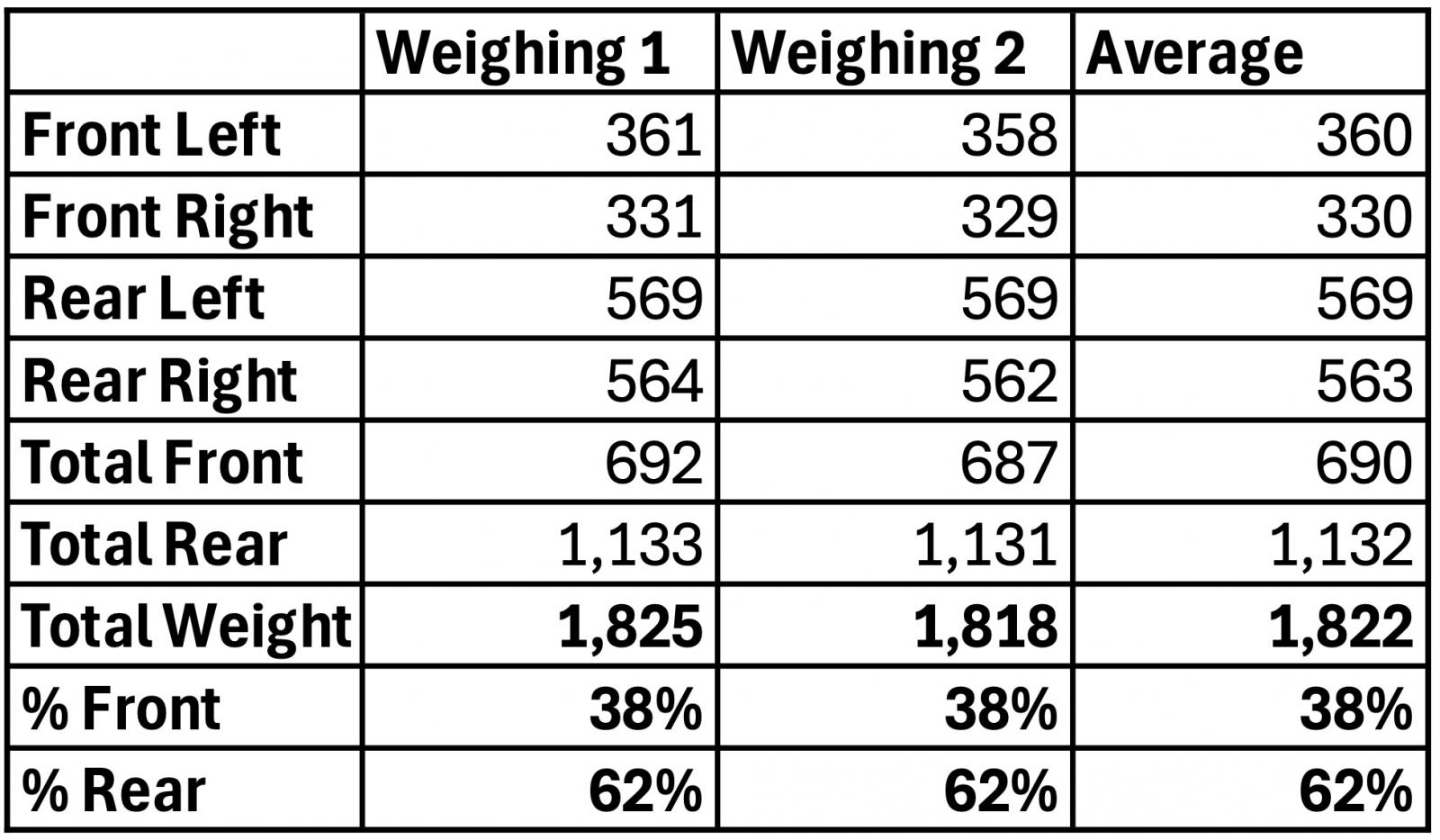

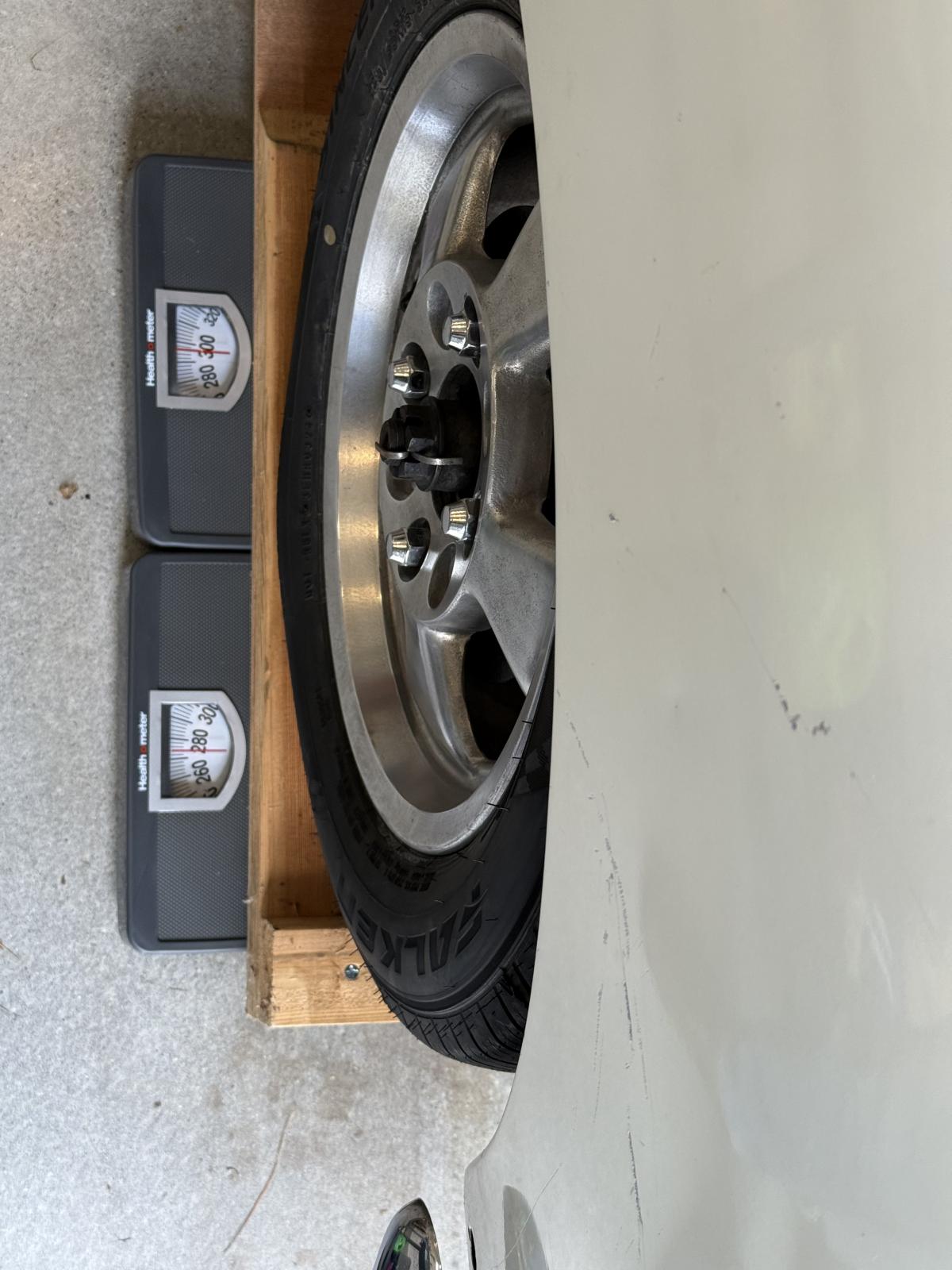

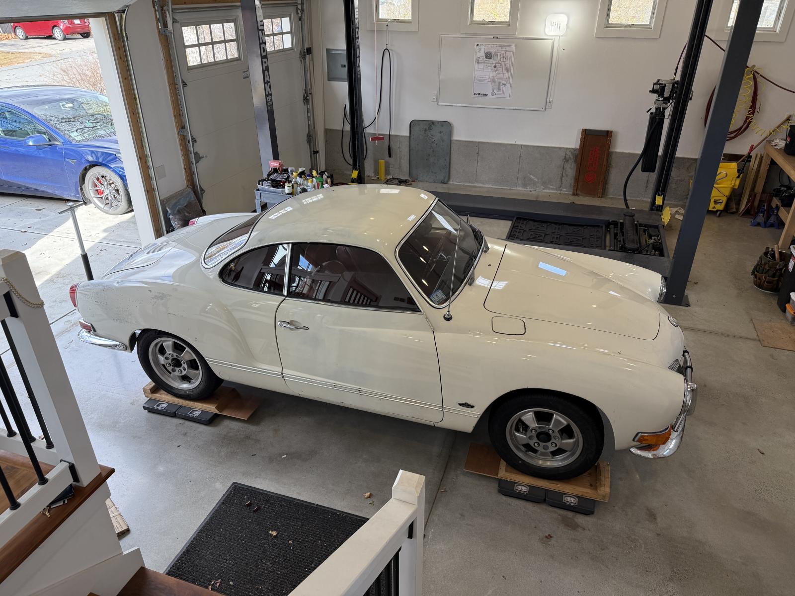

I weighted my 1970 Karmann Ghia Coupe today, using 8-330lb analog bathroom scales, which were $10 each at Walmart. Car is all stock, with a gas heater installed above the transaxle. Gas tank was almost empty.
Here's my data:
Just thought I'd share.

Interesting that if I add weight for a full tank of gas in the spreadsheet I get the 60%/40% weight distribution that I've seen quoted in various places.
