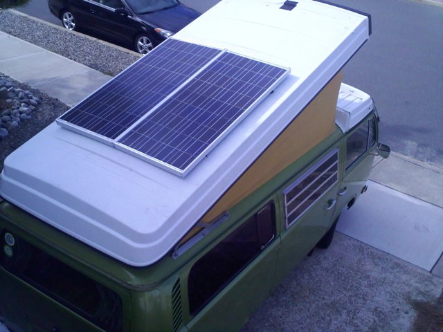

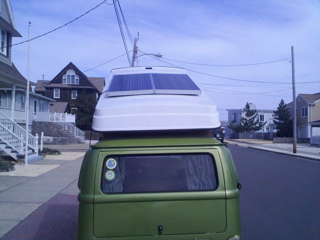

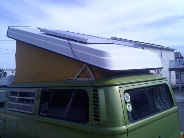

As you can see in this pic, I do have some cleaning up to do with the wires and trying to hide those scratches a bit (probably my worst mistake during the whole installation, which I consider a huge success.)

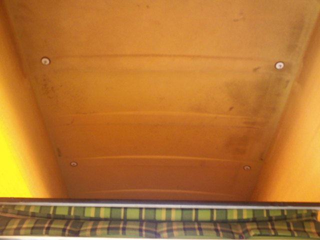

Although not highly visible, these are the four bolts with rubber (black) and metal (white) washers holding down the four corners of the two panels from inside the poptop.
And just a few more pics...
So, just some caulking, gluing and wiring and I'm all set to take off on the road! I still need to install some DC plugs under the zbed, but that should be simple. This was absolutely the hardest and most challenging aspect to get past. I will try to update this with another post soon to go into a bit more technical detail on what I did, but for now I am way tired so I'm off.

I too, think you have done a nice job so far. If it were my installation, I would put the rubber washers in between the bus and the brackets. Then I would have put the metal washer on top of the bracket, followed by locknuts.
I would also apply a small amount of caulk to each bolt, and underneath the rubber washer. It's best to prevent water from ever entering the bus, instead of caulking from the inside, which might trap small amounts of water in the boltholes.
Also, I think you ought to have very large metal washers or plates inside the bus, as well as between the brackets and the bus. There is a potential that there will be a huge updraft at highway speeds, from the panels. In other words, the panels might just try to rip off of your bus at high speeds. Fiber glass is not designed to withstand that type of stress. Metal plates will spread the forces over a larger area, giving you a stronger installation.
Ideally, I think preventing wind from getting under at least the front side, would be best. Good luck.

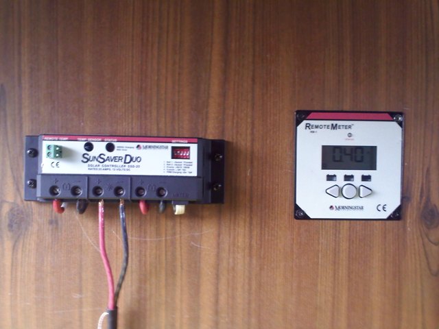

A controller, as I understand it, is very important to regulate the solar energy being transferred to your battery and electronics. Without regulation, a solar flare could break electronics and your battery could also become overcharged. The solar and battery are the biggest expenses and the controller isn't too hard to hook up, so I think you should definitely go with a controller no matter what.

The solar that I installed worked better than I ever imagined. I ran my laptop, an overhead LED light and fans off of it very consistently when I was traveling. I never pushed it hard and tried to take it easy, but on most days in the heat of summer in the South, I never shut those fans off. And I used my laptop for hours in a day sometimes. I never ONCE ran out of battery power.
I also never had a single problem with the installation running into issues. The wiring always worked and the solar panels stuck to the roof perfectly. Even at high speeds (I usually went 55-60mph on highways) and with heavy crosswinds that really pushed the bus around, the panels never budged an inch.
Even over three years after install, the solar still runs without a single hiccup. I would consider this a huge success of an experiment. I never did hook up all the lights and radio to the solar, but I'm sure it could be done if someone wanted to and used conservatively, I think this solar setup could handle all of that well too.
