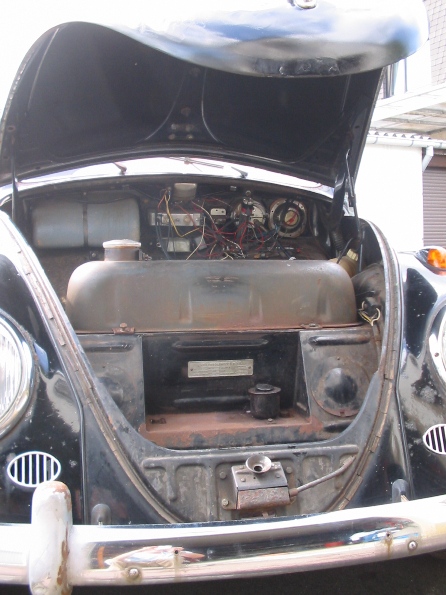

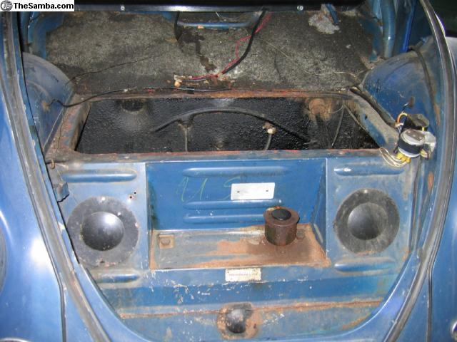

mattpeace wrote:
the brake fluid reservoir area is stamped differently for 58 than for 59
Correct. there are three ribs in 59 where as 58 and earlier have only 2.
58 and earlier
59-60
As far as side view mirrors, both euro cars Ive owned had the pear shaped one like pictured above while US received the round type.
