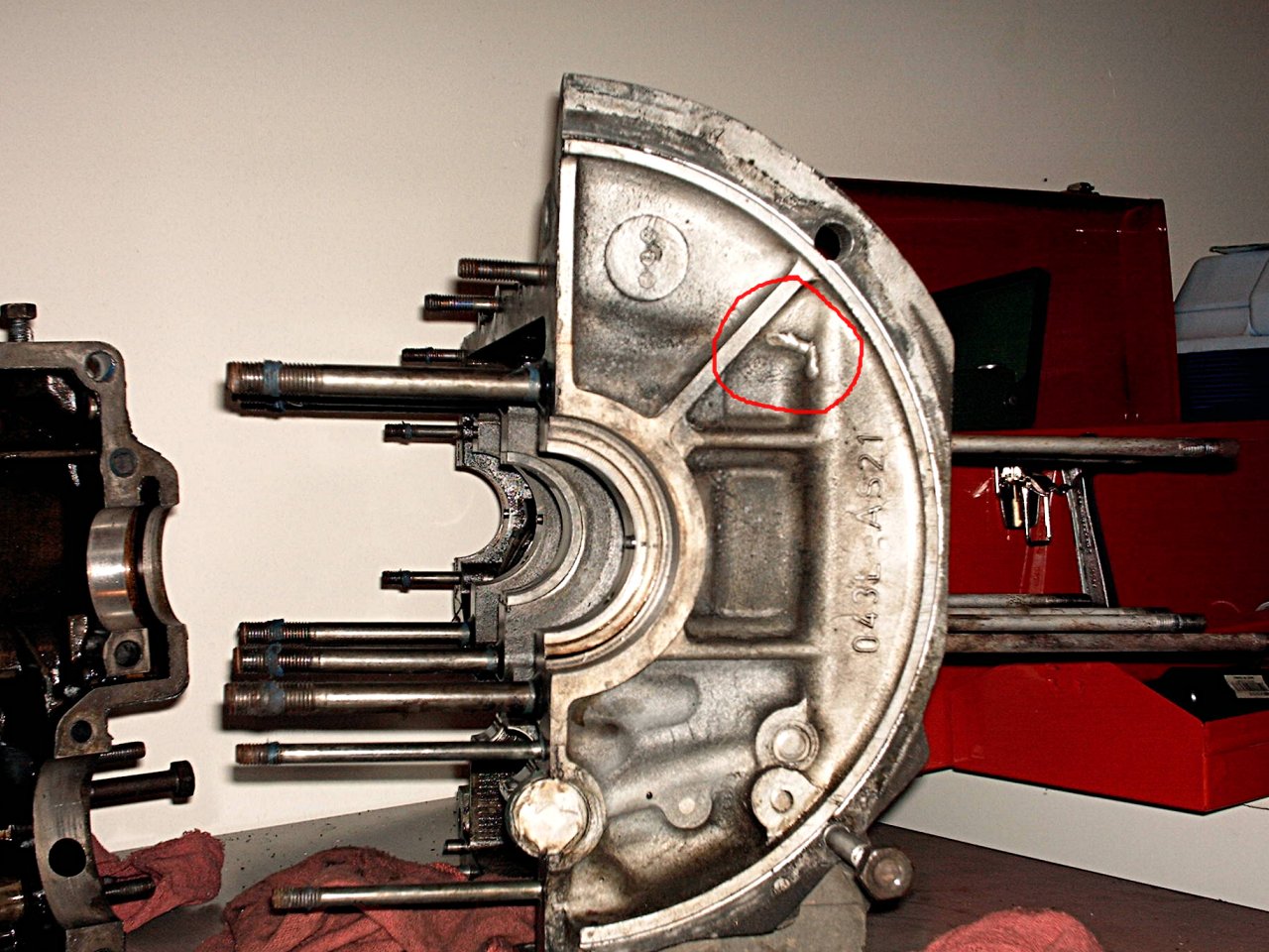

Russ Wolfe wrote: |
The VW engine case is magnesium. It burns, instead of welding.
You cannot weld something on. |
I thought you could weld the mag cases? Isn't the space behind number 3 cylinder welded on mag cases sometimes?
This isn't the pic I was looking for, but this case was welded.
[/img] _________________ Phillip Bradfield

Russ Wolfe Samba Member
Joined: October 08, 2004 Posts: 25187 Location: Central Iowa
Posted: Fri Feb 12, 2010 6:21 pm Post subject: |
You can tig it. but with special very expensive tig rod.
My guy that does my heads can do them, but he has not done one for years, and does not like to do them.
It would be hard to find some one that is set up to do them. _________________ Society is like stew. If you don't keep it stirred up, you end up with a lot of scum on the top!--Edward Abbey
Gary: OK. Ima poop. |

Notched Samba Member
Joined: January 19, 2003 Posts: 2365 Location: Pacific Northwest
Posted: Sat Feb 13, 2010 12:51 am Post subject: |
I get ya. Definitely not something someone could MIG weld. _________________ Phillip Bradfield

JSMskater Samba Grease Gorilla
Joined: February 01, 2006 Posts: 5362 Location: Murrieta California
Posted: Sat Feb 13, 2010 1:58 am Post subject: |
Notched wrote: |
I get ya. Definitely not something someone could MIG weld. |
some of the expensive MIG welders might be able to do it with special wire and stuff, but I don't know for sure. When I took my welding class, we did go over the different rods available (for TIG) so you can do more exotic metals. I asked my teacher specifically about doing Magnesium cases (he used to be a dubber himself) and the look of horror was enough to crush any ideas I had about fixing up old cases
you'd have thought he was flashing back to a traumatic war story or something... _________________ 71 Squareback-FI -- 73 Bay (subaru powered)

Tram wrote: |

JSMskater wrote: |
Notched wrote: |
you'd have thought he was flashing back to a traumatic war story or something... |
Welding a VW case is kind of like trying to weld a Molotov cocktail. You'd better have the right equipment, excellent skills, and brass balls. _________________ Немає виправдання для війни! Я з Україною.
