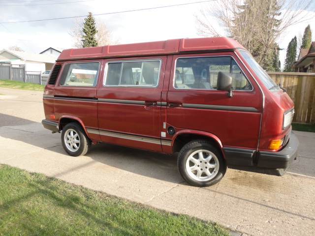

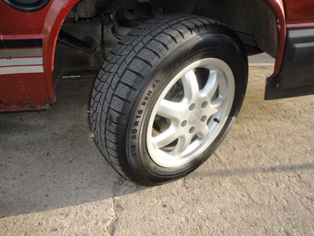

crank71
Joined: June 15, 2008
Posts: 27
Location: Edmonton
crank71 is offline
PostPosted: Fri May 14, 2010 10:19 pm    Post subject: Audi A4 16" 7 Spoke Rims Reply with quote
Thanks to Loogy for setting me up with the right spacers, lug bolts and studs. Picked these rims up off CL for $200, another $300 to Loogy, $100 for machining the bore and $800 at the tire shop. Man it adds up but its only money right?
Specs:
Audi A4 16" 7 spoke rims with machined bore
Nokian 215/60/16 99H XL Tires
15mm spacers
Extended lug bolts and studs
