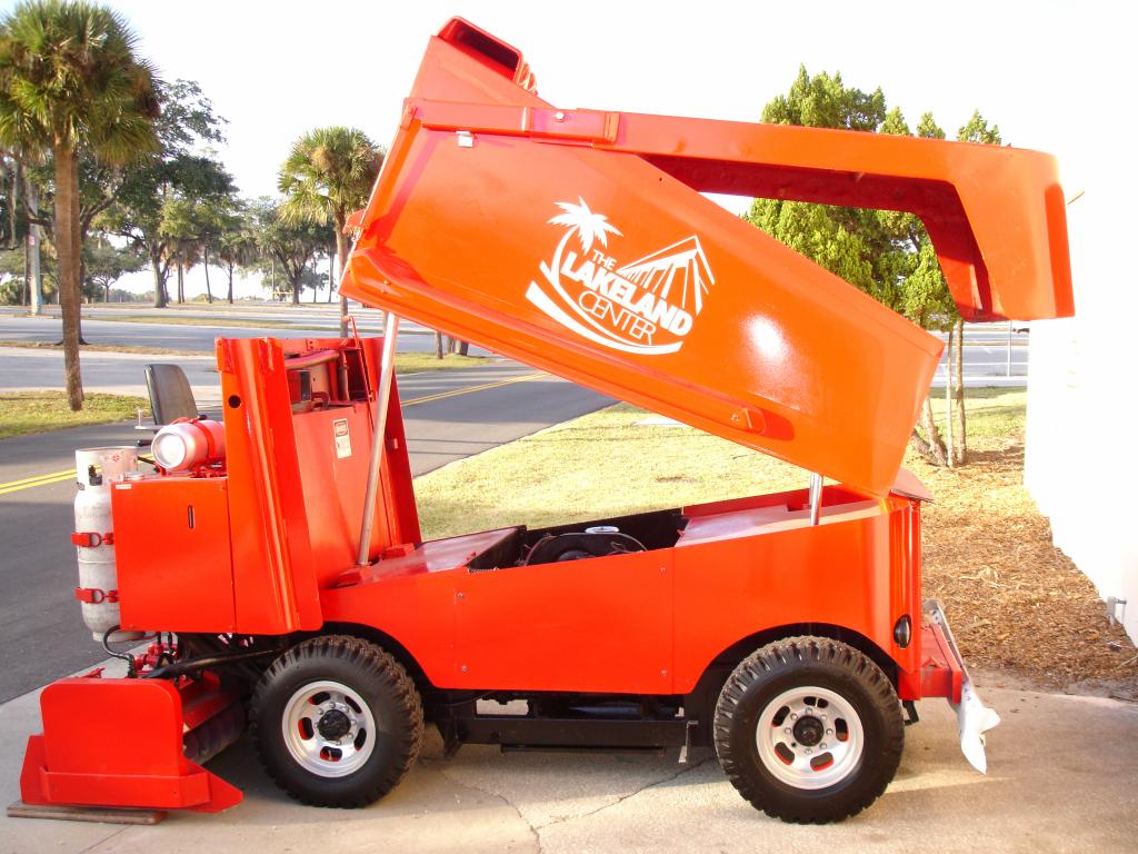

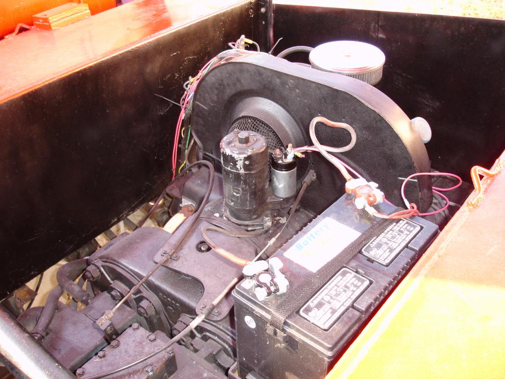

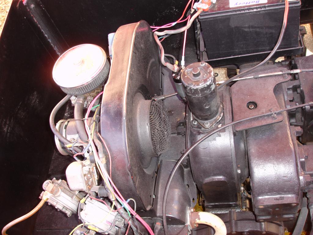

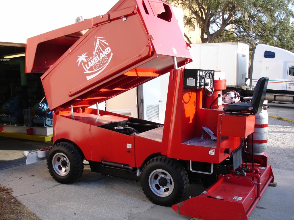

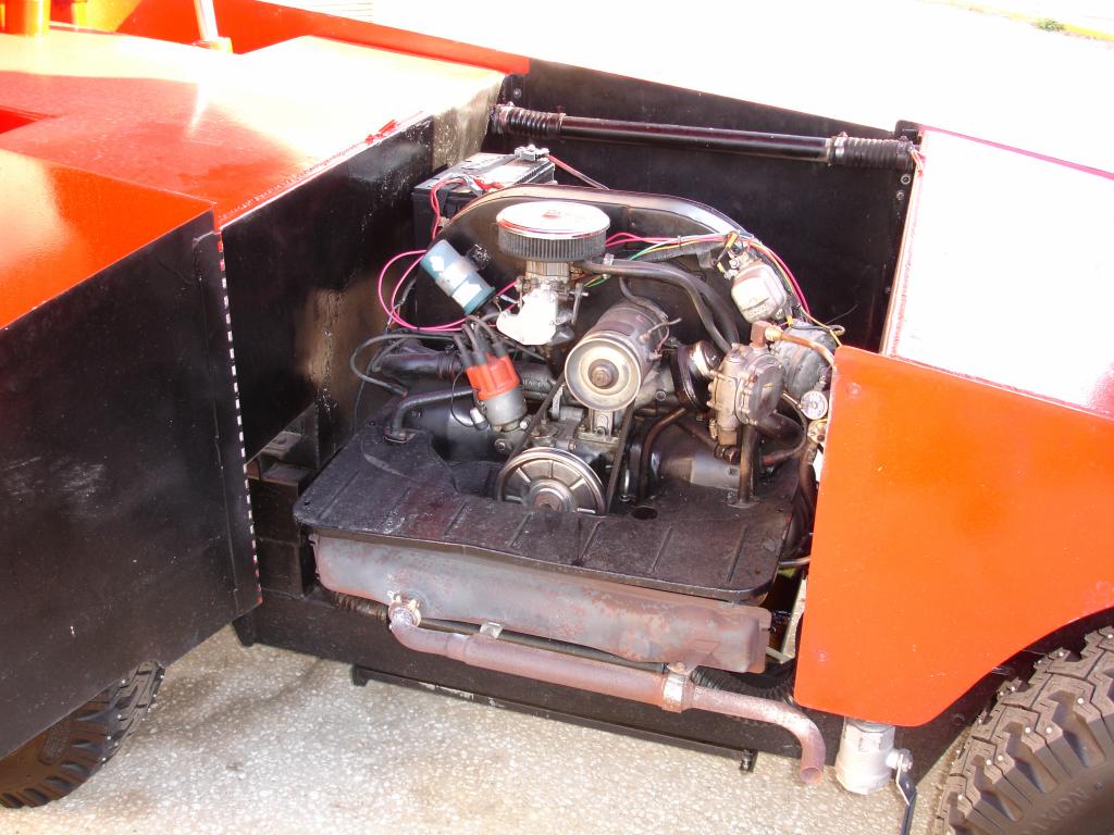

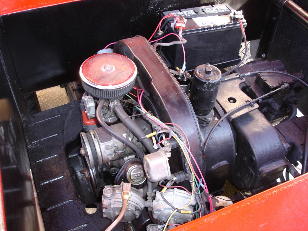

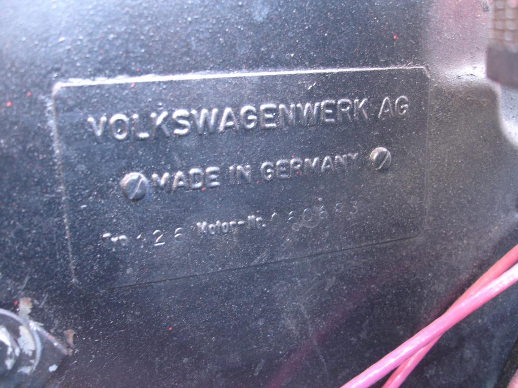

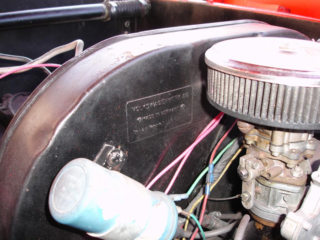

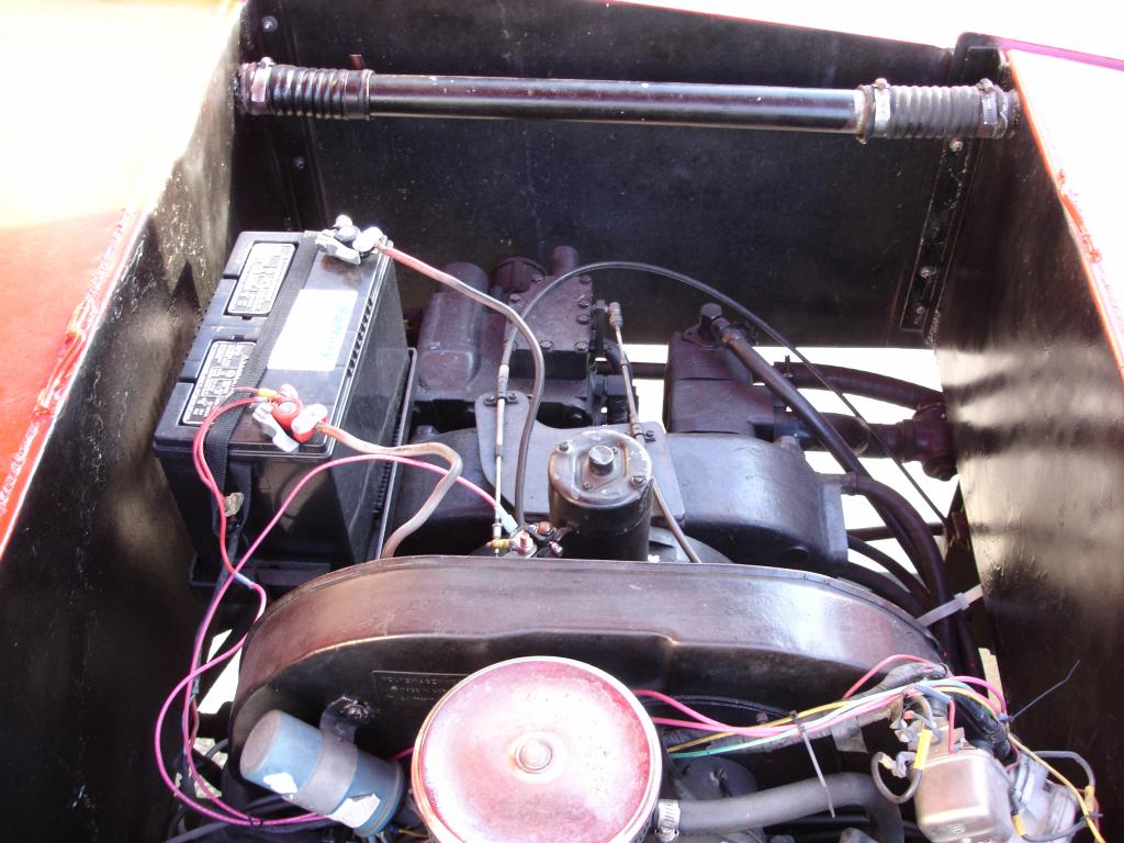

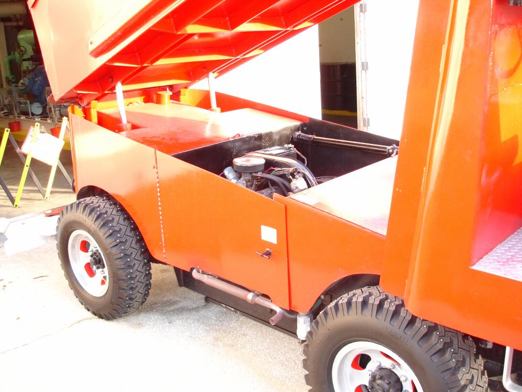

I stopped by where my buddy works and he let me take a few pics of the VW-powered zamboni that runs on propane. I would love to get a picture of the flywheel with the different ring gear.
Thanks for the pics! someone else mentioned the zamboni's before but i have never seen one. I an very interested to see how the propaine is delivered. I see the converter and the fuel lines but there seems to something else on top of the carb?

I was a bit hurried when taking those pics as it was spur-of-the-moment. Next time I'll try to get some closer pics of the propane components.

That starter is verticle??? Zamboni must make all that stuff specific to their product.
yeah i saw that to. thats some good engineering. they didnt use a vw tranny so they had to reposition it. Love it!

So is the propane converter on that Zamboni utilizing the heat riser to warm the propane? Cool

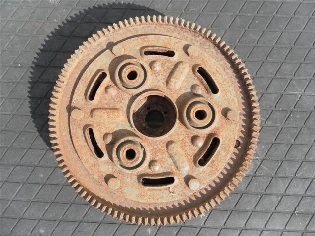

That's pretty cool, seen a few industrials but not actually mounted up in use, the industrial flywheel has odd teeth for the starter, I don't think it's a Zamboni only deal, VW might have even made the bellhousing but I can't confirm that. That's not a clutch, just a rubber cushioned coupling in the middle.
I have no idea. I don't know the specifics on how it all works. Next time I see my buddy, I'll see if he knows.
Thanks for the pic. Very interesting.

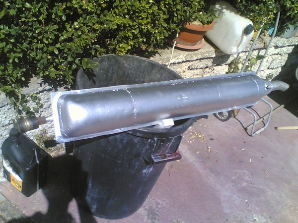

PEPPE
Joined: August 24, 2003
Posts: 1068
Location: Roma Italy
PEPPE is offline
PostPosted: Mon Aug 22, 2011 10:41 pm    Post subject: w Reply with quote
interesting old article. curious the fact that the heat the vaporizer with exhaust fumes.

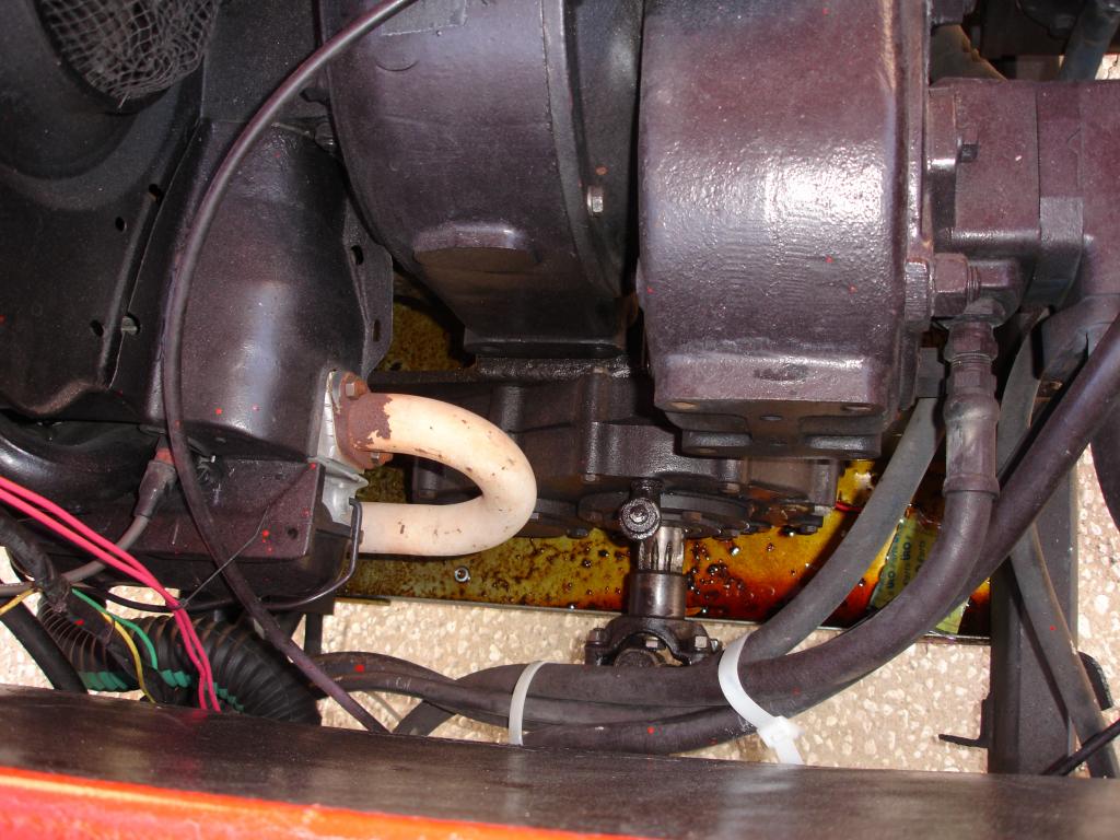

i recently converted a T2 bay. this is the muffler with the commercial evaporator, that routes the LPG in the exhaust and heats before entering in the regulator
Ellectronico
Joined: May 09, 2002
Posts: 529
Location: porterville
Ellectronico is offline
PostPosted: Mon Aug 22, 2011 10:47 pm    Post subject: Re: w Reply with quote
Hey thats a cool. Does it work well?
www.56panel.com
www.killerjunk.com
"you need to lower it", "it would look better lowered", "Slam that bitch!", "That would be a slutty bitch if it was lowered", "That bitch would be a bitchin bitch of a bitch bitch bus if it was on its nuts, bitch"
View user's profile Send private message Send e-mail Visit poster's website AIM Address MSN Messenger Gallery Classifieds Feedback
PEPPE
Posts: 1068
PEPPE is offline
PostPosted: Mon Aug 22, 2011 11:59 pm    Post subject: e Reply with quote
it is not the best system (better using an oil warmed vaporizer) but i have one also on a 1303 since 1996 and gave no problems.
sometimes heats too much LPG and sometimes warming is not enough causing icing and necessity to go with gasoline (happenen to me one time going to mountains with snow).
vaporizer are designed to work with watercooled cars, where water is termostatically controlled and conditions are more stable.
here in italy there are many LPG and CNG converted vws. it is some years that this exhaust method is not well seen by inspectors of vehicle department (this fuel conversion have to be approved and registred on title) and many people is moving toward water heat exchangers and oil conversions.
problem is that not many vaporizers are safe to use with oil due to resistance of seals in time and structural problems using oil pressure that is more than the one that is built for (water).
italy is the leader of this fuel conversion, but i believe that there will be no progress for our cars, because the modernity is the injection system that is use with euro 4 and later cars.
carburettors in italy have been phased out since 1992.
