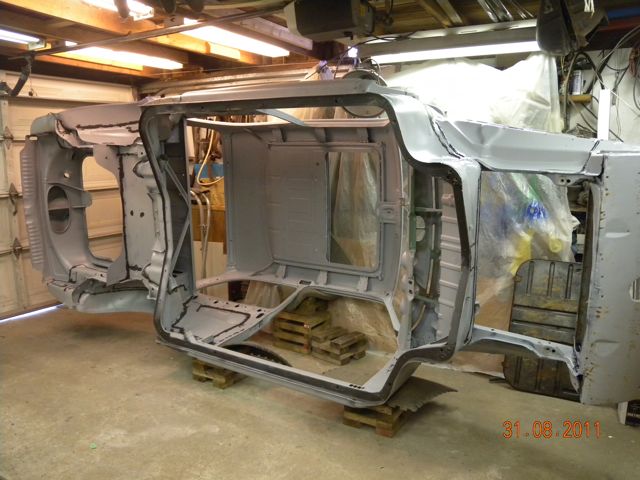

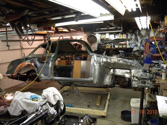

I've got some more pics to add to this thread as we get closer to where I am today. Once I had the shell finished I needed to work on the engine area. As you saw above it was also pretty rotten. I decided that I wanted to use an IRS setup because I had a freeway flyer tranny. To do that I had to fabricate the hangers and such. I looked at Bob's setup and went from there.

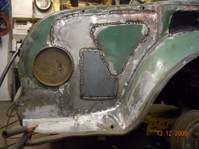

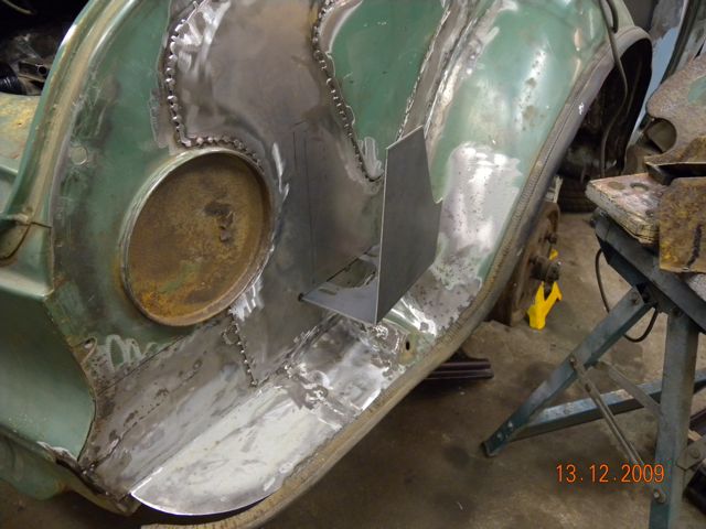

First, I had to move and repair the water drain and air flow sections (yes, it was very rusty):

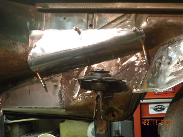

And then I reinforced the inner fender well area with 12 a guage plate
Designed and fit my new hanger. It's 12 guage and slides through a slot in the fender well area and is then welded to the reinforced section:
and here is a shot from the inside

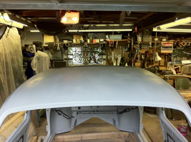

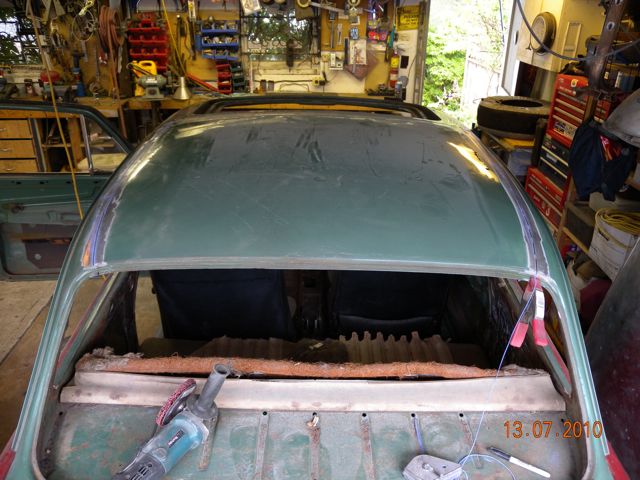

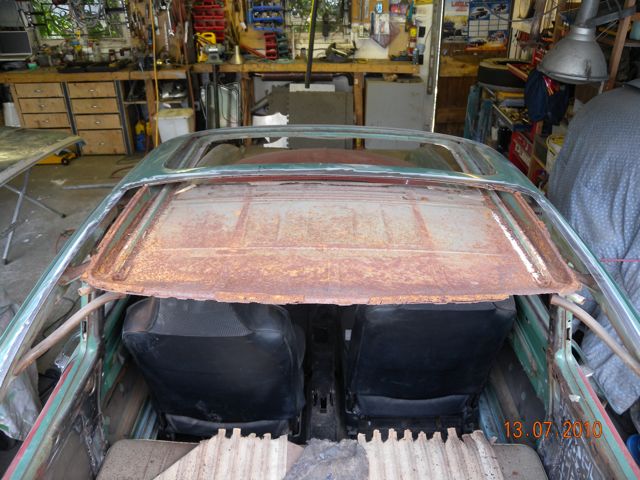

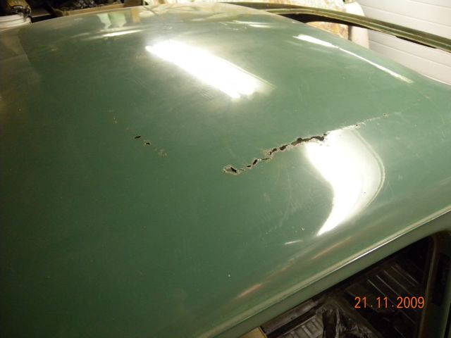

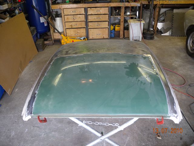

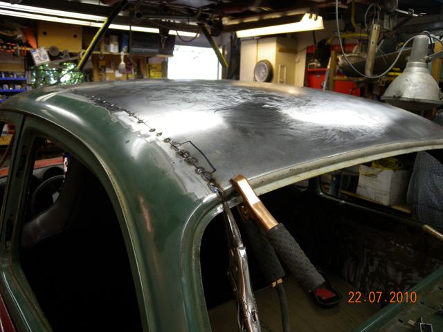

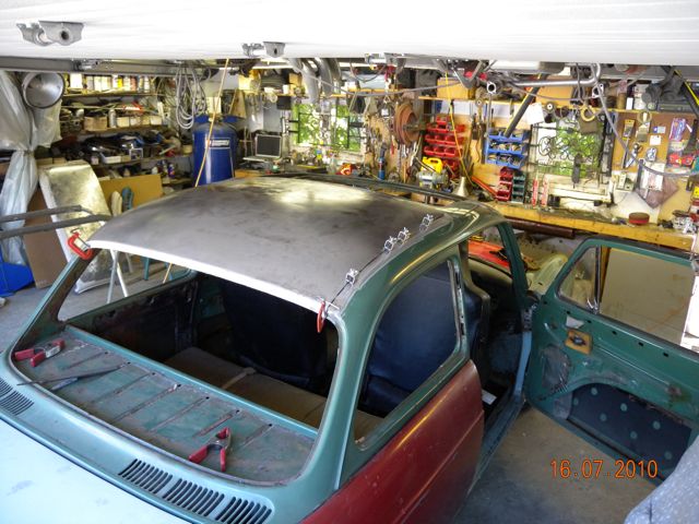

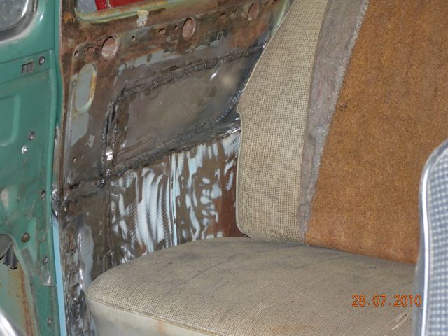

At this point I thought that I was mostly done with body work until I polished the roof, only to discover... yes, rust
What else could I do but.. remove it
Cut the section out

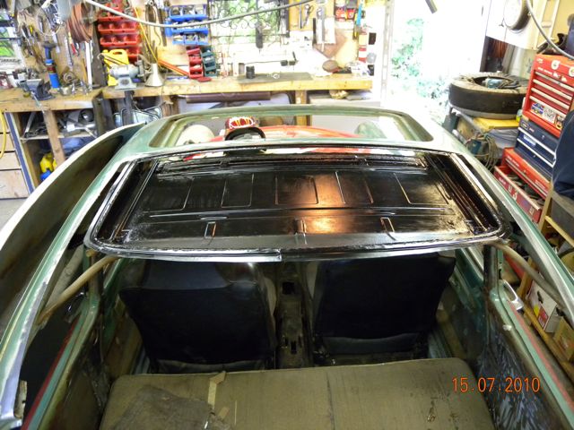

repair the inner shelf

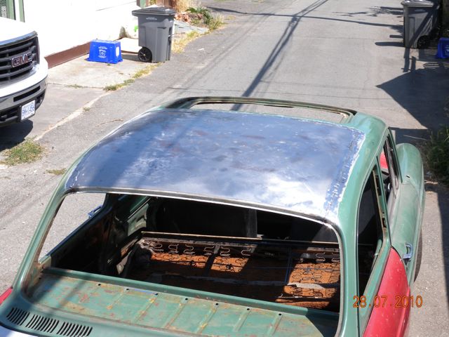

layout on another roof
and welded another roof section in place
and painted it.
So, the question is now -am I finished with welding? How many cars contributed to this notch? original shell, pan, bottom section of a squareback, nose from another, roof from yet another - that's 5 so far and we have not yet look at fenders, doors and hoods. This may take a bit longer yet.

Porschedave wrote: |
and painted it.
I hope that you're enjoying the story so far... |
Probably not, but we'll see.
On my sunroof Notch, I just patched in the rust holes, as I didn't have access to another roof. I sure hope you checked the front of the sunroof opening, as mine had rust there as well.
At least your sunroof tray looked better than mine, as on mine, the corners were rotted off/out, and had to be rebuilt.
Dave, the positive comments are given, as you've done one hell of a good job here on this car. I love these kind of projects, and I admire those who are willing to take them on, and see them to the end. Not everyone can just do this without worrying about not finishing it. There's just the sense of satisfaction you get when taking on a project like this, and actually seeing it to completion. Even IF you don't end up keeping it 100% stock, you've saved one, and you built it yourself. I look forward to seeing it in person (hopefully next year at the Invasion ). Good job, and keep up the great work. _________________ Bob 65 Notch S with Sunroof

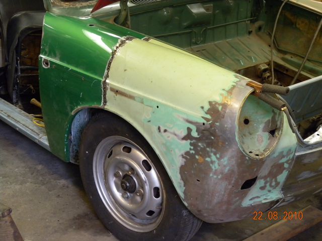

and following, once again in Bob's footsteps, I "made" a fender from two otherwise bad fenders:

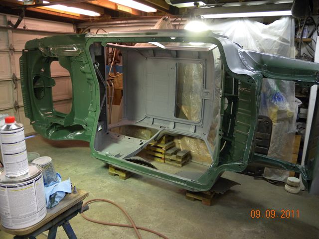

Now, I could finally do something other than welding and panel beating. I shifted gears and got ready to blow epoxy primer over the shell. As I was really concerned about the undersides, I rolled the shell over on its side:
blew on epoxy primer, and then seam sealer, and then ...
some single stage Velvet Green (L512) colour

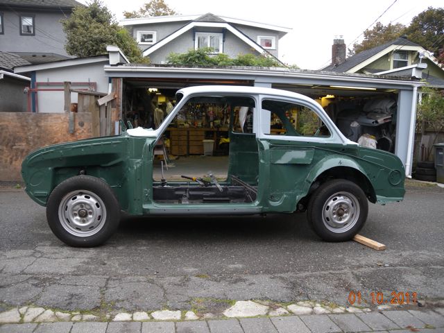

and brought the car upright
and finally back on its pan.
This is where I am at today, only 5 years after starting this project. I have decided to go back to the original colour. The plan going forward is to epoxy primer the fenders, doors, hoods and sunroof and mount them on the shell. I will then use high build to block the whole car and finally get it painted. Of course, there is still an engine to build (1776 I think), ride height to be adjusted, a wiring loom to make and so on. The T3 invasion is possible but only a distant possibility as I still have my day job.

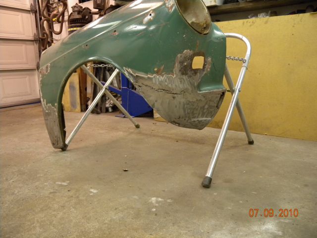

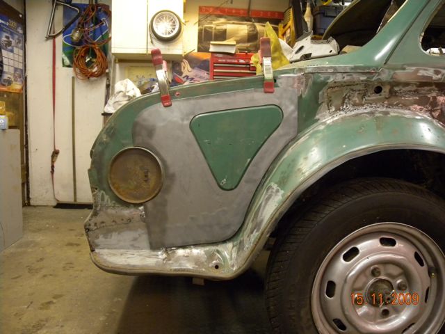

Well, after some delay I have returned to working on the notch. My focus now is to get the fenders ready to mount so that I can blow hi-build primer on the whole car. This fender, however needs some work, like repairing the section over the headlight
and at the lower rear corner

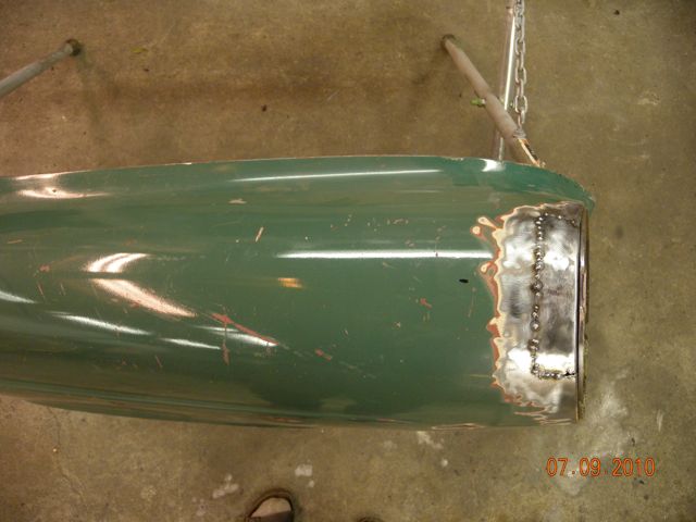

and I had to cut out the front chin section and weld in a section from another fender
and now with some primer
[/img] |
Dave, all of that looks familiar, other than adding some new metal across the top of the fender. However, that's just part of dealing with these "old cars" that the aftermarket hasn't tooled up for. Like I said, I've done all of that before except the top of the fender part. I have however grafted the entire headlight bucket into a fender before. Makes grafting 2 half fenders seem easy doesn't it? Good job though, and keep up the good work.  _________________ Bob 65 Notch S with Sunroof

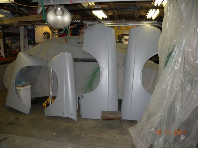

I am now working on getting the fenders, hoods and sun-roof section done in epoxy primer. It was a lot of work to get the gunk off the inside of the fenders as the front two had some undercoat sprayed on. Lots of scraping and heat from a heat gun. In the end they turned out pretty clean and now in primer they look pretty cool, although there still needs to be a little hammer and dolly work because the paint shows up some of the rough spots.
Yeah, both my 64 T-34 and my 71 Notch had what looked like spray on white/clear under coating (like rock guard), that was put on before final paint. I used a propane torch and a scraper to get it off. Not fun to deal with, compared to regular undercoating, as that stuff comes off very easy. You're really gaining on it though. Won't be long until the outside gets shot. Then the hard work can begin... reassembly.  _________________ Bob 65 Notch S with Sunroof
