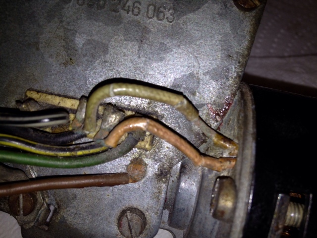

Be careful with the wires, they are old and the insulation will come off if you twist them too much

Did the one on my 73 super today. Couple things:
1. You don't have to cut any wires, just unplug it from under the steering column.
2. Be sure to mark the position of the gear teeth to the housing with a marker. I used a pencil and it wore off. So I just put it in whichever way, now my wipers stop in the middle of the window. Now its a guess and check with me.. Good thing I found this forum as rlutterb has a nice photo I can use to guesstamate where the gear lines up.
