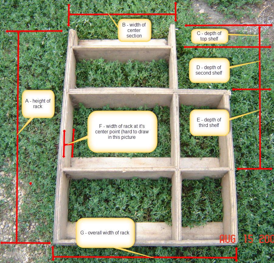

I am hoping someone will help me out by measuring their OG SO42 spice rack. I am very aware that there are at least two people in this community that sell after-market racks, however in keeping with the spirit that this is a hobby; I have the ability to build my own (I can't weld but I can cut and nail wood Wink ). Also, I'm not looking to dredge up old wounds or topics such as this one: http://www.thesamba.com/vw/forum/viewtopic.php?t=65846&highlight=spice+rack+measure
but I'm looking for information sharing like this topic: http://www.thesamba.com/vw/forum/viewtopic.php?t=355201&highlight=rear+facing+seat
(which I've built my own bench from).
Here is a picture I borrowed to show the measurements I need. If you are willing to share, I could use the dimensions for: A, B, C, D, E, F, and G.
Thank you in advance.

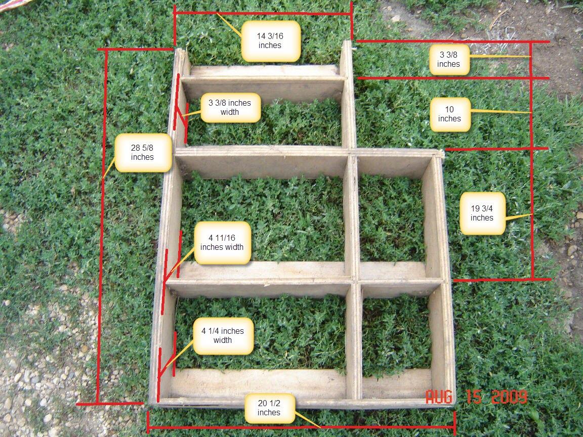

Hi Bud,
Here are your measurements.
A 28-5/8
B 14-3/16
C 3-3/8
D 10
E 19-3/4
F top is 3-3/8, widest point below center is 4-11/16, bottom is 4-1/4
G 20-1/2
Please let me know if you need other measurements.

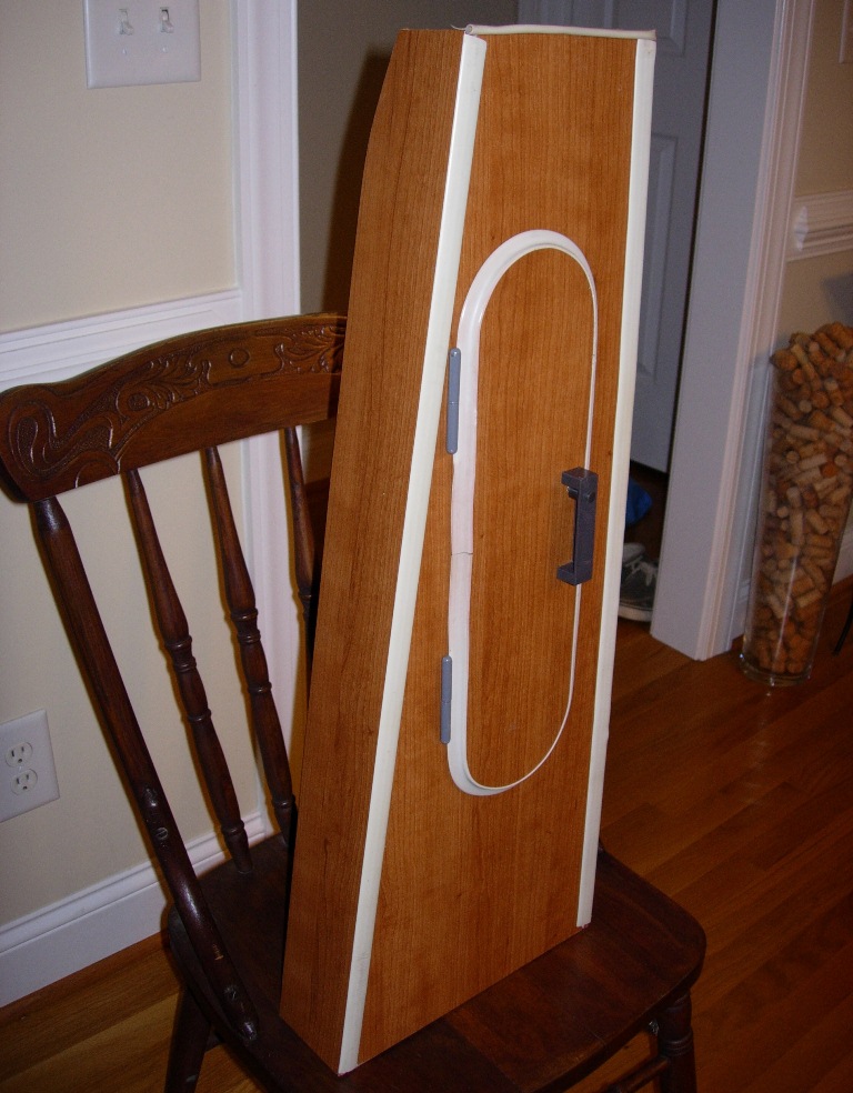

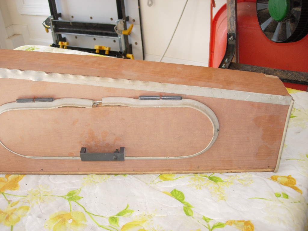

Maj. W., Thank you so much for the dimensions. I really do appreciate the help. Also, thanks for the info on the laminate however I've gone a different route. I am using a cherry finish. Since I don't have a "real" Westy (I have a '66 Kombi) I decided I would do a custom interior based on the SO42 style. I have a couple of original SO42 cabinets (head banger and corner cabinet) that I've refinished. Everything else (except for the bed pedestal) I've built from scratch. I could have gone the easier path and bought my cabinets from either the guys producing them, but as I said earlier I know my way around a table saw. It's taken me about 18 months to have the panels, flooring (which I went with your flooring), rear facing bench - scratch built, refinishing the HB, corner cabinet and bed pedestal, and the wardrobe - scratch built cabinets completed. I have curtains, the spice rack and the ice box to complete and I'll have the whole thing done. I'll post my whole build/restoration project (which includes the bus body work) when everything is done. Below are pictures of the corner cabinet before (OG laminate) and after (cherry laminate). I'm pretty happy with how everything is coming out.
Thanks again. I'm sure I'll have more questions later.
Bud
Before (pretty dusty and wrinkled T and door moulding):
After (cherry laminate and re-used/same T and door moulding - after the boiling water trick):

That looks nice! Well done.

For completeness, I've updated the borrowed picture with the measurements you provided (below and in the gallery).

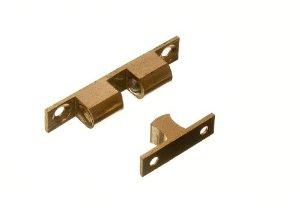

Could folks show pictures of what latch they are using to keep their SO-42 table folded down against the wall? I don't have all the parts of my original, so I've been using egg-carton cardboard stuffed under the table to keep it in place.
This past weekend, however, at the Kelly Park Aircooled Meet in San Jose, CA, I saw the following latch (below) being used as a replacement in one.
Seemed like a good option. Thoughts?
Other solutions?
Sources for close-to-stock correct latch for a 1967 SO-42 Westfalia?
Pictured Latch Link on Amazon:
http://www.amazon.com/ADJUSTABLE-DOUBLE-SPRUNG-CATCH-SCREWS/dp/B007KQDITM
Dada as in dadaism.
Cheese as in the stuff I love to eat.
crofty
Judas of the North
Joined: August 09, 2000
Posts: 19568
crofty is offline
PostPosted: Wed Apr 24, 2013 3:33 pm    Post subject: Reply with quote
Yes the rearmost edges of the rack are curved to meet the curvature of the door.
That latch will work just fine.

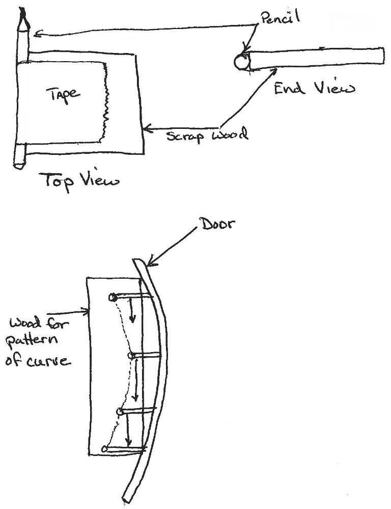

DadaCheese,
Thank you for the heads up on the curve of the door. I was anticipating that I would have to curve the back side of the rack.
For those that may do their own woodworking I've attempted to draw a little technique that a good friend showed me for creating a template of the exact curve of a surface. I've used this a couple of times when I built my wardrobe cabinet (get the curve along the door frame) and the rear facing jump seat (get the curve of the long wall). Hopefully you can understand my drawing (when I build the spice rack I'll take photos of the "trick").
First create the piece used to draw the curve. I use a scrap piece of panel material about 3x4 inches. I duct tape a pencil to the 3 inch edge.
To create the pattern: put your pattern wood (perpendicular) against the curved edge. Position your drawing piece against the curved surface (with the pencil against the pattern wood) and slowly move it down. Keep the drawing piece horizontal to the ground. When you get to the bottom you should see an exact copy of the curve on your pattern piece. Cut the pattern out. It is best to do this with two people (one to hold the pattern wood in place and one to move the drawing piece along the curved surface.
Hopefully the diagram and description are clear enough to understand.
Hope this helps someone.

Scribing trim to match a curve is a daily part of life for trim carpenters. I knew that Bud was planning for this which is why I only gave him three data points. I would start with a piece of scrap wood, scribe onto it, take the depth measurements off of it, cut it out and fit it to the door until satisfied, and then trace that shape onto the material actually used to make the rack.
