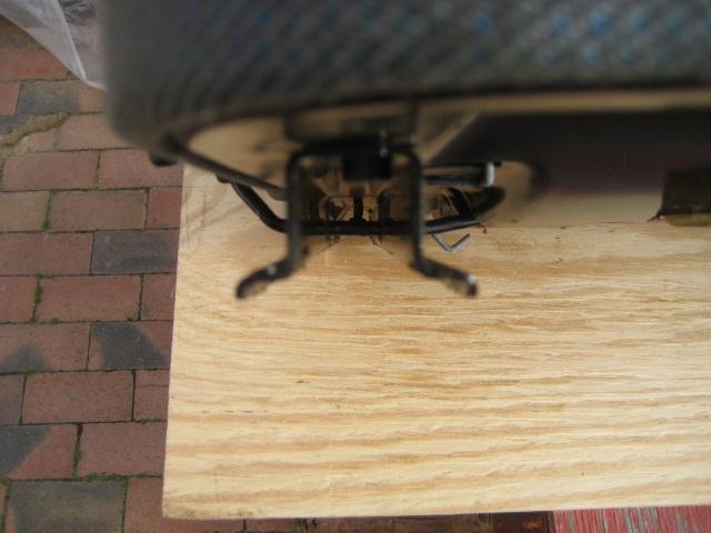

SAFETY BULLETIN! PLEASE READ!
I have discovered a potential safety problem with running early Eurovan seats in Vanagons. Please read this if you are currently using them or shopping for a set.
While on our last vacation in our Westy I had to make a quick stop and put the brakes on hard. My wife was in the Eurovan seat on the passenger side. During the stop the seat unexpectedly slid forward on its rails, but she was stopped by the seat belt. We realized after it happened that we could sometimes recreate the phenomenon by violently rocking back or forth on the seat while sitting on it.
Yesterday I finally had a chance to investigate, and I found the source of the problem. Anyone that is running these seats should investigate this and consider retrofitting the seats in a similar manner.
On the bottom near the rails there is a silver spring on each side that holds the seat locking mechanism in place until you lift the handle to make a fore/aft adjustment. The spring sticks down too far past the rail in a Vanagon application (keep in mind that you remove height when you modify the rails). When the seats get mounted into the Vanagon, the spring can get pushed upwards and cause the seat to not completely lock into position.
To be completely sure that this doesn't happen, the end of this spring should be cut off so that the seat will always be completely locked into position. I used a Dremel with a cutting wheel.

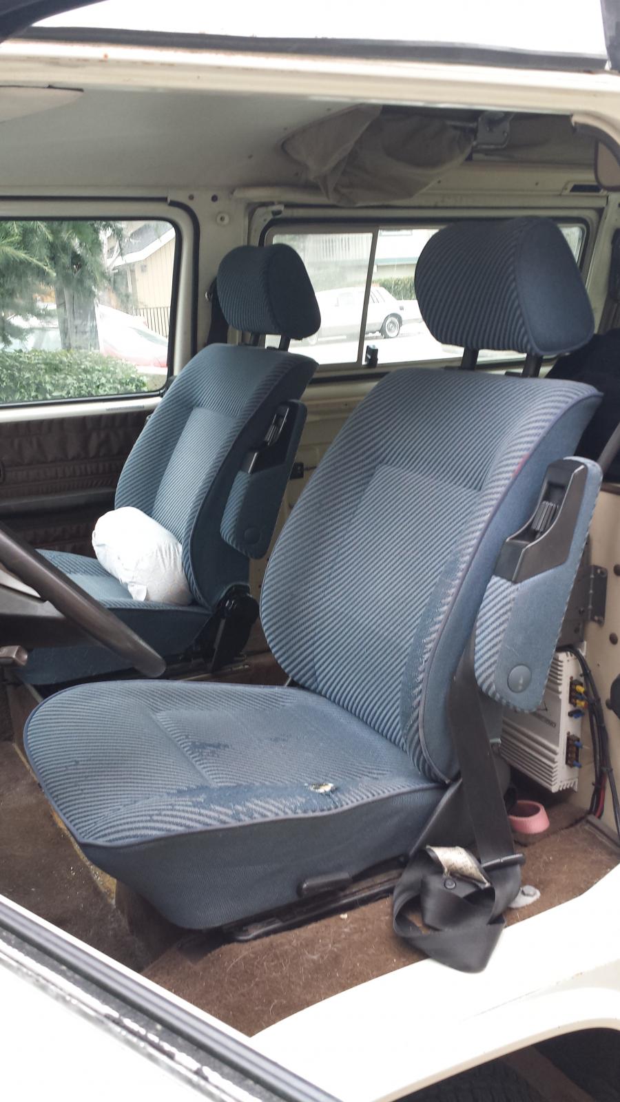

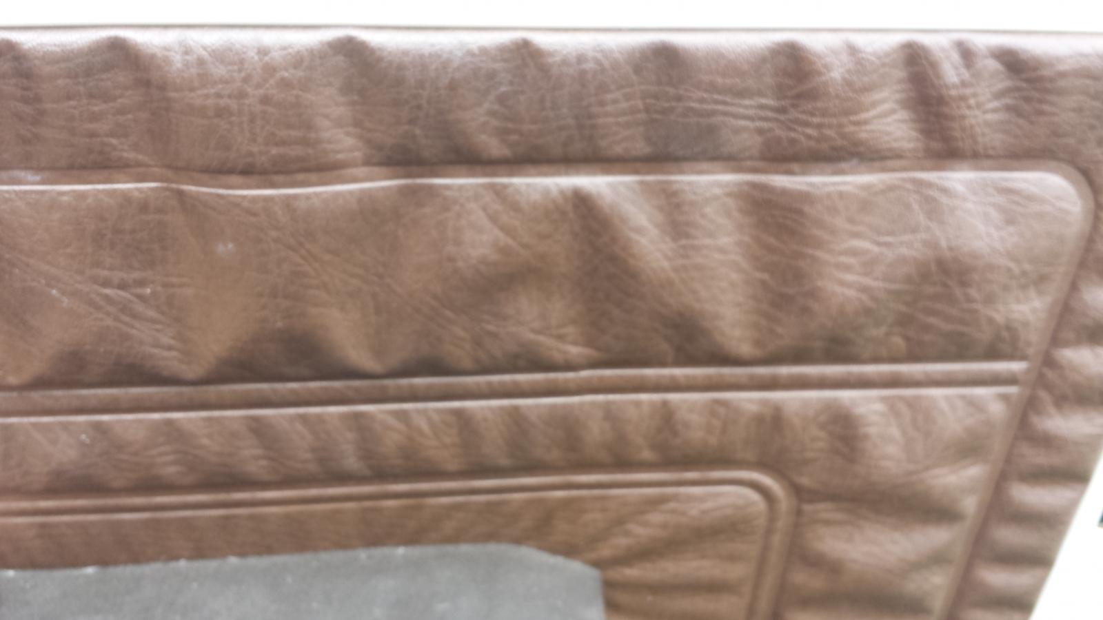

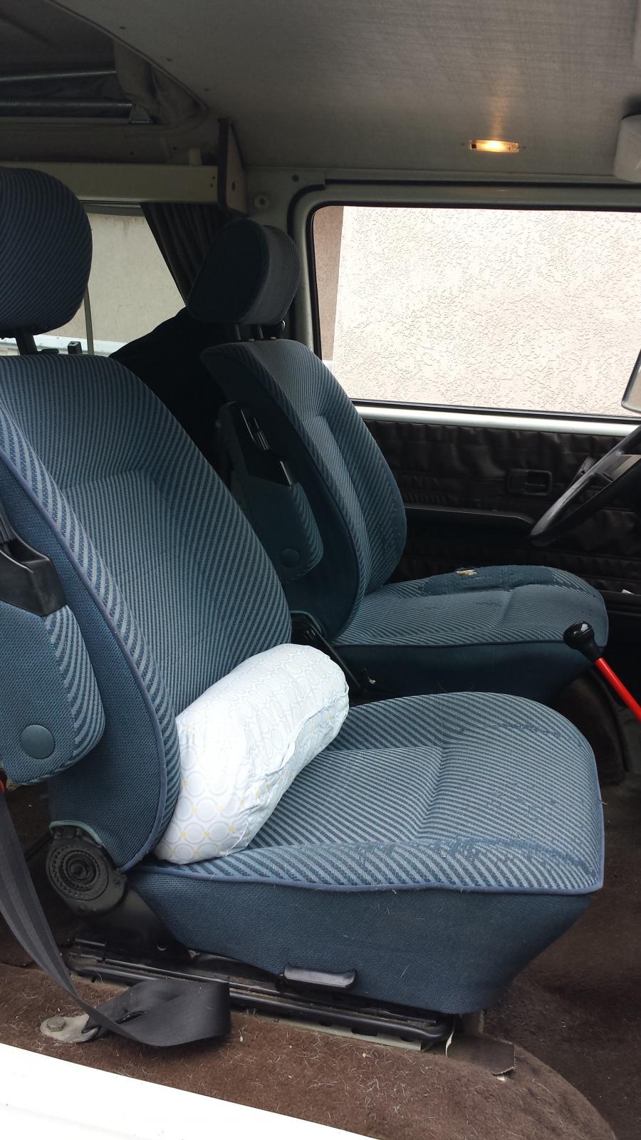

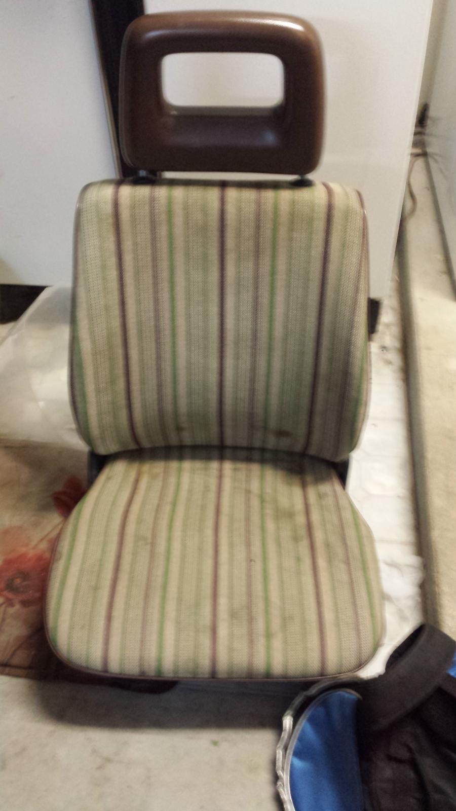

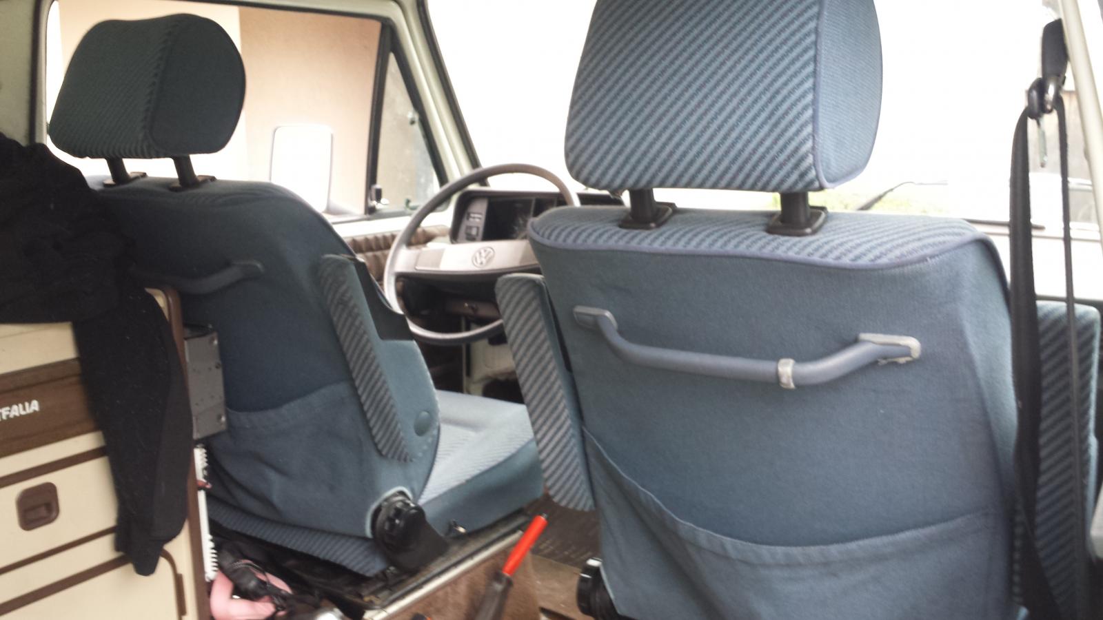

PostPosted: Wed Nov 12, 2014 11:19 am    Post subject: Reply with quote
I just got two, gently used Eurovan seats from pick-n-pull for $106. Its amazing the difference. All I had to do was remove the seat belt latch and extra bits on the tracks with a cuttoff wheel and grinder.
Eventually, I will get them re-upholstered to match my new fabric and foam for the back seats and bed. My ride be pimp-n.
Seats looking from upfront
Seats looking from behind
Brown Vinyl that I intend to use.
The old seats, I thought they were fine, but then I put my eurovan seats in and I can't go back. I can't believe they sold cars with these seats in them.

My 95 EV set I got for 40 bucks complete and were in great shape. Foam was good but fabric a little worn.
I did the same as Andrew Libby and shaved the bottoms of the track off, yes a BIG improvement over my 86 stock seats.
Trying to find decent full covers for them as my blue seats don't look overly nice with my brown 86 interior !
The new seats do sit higher, this messes with my field of view of the Speedo and also brings me closer to the headliner.
