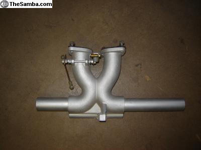

Ok so here are some Ideas for single port but dual carbs!
New Just for Reference and here are some used Manifolds Weber ICT Manifolds Used. These might let you run more cam? When you think about it. What's so bad about single port heads and manifolds? After all the intake valves don't open at the same time so why not share the same intake!

The thing to do here is to keep this blog going and get more information out of the people that have actually played around with 94 mm pistons on a single port.
The link to the first photo with some very useful info.
My favorite looking single manifolds are ones like these:
or these:
1960 Beetle And 1679cc DP W-100 & Dual Zeniths!
