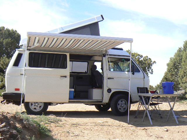

PostPosted: Mon Apr 28, 2014 7:52 pm    Post subject: Reply with quote
This Saga is finally coming to a close. In all, I stripped and redid the interior, added the poptop, went through pretty much every mechanical system, lifted it, added truckfridge and awning, a 3 window canvas, upgraded to fiberglass bumpers and power mirrors, redid the exhaust twice, added sound deadening, replaced both heater cores and fans, put in LED lighting everywhere, installed real gauges, and did a thousand little touch ups.
Hopefully the last major expense for this one will be the APR performance chip (200 HP) that is going in this week. Stay tuned for the first trip report on that, I canít wait.
This is my 4th vanagon and each has taken 3 years of steady effort to get them to where they should be. And this was the most intense. Iím starting to wear out on these old things. Really, I think I can only do it one more time. Very Happy Brick wall Very Happy Did I mention I'm getting it chipped this week. Very Happy

Great job!
I love how it turned out. Well thought out and looks great
I have to thank you too for the Aleko thread, absolutely love the awning
