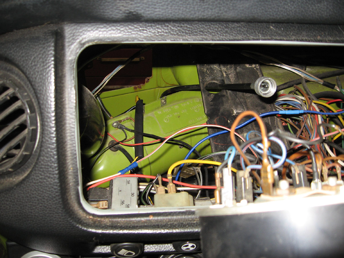

I have no tag behind any of the front seats..
The only thing that I have found, besides the one that is under the dash is this...
Back to top |
Randy in Maine Samba Member
Joined: August 03, 2003 Posts: 34890 Location: The Beach
Posted: Fri Apr 29, 2016 11:44 am Post subject: Re: M-Plate Location |
This one is where yours is......riveted to the fresh air ducting under the dash (3" above the "yellow wire and painted green to make it easy).

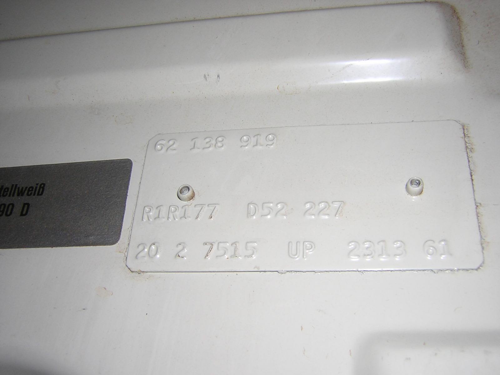

Could a kind soul helpe figure out exact date of manufacture from my m code plate?
The info Ive found on this site doesnt seem to apply to my plate
for example date of manufacture doesnt make sense; top left
or is it just simple as the 12th?

Date of birth: "planned production date" Monday Feb. 15th 1971 .
So, the decoder I use says for your bus. and it's pastel white L90D and your chassis number is #2312148072 on the dash tag? Correct? |

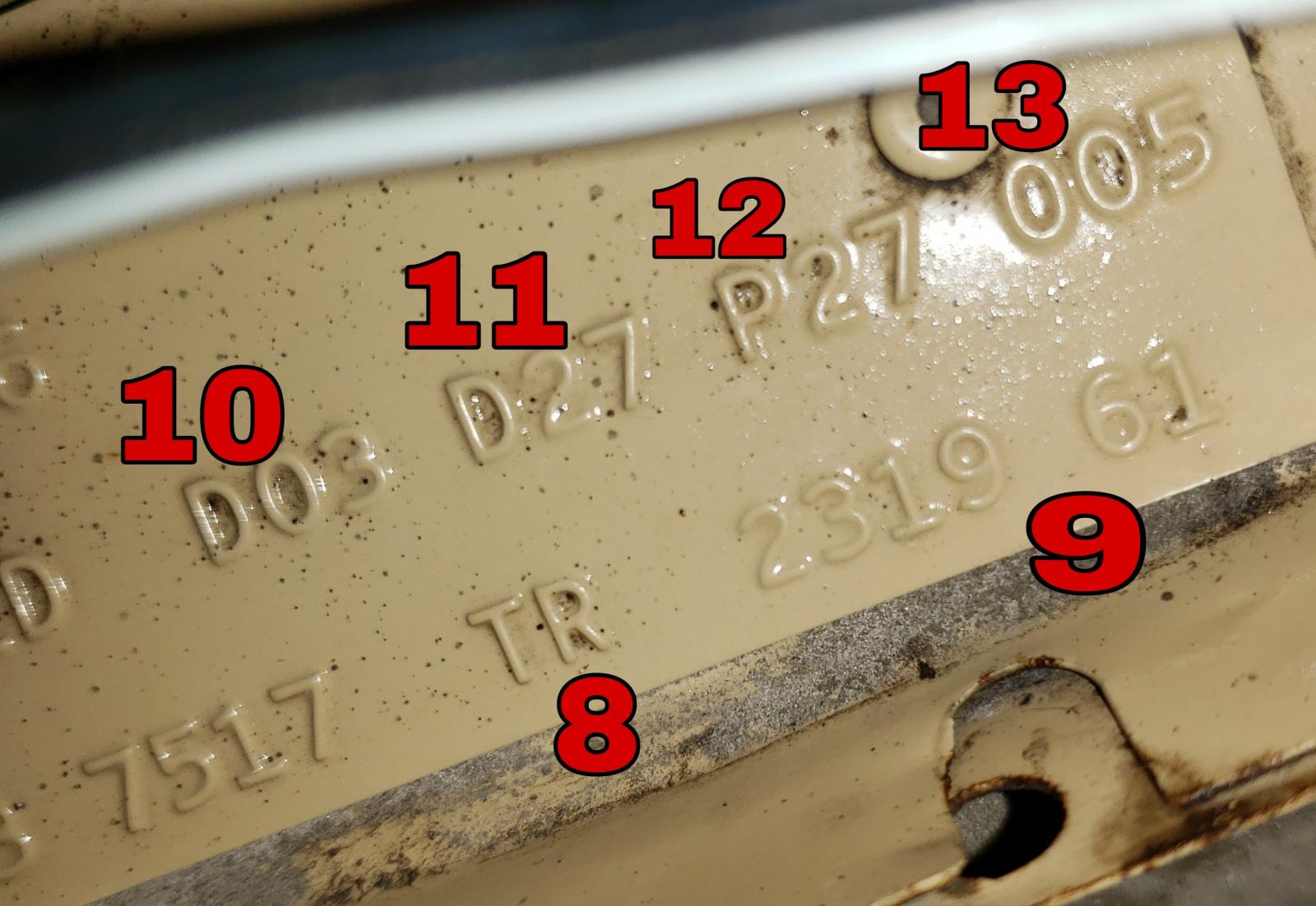

I believe I will need a little help and will be grateful for it from others who may know what I can't sort out. I expect to take a better photo of my M-code plate when I remove my dash pod, but for now, I put my phone under the dash to get these photos. I believe one must be a part time contortionist to get proper photos of the M-plate this way.
This is my interpretation of my M-plate information:
1. Serial number
2. 227 = detachable headrests
3. 246 = laminated windshield
4. paint code 9832 = Mexico Beige
5. ED = Brown Plaid upholstery
6. Production date: Wednesday, December 13, 1978 ???
7. ??? Number for production planning
8. Export destination: TR ??? I believe my Bus was originally sold in San Diego. Does anyone know if "TR" is the destination code for San Diego?
9. Body model, engine & tranny codes: Campmobile Deluxe, 70 hp, manual transmission. Specifically, right side sliding door, LHD, Campmobile, engine & tranny code: 2.0L & manual.
10. D03: I believe this is a grouped M-code designation, usually grouping sealed beam headlights, rear window defroster, MPH speedometer, etc. However, I've no information relating to this specific code.
11. D27 ??? I believe this may be for CA emissions adherence. Can anybody confirm this?
12. P27 = Westfalia interior code for Berlin Deluxe (stove, sink, refrigerator) with pop-top
13. 005 = heater duct under rear seat/bed
Again, I will appreciate any information.

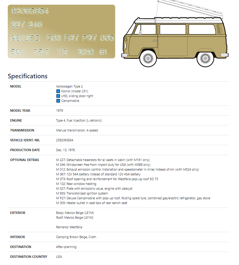

I did find this M-code decoder function and I am very grateful to whomever created this very useful site. https://vw-type2-id.xyz/mplate/decode/
However, I'm still looking for the "TR" destination code information.

ToolBox Samba Member
Joined: January 27, 2004 Posts: 3408 Location: Detroit, where they don't jack parts off my ride in the parking lot of the 7-11
Posted: Fri May 06, 2022 12:45 pm Post subject: Re: M-Plate Location FAQ |
creative native wrote: |
TR is listed as Transit Reserved, UF is San Francisco and UA is LA.
It was probably port allocated after production. Does it have the Cal House Car tags on the dogleg? |

Posted: Fri May 06, 2022 1:31 pm Post subject: Re: M-Plate Location FAQ |
ToolBox wrote: |
However, I'm still looking for the "TR" destination code information. |
It does not. However, the original owner had the Bus repainted and I suppose he could have removed the tags at that time?
Thanks for the "TR" information. |
