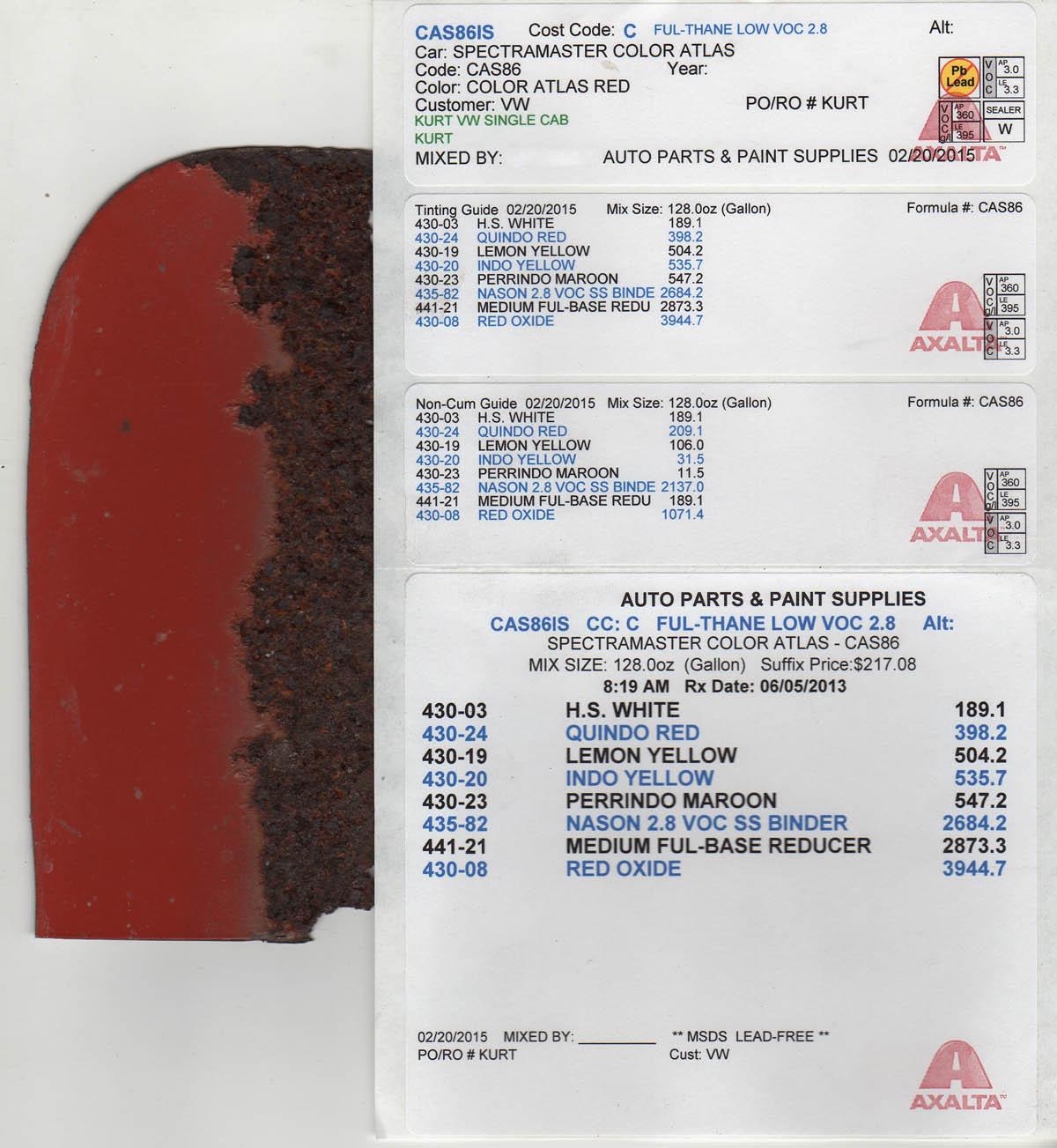

PostPosted: Fri Feb 20, 2015 11:17 am    Post subject: Sealing Wax Red L53 formula paint code Reply with quote
Same two pieces indoor outdoor lighting.
I have been working on getting the color right for months. People from all over the planet have sent me samples and scraps of metal claimed to be correct. These samples are more than fifty years old and aged in various conditions. I sanded them down and polished them up. From all of this I have seen quite a lot of variation from magenta , orange to pink. I think the color varied over the years that it was produced as well. The original ingredients are no longer available or illegal and if they were modern manufacturing techniques would produce different colors anyway. I settled on a color that I liked somewhere in the middle of the range. We tried a computer match first and it was way off. It required a lot of adjustment from that and other colors not suggested by the computer were added. What we found is that this color is sensitive to very slight changes in the pigment added. Mixing small batches was futile. I don't understand why some people are keeping their recent paint mixes a secret. We can all benefit from sharing our findings. If you work with this mix and adjust it please share your results. I got two gallons today with catalyst that will produce 3 sprayable gallons. "Funky" has a lot of surface area! Temperature and humidity levels are getting better here in California so I can pick good days to spray in my unheated garage as spring weather approaches.
For completeness the years used were 1950-1965. VW paint code L53. PPG/Ditzler paint code 71025. SK1034 Due to chemistry differences over time these formulas do not work anymore.

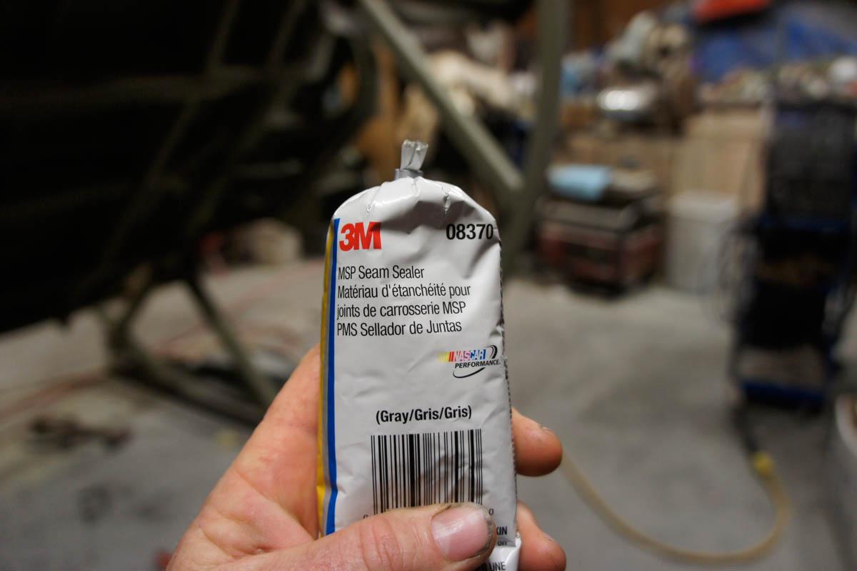

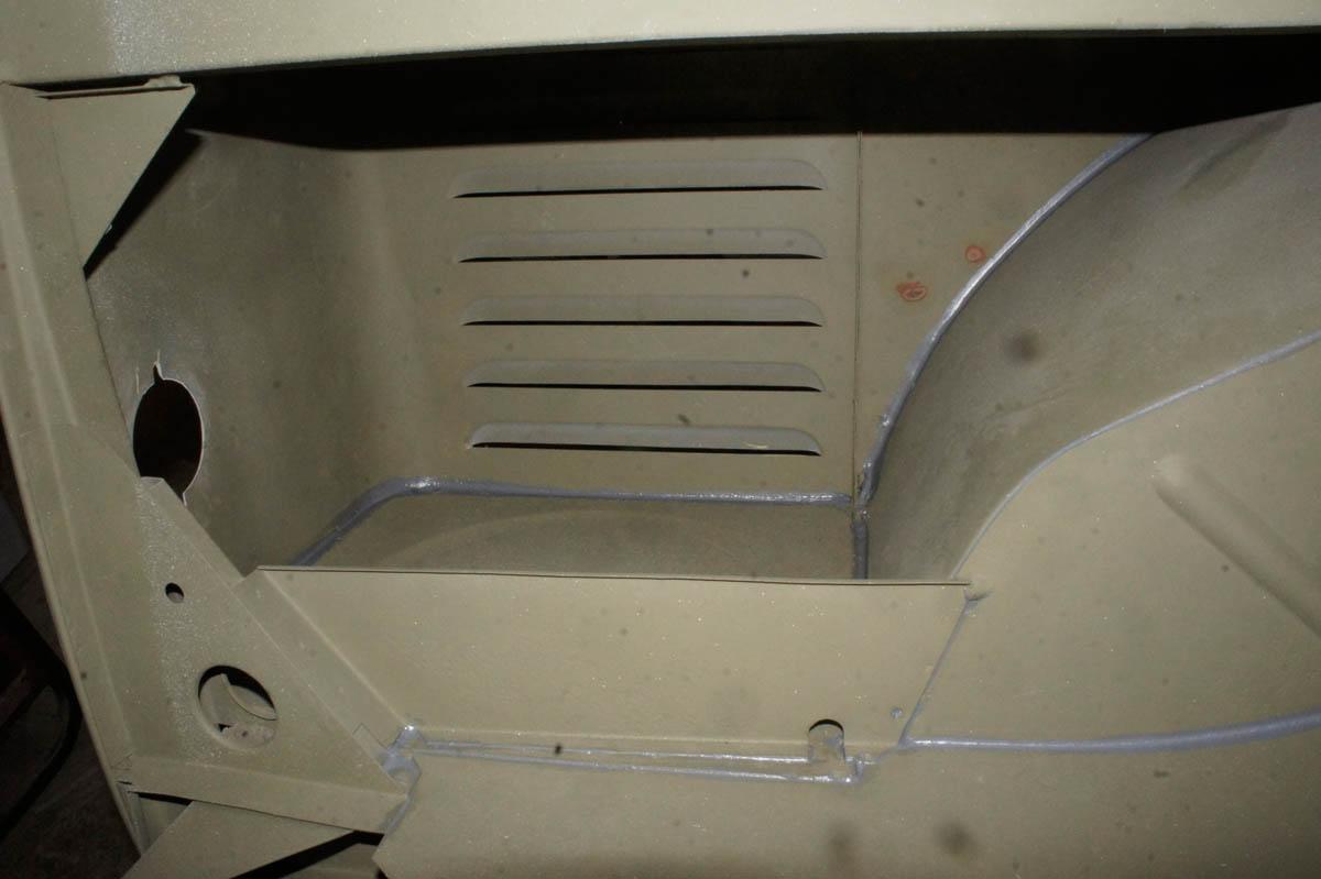

PostPosted: Sat Feb 21, 2015 11:49 pm    Post subject: Seam Sealer Reply with quote
Before I can apply any of this beautiful paint I have to do a lot of seam sealing.
This is a urethane seam sealer that comes in a "burrito" bag. It is intended to be used with a funnel taped on to one end like a pastry bag. I think I'll pass on that. I chose not to use one of those epoxy guns with a mixing tip because there is no room in my truck to use it and the tip is too large.
I was also looking for a way to dispense a small controlled amount instead of the usual smeary blobs that require masking on both sides of the seam. My woodworking shop is next door so I nabbed these.
This stuff is quite runny so it is easy to pour into the glue syringes.
The hole in the end is very small and the applicator is easy to maneuver in small spaces unlike a caulking gun.
I do not have to use 100s of feet of masking tape.

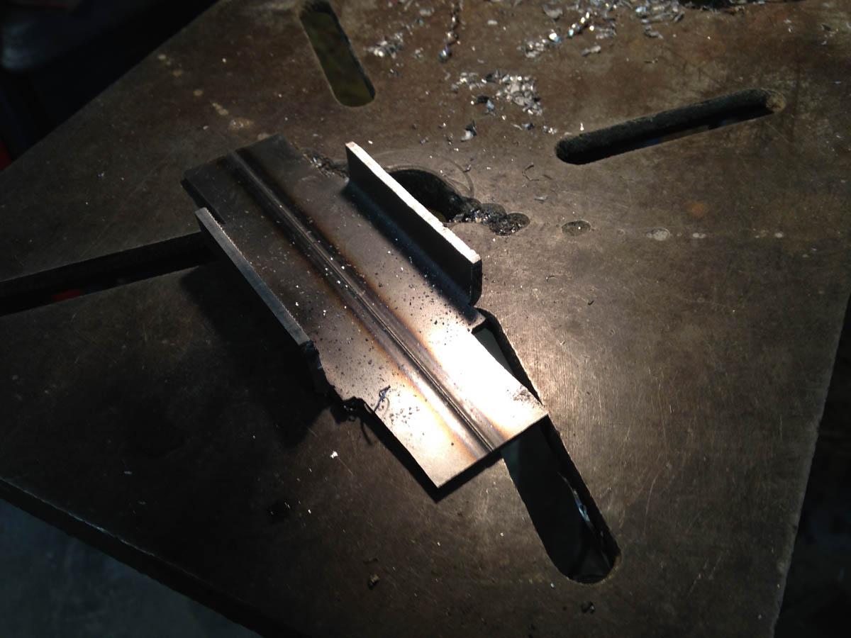

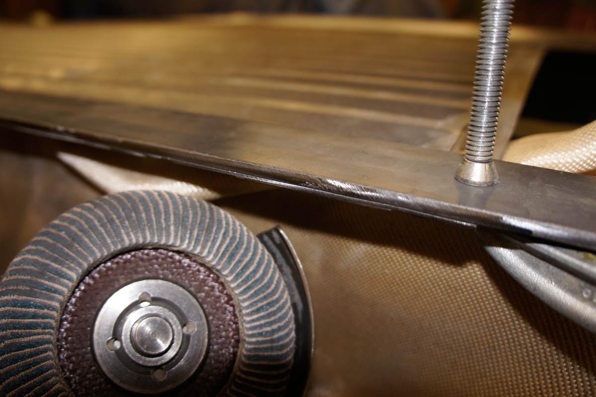

PostPosted: Sun Feb 22, 2015 7:01 pm    Post subject: Reply with quote

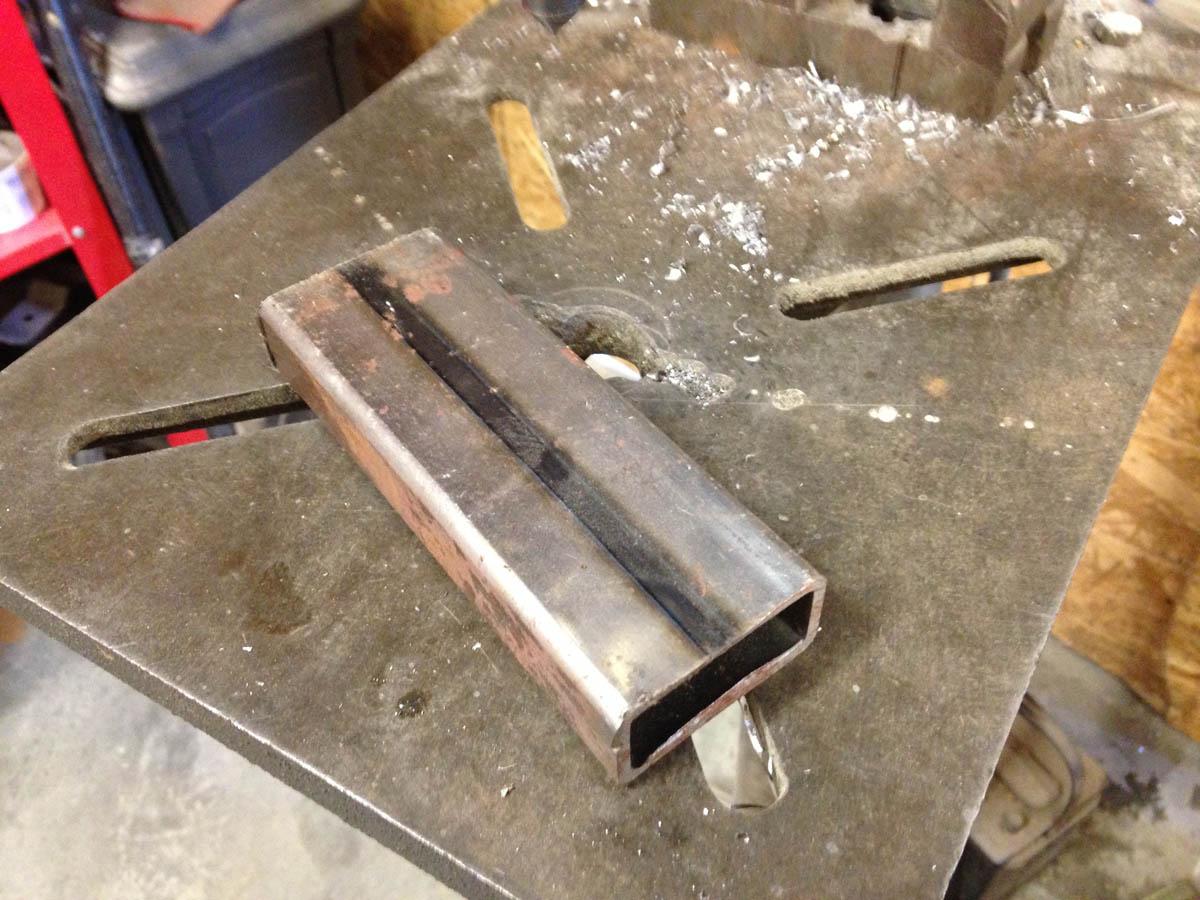

How do you trim a 2mm taper off of a 1mm thick sheet metal and keep a line perfectly straight?
I don't know but here is what I did. I clamp a 1/4" bar stock with one edge colored black with a sharpie. Grind until the black gets some scratches.
Sand with a flap disk until all of the black is gone.
File a radius on both sides.
Got all the plug weld holes drilled and the center seam has weld through primer. I am thinking I will weld the seam first before going on the truck.
Why file a radius? (begin rant) Paint does not adhere well to sharp corners. Sharp corners are easily abraded or bumped into by anything. When paint is chipped easily at sharp corners the rust will begin. A soft edge will last longer. (end of rant)
Now go file some VW parts!

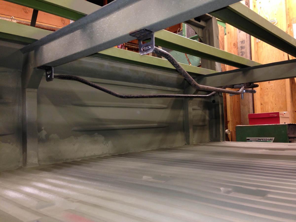

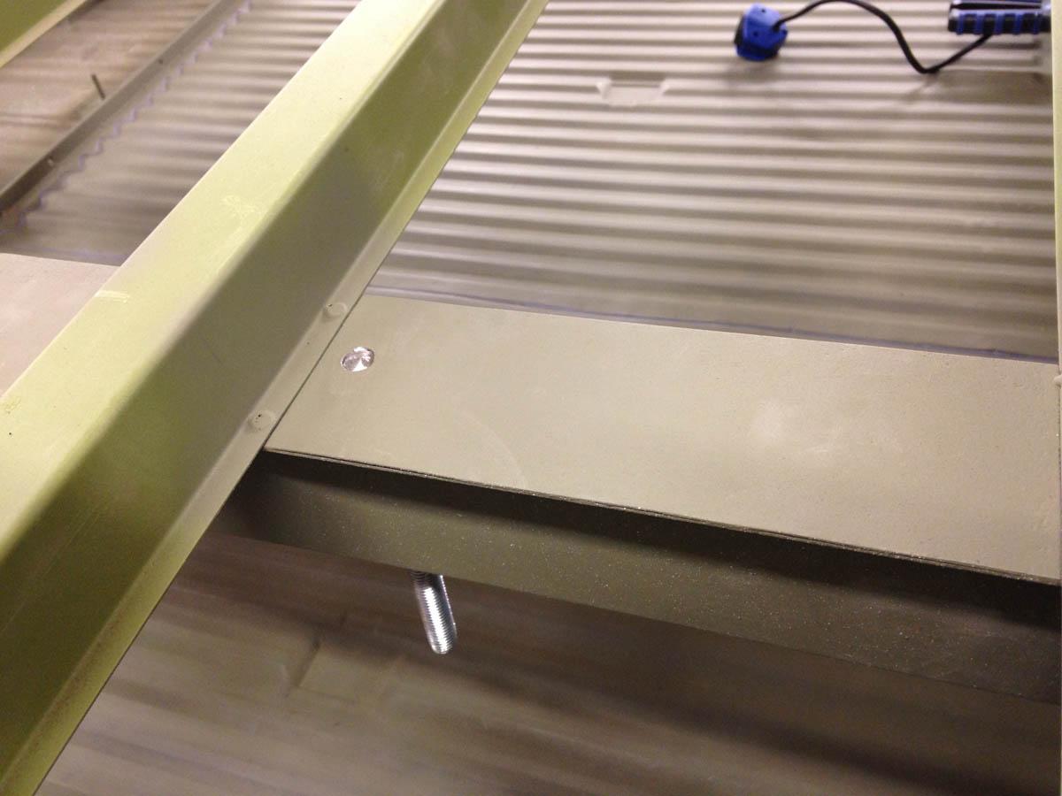

PostPosted: Tue Mar 03, 2015 11:44 pm    Post subject: Making a spare tire mount in treasure chest Reply with quote
Spare tire space behind the seat in a single cab is minimal. Modern radials do not fit without pushing my knees into the steering column. I am adding a treasure chest spare tire mount in my 1959. This feature was not standard until 1963. Others said they need to do this so I am including details.

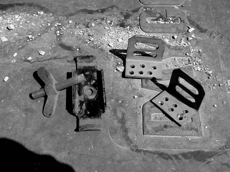

I stole this photo from the net. I need to make all of these parts:
I don't have a working milling machine so I cut the slots by drilling holes and grinding out the rest.
Now the holes for plug welding.
Now separated.
I love to grind! Don't you?
I am so glad I can weld this with the truck upside down.
Perhaps I should leave my plug welds not ground so future archeologists can see this was added to an early VW and not standard equipment?...
No

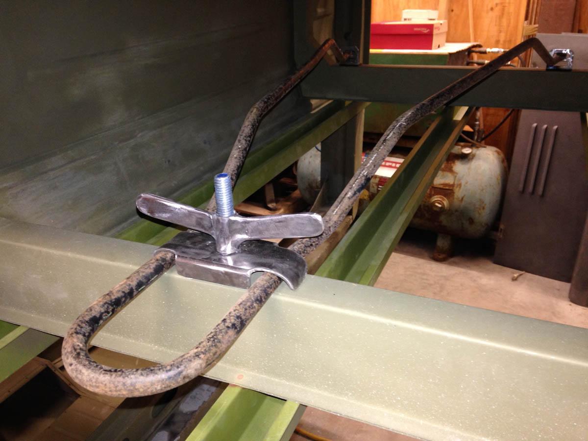

Now for the threaded rod. I don't know how VW did it as I have never taken one apart. I ran the threaded rod all the way through and welded to the top side for stiffness.
Now for the plate. Found some tubing.
Cut in half.
Cut some more.
Bend the ends in a vice.

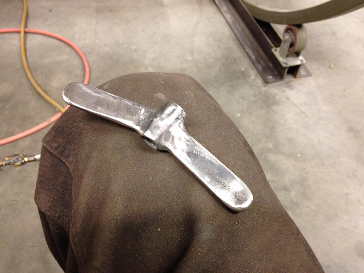

The giant wing nut was an experiment that worked out. Surprised me! Started with a large hex coupling nut and some bar stock.
Ground and sanded.
Good enough to hold up a spare tire.
I have been planning to do this upgrade to my truck for many, many years. This seemed like as good a time as any.
Now there is room behind my seat for that subwoofer!!!!!!!!

PostPosted: Wed Mar 04, 2015 10:18 am    Post subject: Re: Making a spare tire mount in treasure chest Reply with quote
Kurt
You win. Without a doubt, you win. Very well done. Applause

PostPosted: Wed Mar 04, 2015 10:52 am    Post subject: Reply with quote
Awesome fix, Kurt! I would suggest making a plate that goes the width of the top of the beam and weld thru to the threaded rod. This would spread out the weight some and help prevent the rod pulling through. Maybe not original, but that is a fair amount of weight on 1 square inch of 20 ga sheetmetal. You're work is a real inspiration, Thanks.
'72 Elm Green Deluxe
glideking
Joined: February 02, 2013
Posts: 990
Location: California
glideking is offline
PostPosted: Wed Mar 04, 2015 12:49 pm    Post subject: Reply with quote
"a plate that goes the width of the top of the beam and weld thru to the threaded rod."
That is a good idea. I will do that!
Kurt
