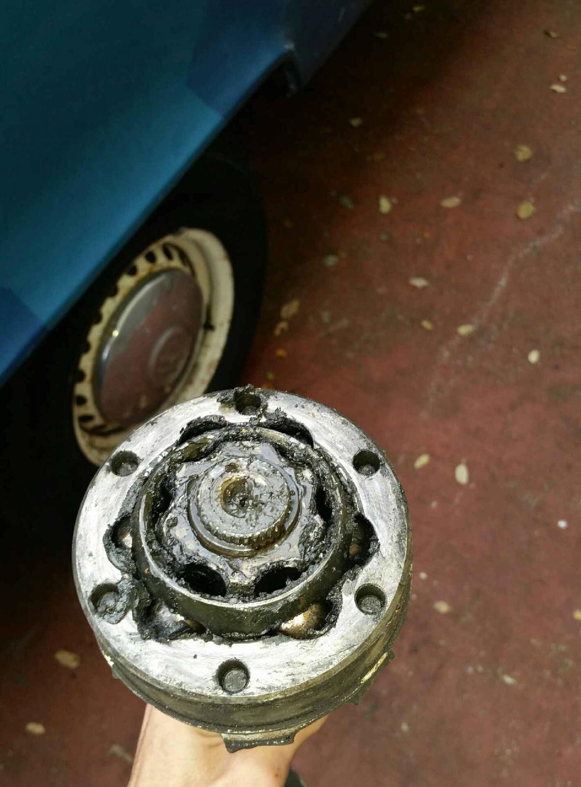

Well I did hear a "banging" when I first broke down on the side of the road, there was a loud knocking for a while before I heard a loud bang and then I realized I wasn't accelerating anymore.

Looks like yall saved me from spending way too much on having to buy a transmission or someone to come look at it. Here's what I found. If I am not mistaken this is a cv joint? The one on the drivers side looks busted and the passenger side looks to be in tack. Here's some pics. This is surely the problem correct? Shocked
the one on the passenger side is the last pic, seems fine compared to the driver side. So I guess the next step is to change it out? Is it fairly easy?

Cannot tell from the pictures. But The cage looks deformed.
Block the front wheels
Put it in first gear
Jack up that wheel and put a jack stand under the frame
Try and turn the wheel
If the wheel turns but the axle (shaft) stays stationary the cv joint is stripped.
That is your problem.
Good luck

I suppose it is bad then, the 6 ball bearings aren't there, it's really loose and I'm able to pull it almost all the way out. The bolts were on loose on the drivers side. The bolts connected to the transmission were fine though. I think I'm going to try and change it out right now. I found an old one that was taken out and seems to be good still. Is it as easy as unscrewing all 12 bolts and putting the new one on?

It looks like your one CV pulled apart. Is your bus raised above the stock factory height? If so you may need longer axle shafts and CV that are rated to work at steeper angles.
I would not install your spare CV without pulling it down, cleaning it fully, and checking it for excess wear. Several sites have good instructions on doing this. You may be able to even reuse the one you have now, but will have to find a replacement cage in good condition to do so. A thorough inspection of your present joint and axle would be in order no matter what.
The bolts for the CV joints need to be super tight in order to not give problems. I really recommend using the Vanagon torque spec of 33 ft*lbs as VW didn't raised the torque on almost identical parts when they build the Vanagon just for jollies, they recognized there was a problem with the bolts coming loose on Bay buses and fixed the problem by raising the torque spec.

So I got it on and it's running again. I cleaned them up and added grease as well. Also tightened them real good. So with that fixed, does anyone know what could be causing my vw bus to die out!? It'll start up and drive, but sometimes if I'm at a stop sign or start to slow down (lower than 10 mph) it'll feel like it wants to die out. To keep it running I have to push the gas or pump pedal sometimes!? Any ideas? It started to do this like 3 weeks ago, but ran great before that.

Did you use CV grease? Did you use new retaining bolts, the correct new washers, and torque them to the correct VW specs?
It appears the axle and CV joints you took off was a replacement. The flange on the boot cover doesn't look OG. It is also missing the moon plates.
The axle that you found in the shed appears to be OG, but some of the balls don't look shiny. This CV might have had problems, hence the replacement.
The shed axle has the moon plates and you will need to use them and new retaining bolts and the correct new washers on any installation. Is there a torn boot on the shed axle?
Your failure on the road was very possibly due to the incorrect replacement of the CV joint or boot. i.e. old or wrong washers, old bolts, no moon plates, incorrect torque. Doing it wrong again will result in another failure.
I would suggest a lot more book reading and searching on TheSamba to learn about care and maintenance for your VW and/or professional or VW experienced help and guidance.
