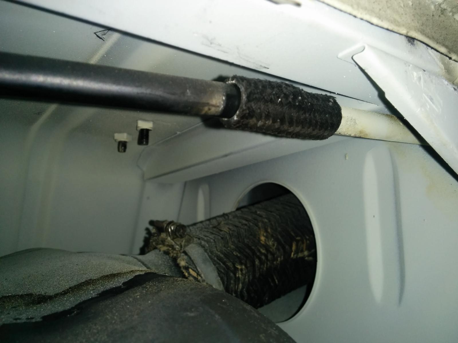

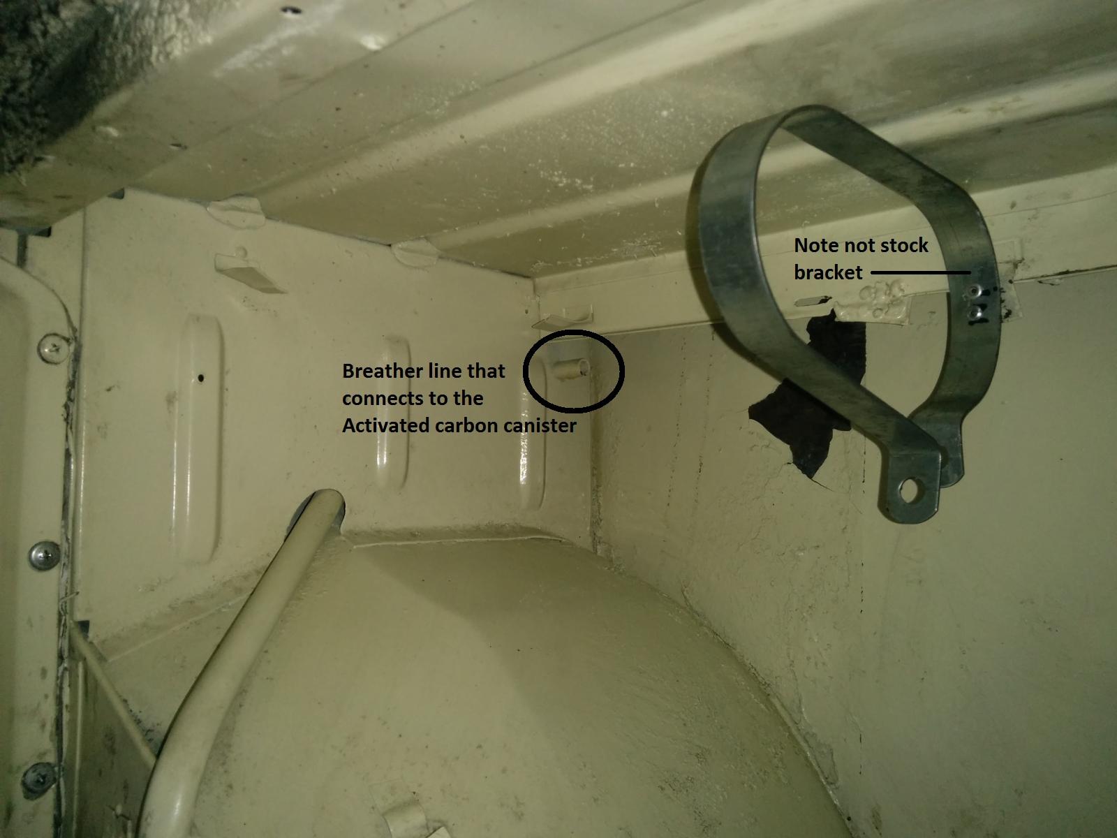

Carbon Canister Refresh - Howto
Note Fuel Vapor Route:
Starting at the center of the Fuel tank> short piece of hose> breather line (steel tubing) loops around> short piece of hose> breather line in firewall> short piece of hose> activated carbon canister.
Where the fuel vapor accumulates waiting to be purged when the engine is off.
Note Fuel Vapor Purge Route:
Starting at the Fan Housing> a length of hose connected to, the rear of the activated carbon canister (rear is always to the rear of the vehicle) the nipple closest to you> a length of hose from the front of the activated carbon canister to the side of the Air filter (not to the snorkel).
When the engine is started air pressure from the fan housing enters the rear of the activated carbon canister and exits out the front of the canister carrying fuel vapor with it to the side of the air filter. From there the air and fuel vapor make their way into the engine. Thus being burned through the combustion process rather than being released into the atmosphere.
For those interested in best fuel mileage practices. If your EVAP System is not hooked up your letting fuel mileage escape into the atmosphere.
